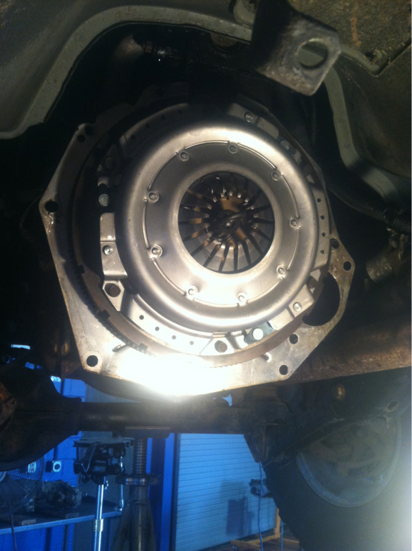

So I just put a new clutch set in my 98' TJ the other day, the only thing I didn't know was how to adjust the clutch pedal. Right now it feels real spongy and soft. I read somewhere you have to bleed either the master cylinder or the slave cylinder. Anybody want to shed some light and possibly help me out with this? Any help is welcomed. Thanks!
