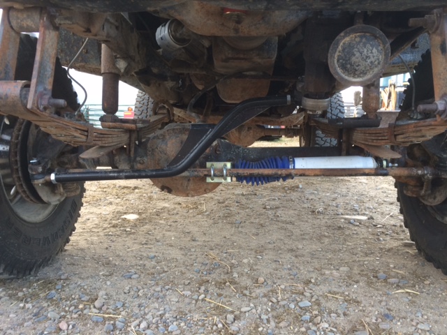

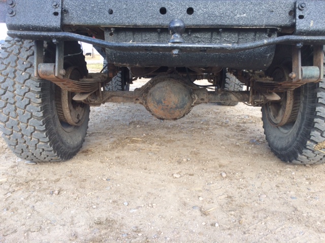

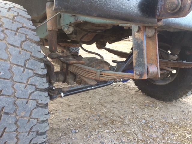

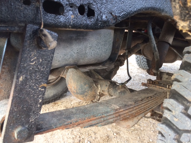

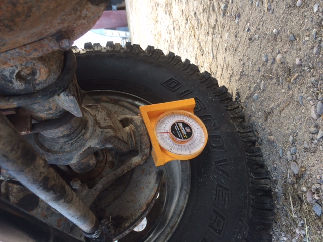

Im leaning towards agreeing with Eric M. If the motor mounts don't fix it, can you post a couple pics of your front suspension, from just below the bumper so we can get a good look.

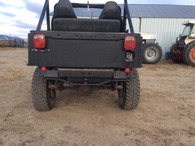

Pics

You are going to have steering issues because the rod from the steering gearbox to the passenger knuckle. As your suspension flexes, that bar is solid and the wheels have to turn since the bar doesn't move. If the suspension is stiff, then your rear axle is rolling. Fix that axle roll (axle wrap) and see if it helps.

Okay found frame repair on rear passenger side (rhino lining is not that cool) it's roughly above rear axle. The weld job/ repair job seems iffy. Could this be a reason for rise and fall upon ecelerating?

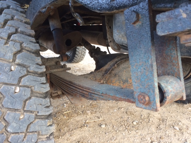

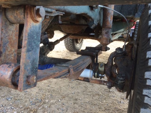

It appears to me this was a incorrectly done SOA. I think your front spring pads were welded on with the incorrect angle, In your last two pics it looks like the steering arms (what your tie rods bolt to) are tilted towards the ground, they should be more straight out. Straight out probably isn't going to be the correct angle you need, you will have to use a angle finder, I think the correct angle is somewhere around 5-7* but don't hold me to that. Something else I see, is it looks like your spring bushings are gone, this will contribute to your problem too. Another thing I see is your shackles, they are just two flat pieces of steel, there is no middle support helping to control lateral movement, a H type shackle would help a lot as would a steering box brace.

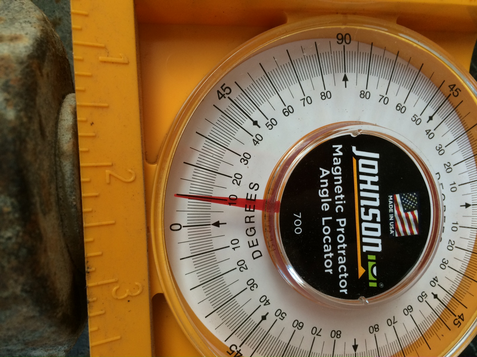

Based on your photos, I argee with 69jeepcj with regards to the front axle or really what we are getting at is your caster angle. One of your photos shows the angle meter at 10 degrees negitive caster (front axle rotated forward). You ideally want 5-8* positive caster (axle rotated the other way). But this does not explain the drivers front lifting under accelaration, negitive caster will give you horrible steering and a wandering effect at speed.

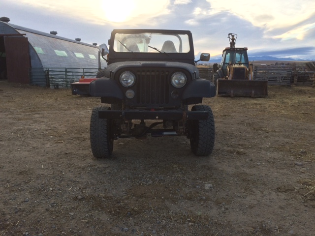

Your wheel hoop (for lack of better term) is likely a combination of everyones imput. My guess is, without driving your Jeep and seeing the flex, the high center of gravity caused by the SOA job is flexing the rear leaf spring and is leading to an uneven distribution (transfer) of weight. If it where me (and it is not), I would get rid of the SOA setup or at least have it corrected and upgraded my suspension to include the traction bars that "Bounty" mentioned.
