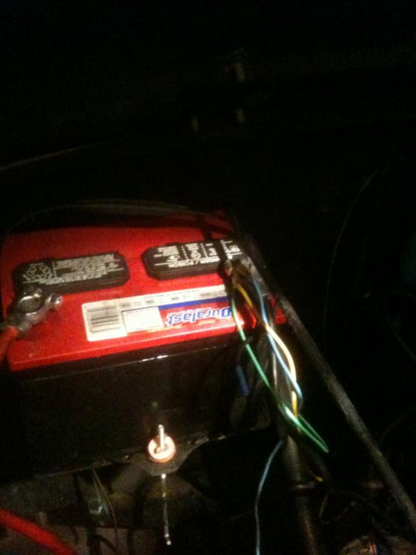

Here are some pix of what I have. Sorry my garage is kinda dark

Thanks! I'm stumped for now. All I oculd say is to watch your gauges and see if anything spikes or dies just before shutting down. I'm still guessing electrical. Possibly a short somewhere.
Buck Hour
While reviewing your images I realized you got a lot comming off that positive terminal. Is all that all ad on circuits? If so did you size the battery and alternator correctly? If you have a multi meter check the battery voltage when it will not start or when the engine dies.

The positive terminal on the solenoid?
you just helped me with something on my jeep, by posting your wiring pics. one thing on mine is not right, compared to yours so i am going to set it up like yours.

On the battery terminal. From theis pic.
Oh thats the negative all I have on it are the ground for the heater fan and grounds for the ignition. But I found the culprit! Turns out the solenoid advanced auto parts has listed for a 77 cj is the wrong part!! It has to be from a/c deco.
