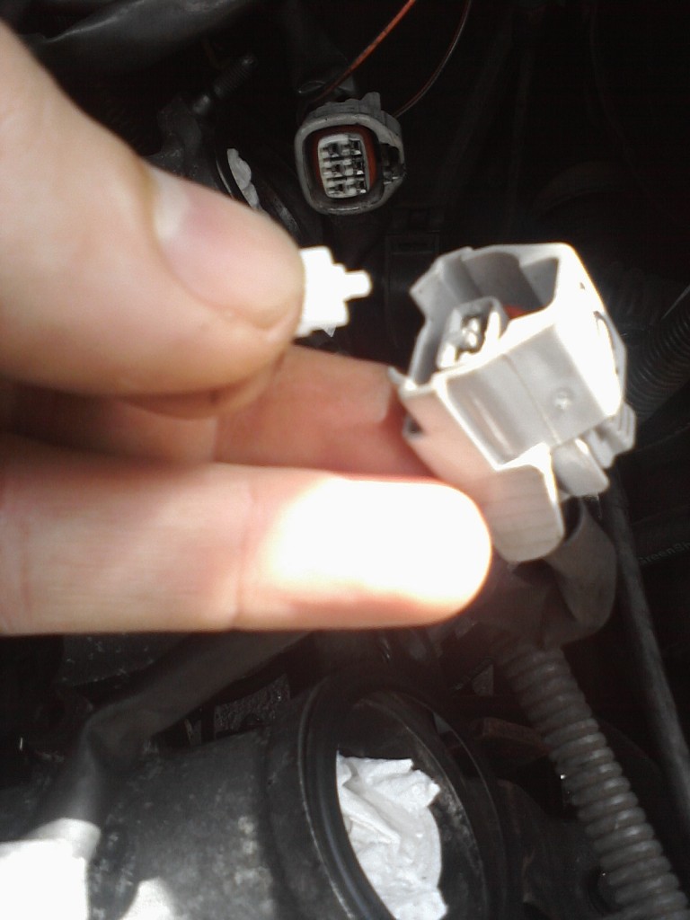

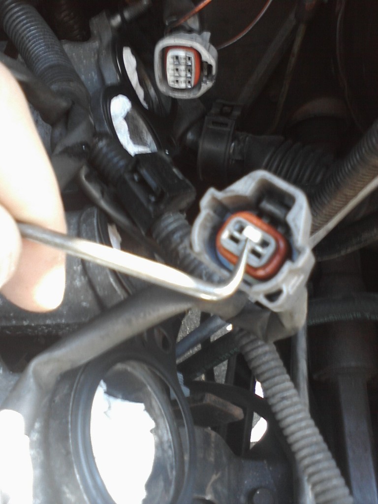

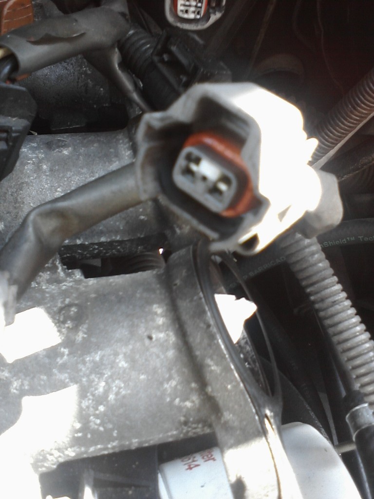

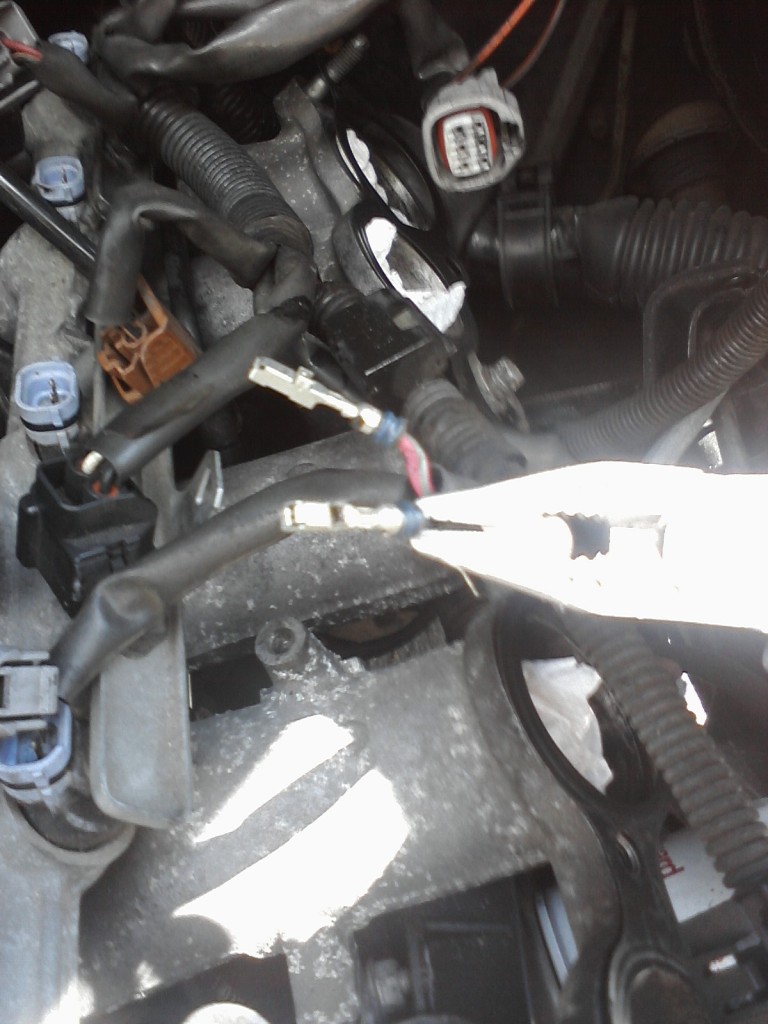

There is a new CEL letting me know it doesn't like the secondary speed sensor being gone. I'm going to try to just resistor it to the spec in the manual and see if that clears it. Might be different though. We'll see. Here in emissions counties in Texas I have to pass what is called a Readiness Test. It reads as follows:

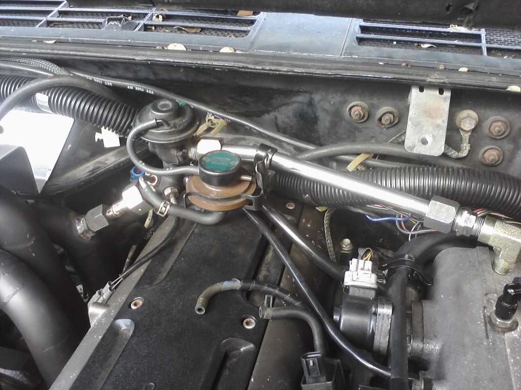

Catalyst status is not complete, meaning it probably just needs to be heat cycled properly by driving the vehicle. I assume this is calculated by the ecu based on O2 information and the CTS possibly.
Heated Catalyst Status I'm not 100% sure yet, but I may need to change my FG O2 sensor to a newer one from an OBDII car.
Evaporative Status will require me to install a vsv, vacuum hoses and route them to a charcoal canister according to the 2JZ manual.
Secondary Air Status and AC Status can stay that way and pass...so they will for now.
Oxygen Status and Oxygen Heater Status will likely be fine once I connect the tail pipe O2 sensor (Jeep one is already OBDII).

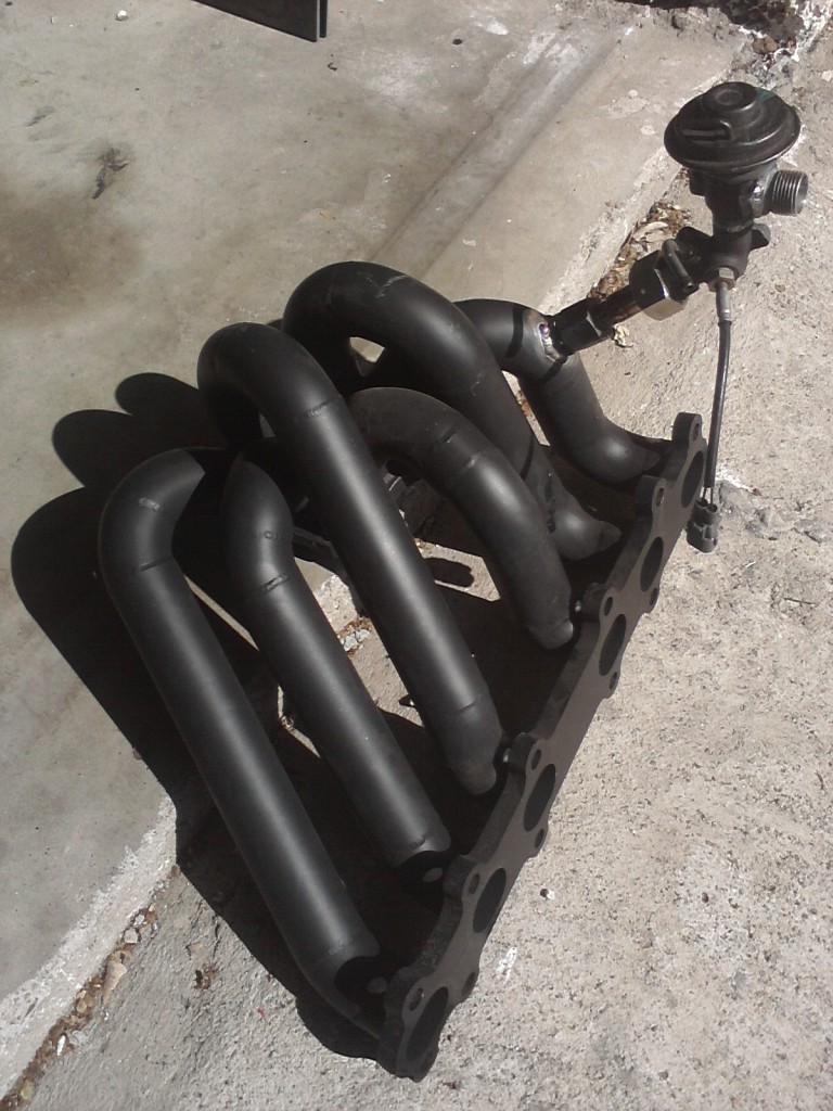

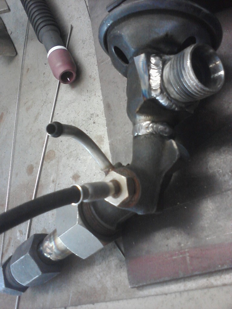

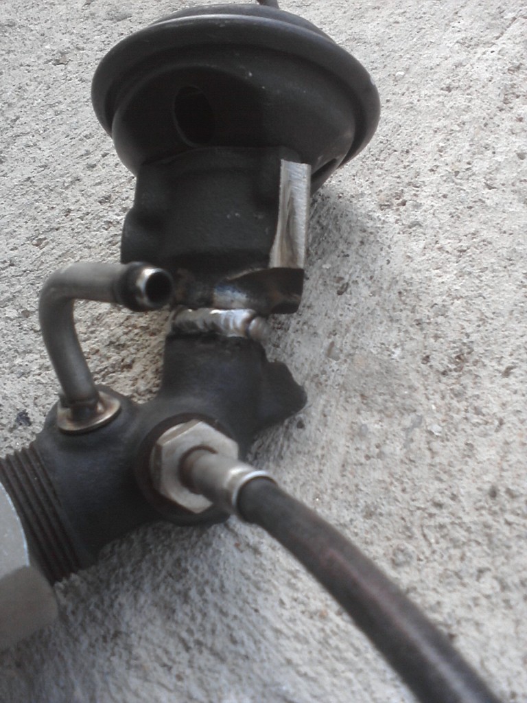

EGR Status will be corrected when I source the stock US Supra VSV for EGR, an EGR Vacuum Modulator, and an EGR valve. Then I have to install it all.
