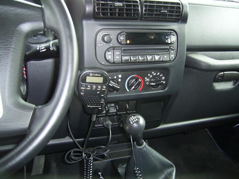

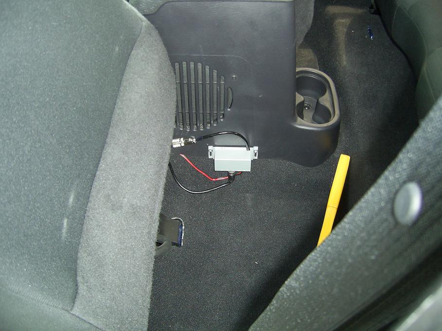

I just installed the Cobra 75WX-ST (the one with the display and all controls in the mic) in my TJ about 2 weeks ago. It installs very easily - comes with a small box. The box has a port where you plug in the coax from the antenna, a port to plug in the mic, and 2 wires (red and black). The red and black just ties into a 12v switched source and a ground, respectively.
If you have a TJ, just take out the 2 screws and pop off the panel on the dash below the steering wheel. You'll see a bundle of wires coming from the wheel/ignition area. Find the pink wire with a yellow stripe. Test it with a meter, but that should be what you're looking for (thanks to whoever passed that along when I asked the same question!).

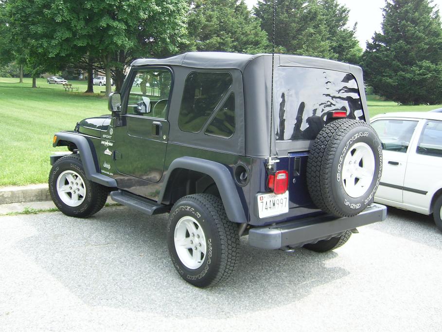

Then you just plug in the mic. I got a Terraflex antenna bracket that mounts behind the driver's taillight for like $20 from Quadratec. I found out later that the Terraflex bracket isnt that great because it is powdercoated so it doesnt provide a very good ground, so look for one that is stainless (they're easy to find). Anyway, just pop the back of the taillight lense off with a flathead screwdriver, then use a socket wrench to take the three screws out that hold the taillight on. Put the bracket behind the taillight, line up the holes and bolt it back on. There is a 4th hole above the taillight that you're supposed to drill through the body and use a 4th screw (included with the bracket) to mount the bracket to the body, but I didn't want to drill through the body so I skipped that step (no issues yet).
Now, just screw the antenna onto the antenna base (Radio Shack sells them for like $20 if you order just an antenna from Quadratec like I did and it turns out to be a replacement antenna with no base). Then you screw the base onto the bracket and plug the coax into the base. I ran the coax back through the hole where the wiring harness for the taillight comes through. There is a plug where the harness comes up by the rollbar in the back of the Jeep. I popped that plug out and cut a slit in it so I could fit the coax in with the harness and then popped the plug back into the hole. Then you just run the coax under the carpet (if you even have carpet) and plug it into the base.
I've included pictures of my install. BTW, I also got the Firefly antenna but I paid like $25 for it from Quadratec. I like it so far, seems to work well but I have no experience to with cbs to compare this setup to anything else. I just know it works (talked to a lot of truckers on my drive back to WV this past weekend :) ). Let me know if you have any questions.
