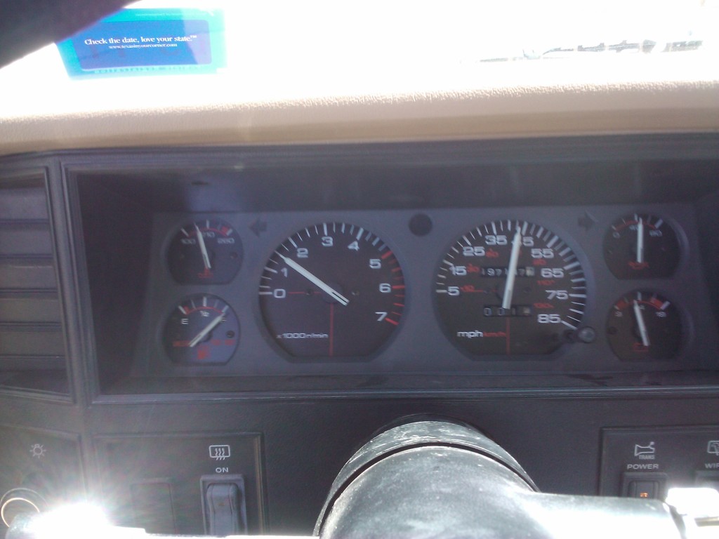

and everything works great (after swapping hte temp sensor and oil pressure sender to the ones for gauges, not lights )
only downfall is the odometer reads 64,400 miles more then my old one. i put a note on this cluster so it shows it was swapped out and hte miles and i also put a note in the owners manual in that little section about swapping the cluster so its noted if i ever sell this ol jeep.
