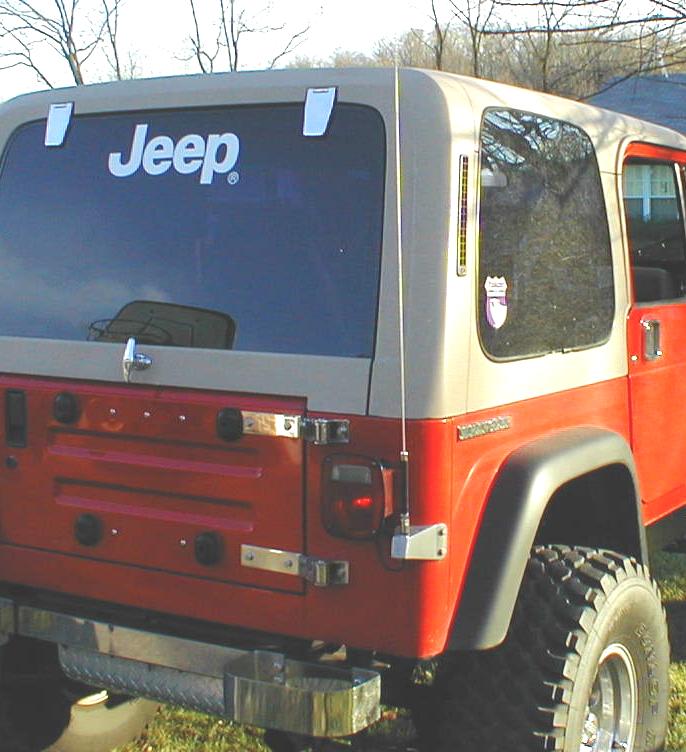

I have a simple whip CB antenna mounted on the spare tire stop. I cut a notch in the tail light housing. The cable runs up behind it. The antenna is a few inches taller than the hard top. I don't care how good the reception is. I only use the CB on the trail.
