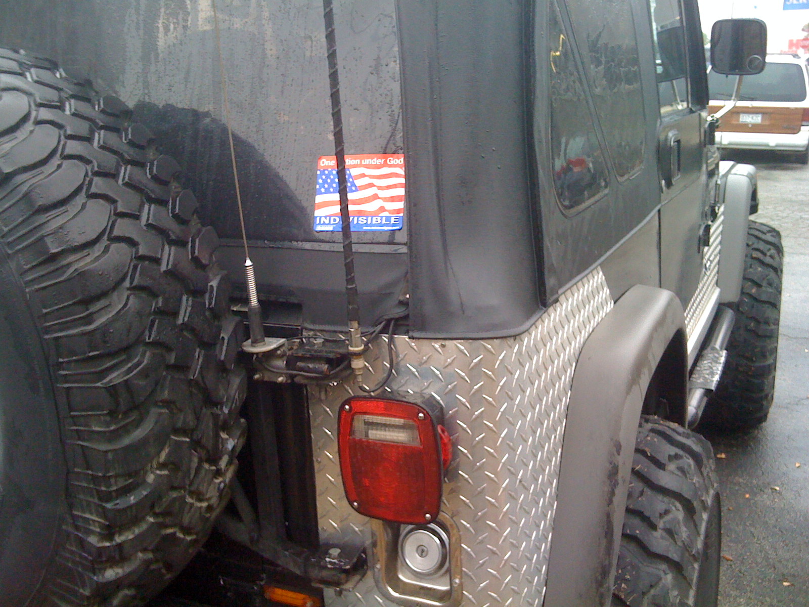

Just to clarify, I mounted mine in a rear-light mounting bracket. And the reasons I did not go the bumper route are that (a) I did not yet have my bumper when I did it, and (2), that having the antenna higher is more efficient (better range) than having it sit low...

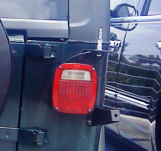

I did mine on the rear bump stop, if i can find out how to post pics ill show ya !!
At the bottom of the screen there are two buttons - "post quick reply" and "Go Advanced (upload photos). Just chose the second one, then scroll down to the bottom of that page, and hit the "upload pictures" button.
Thanks , so apparently im blind, didnt see that, heres the best pic i got, the stopper is easy to drill through, i first marked a spot, drilled a hole for the wire to come through right in the back of the stop under to top of it and screwed it all in...

That's an interesting idea... The only thing I like more about the stoplight mount is that you can use the same hole as the stoplight wires use. But this idea is very appealing (I would probably go this route if I had not already used the one I did). Here's a shot of my mount (with the quick detach off, as I ussually do not run with the antenna on to protect it)

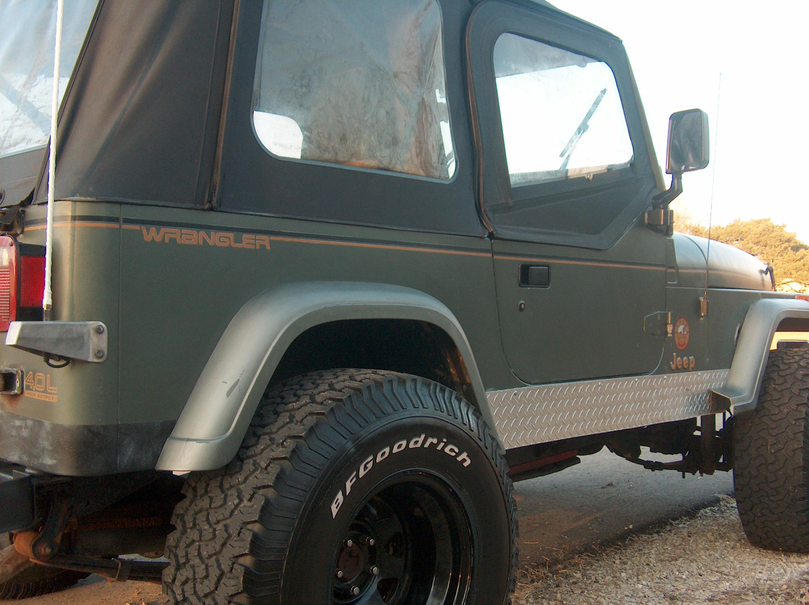

Here's where i mounted my antenna's.
