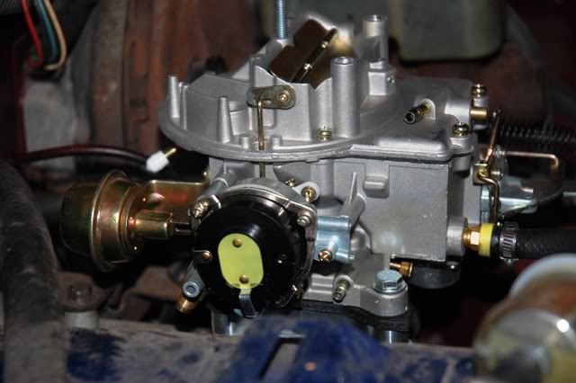

I have complete Motorcraft 2150 conversions. I have built and sold over 11,000 to replace Carters, Webbers and even Howell/Holley TBI setups. I have over 3500 in stock. Let me know if you want more info.
We hell I just bought a new webber and put it on wished I would of known about it earlier thanks anyway
I am the Ebay guy. 11,000+ kits sold for the 258. I have 3500 cores in stock.
