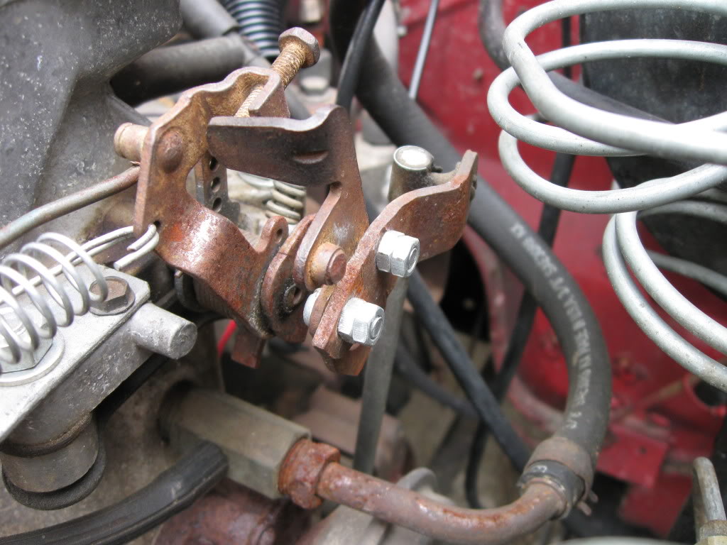

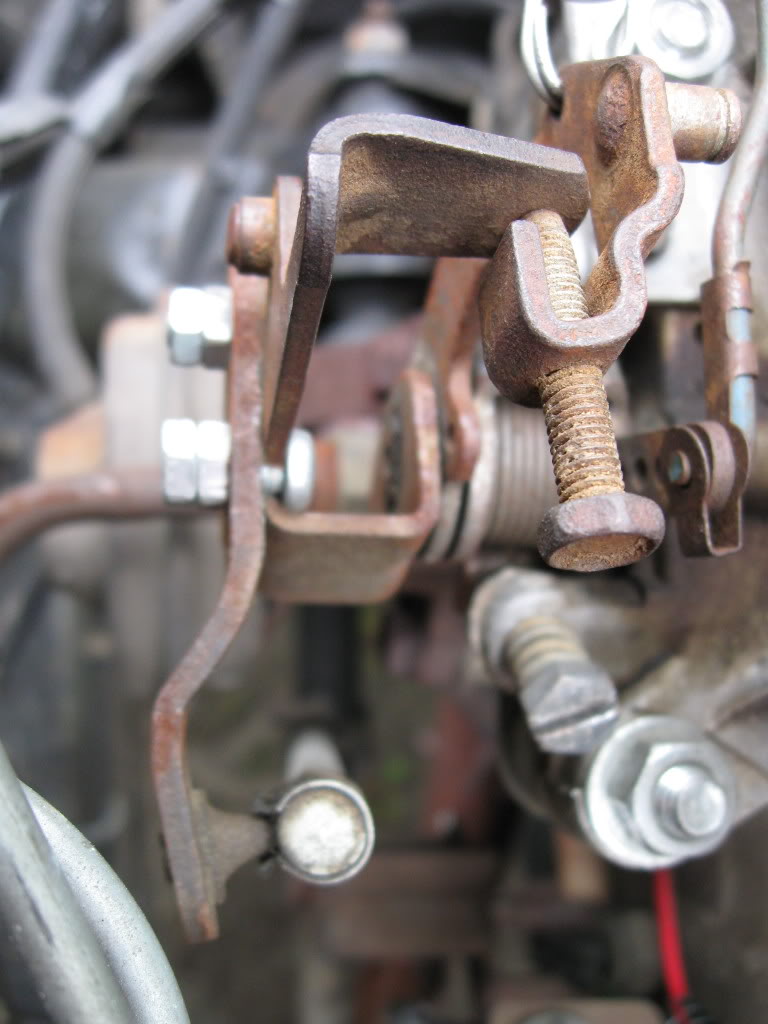

Best to do the "Nutter bypass" with this too.
This is a Picture Guide to Nutter Bypass - JeepForum.com
