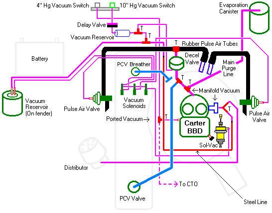

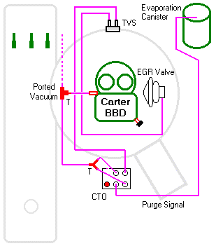

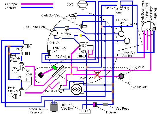

These should help with the routing of the vac hoses...
The one on the top left is the overall piccture of the system and its routing. The top right and bottom two pictures are of details of components of the system.

Sorry i forgot to put that in, but the oil was the 1st thing i checked and luckly no water. And 1000 thanks for the diagrams. Much, MUCH easier.
