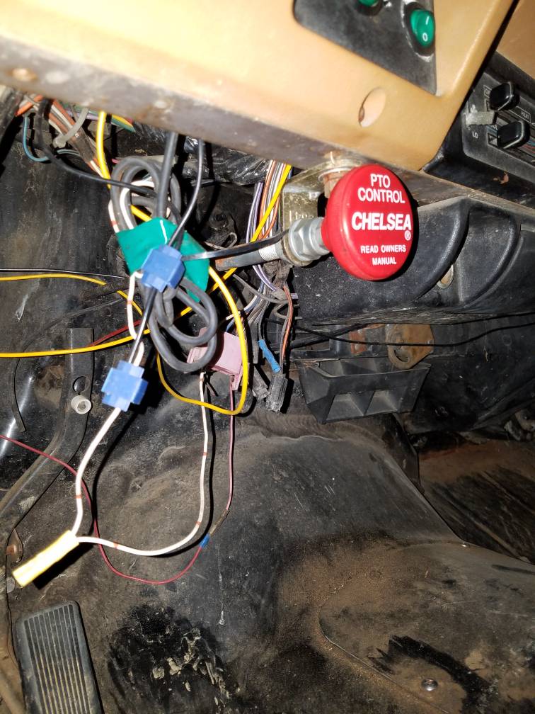

So I'm confused. I bought an 87 YJ from a guy in new Hampshire and it has a cable going from under the dash to where the vacuum pump for the 4wd is located. The knob to pull says PTO. Something tells me this jeep doesn't have a power take off lol. I'm changing axles on it and had to remove that whole assembly on the axle. My questions are what is that cable for and will I be able to replace the vacuum pump on my other axle with this? I'll post pictures in a few have to go tale them.

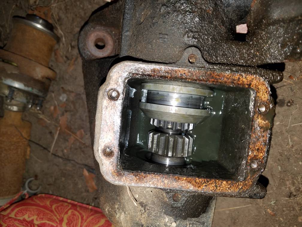

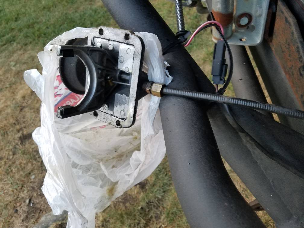

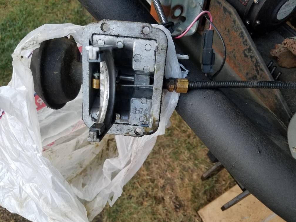

Here's the picture

Vac lines not operable now... it locks the two parts of the pass side shaft together via cable now. I dont understand the other axle question...your transfer case transfers power to both rears

I am doing am axle swap. I'm taking the axle off my 88 and transferring it over to my 87. Bc it has 4.10 gears and a spring over kit. I am wondering if I take that pump relay off with the cable mount directly to the other axle.
