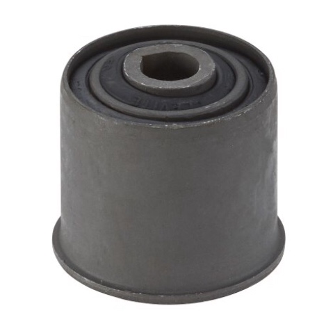

Terry I got rid of it with a new track bar bushing or full track-bar from Moog. See pic. Two layer of rubber and in bedded metal collar to reduce twisting motion. Larger bolt that tightly fits the collar and frame side mounting holes. And torquing that bolt down to spec insuring there is no movement.
