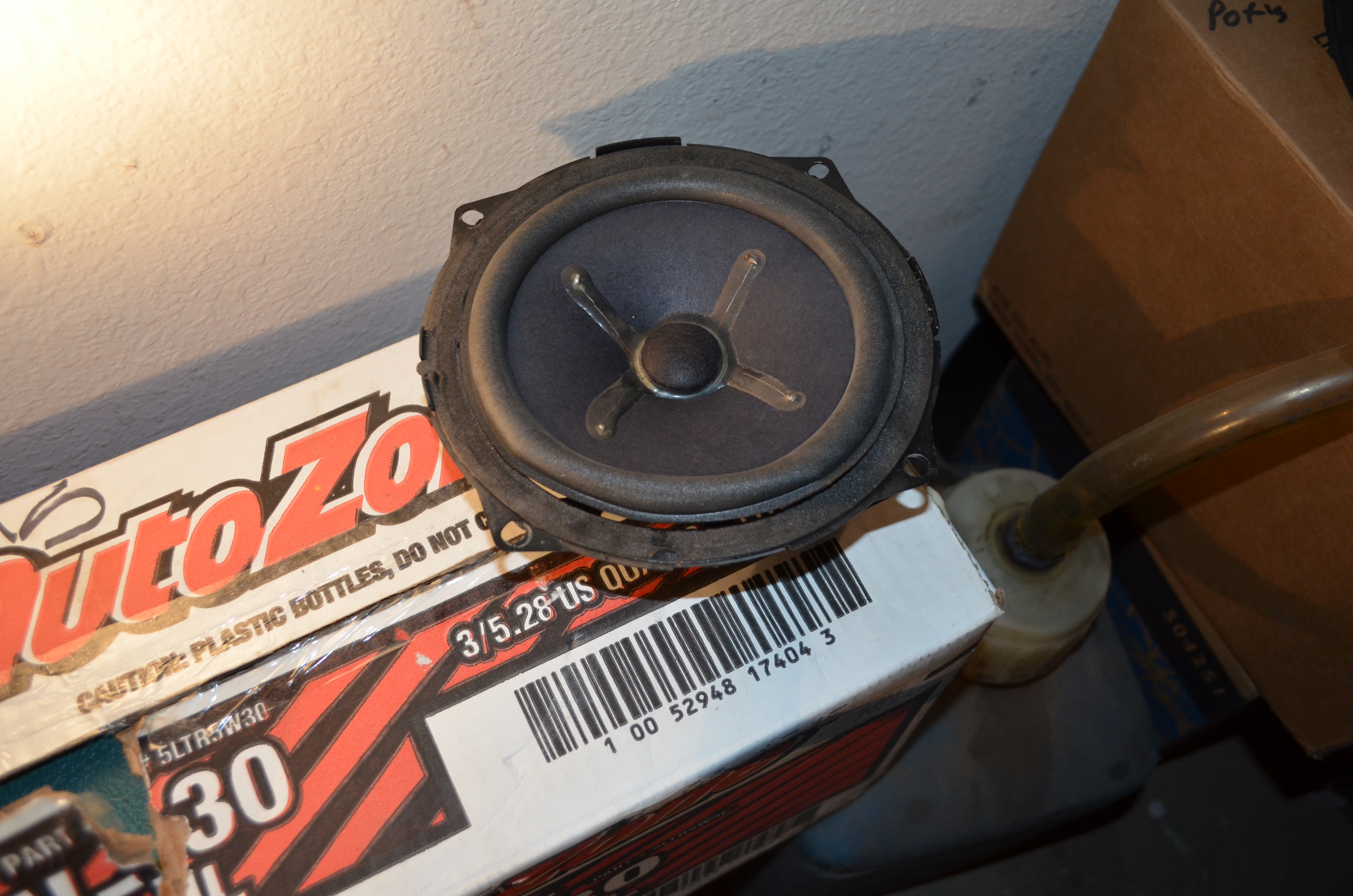

I have been following this thread with some interest, for a while now, because I recently blew my center sub and have been driving around with what I term the blubs. That annoying sound when the base hits and all you hear is blubbb blubbbb.
With little to no "wood working skills", and a machinist at heart( if its not with in +/- .005 its no good) I went to a local audio express to see what they can do for me. With a quote I traveled to other audio shops and got a gambit of responses from 'There is nothing I can do for you', 'close off the speaker area and consider it wasted space' to 'if your not willing to open the rear storage for my 2000$ speaker box and system your not worth talking to'.
Well with gents from audio express they told me I was never going to win a stereo competition with what they could do, it would sound 100% from what I had.
So I ordered a Skinny pedal amp mounting plate and let them replace my factory sub with a 6.5 kicker sub and a 125 watt amp. I have to say I will never win any 1st place prizes with this sub, but they were right. It kicks with a clear sound that is 100 times better then the old factory speaker.
