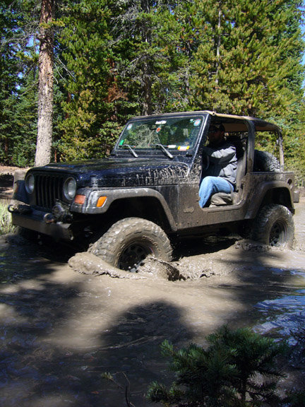

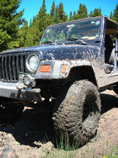

i have a bestop safari bikini top with the no drill header. works great. the header is 2 bolts where the oem softop hooks on. then the top slides right in. easier to install the top with 2 people.
