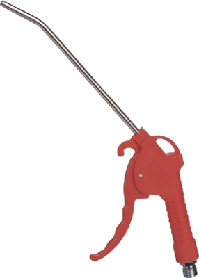

Here is what I do.. I get a clear hose from homedepot and snake it into the tank.
I get one of these
Obviously it is hooked up to my compressor.On the end of the hose that is going into the empty gas can, I put a small slit about 1/4" long along the length of the hose about 3/4 inch from the end. I put the end of the blowgun above into the slit and blow compressed air, it will create a vacuum and the fuel will come rushing out.
Good idea Johnny - I hadn't thought of that.
