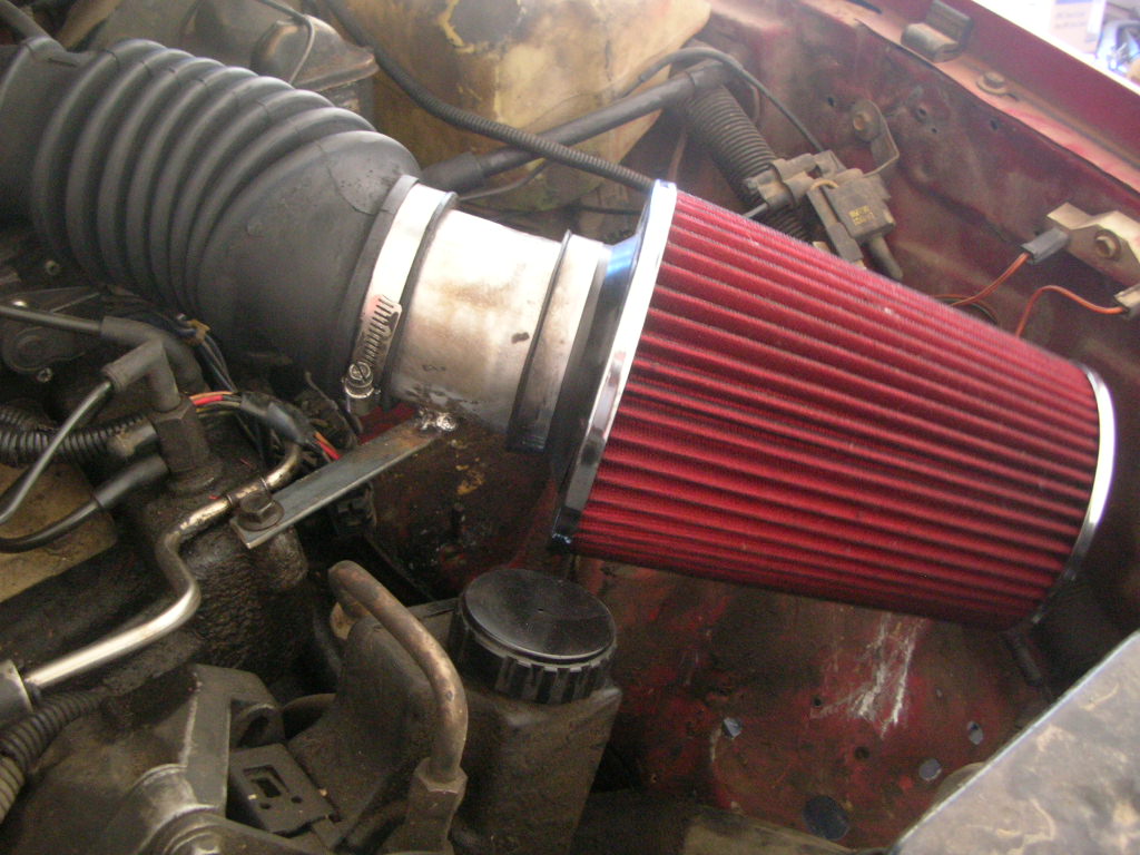

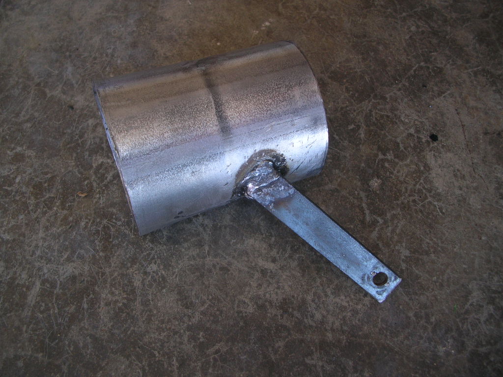

Made my own airtube setup today, almost the same as what Rusty sells.
It is amazing what some companies can sell when things are so easy to make
Looks great Bounty, I'm sure it works quite well
