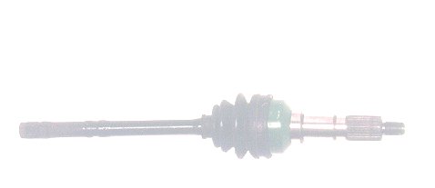

My jeep started makin some noises I took it in And it was my front cv. I also knew I needed both front bearings done and I need my ball joints done as well. All in all 1200 bucks :cry: .

It was the cv in my front drive shaft making the noise it was all normal wear and tear it has 110,000 miles and it sees itsa share of the mud. I took it to ntb to get the bearings done and they said they couldnt do them. So how was I going too.
the bearings are easy on a TJ take off the wheel and all brake components and the drive out the lugs, then remove the 3 bolts from behind the wheel bearing and then with a slide hammer with a bearing remover bolt it up and yank them off the new ones are easy to put in line up the holes and install the bolts from the old bearing and tighten them down evenly till the bearing is pulled into the knuckle, its a piece of cake it shoudl take u about 3 hours at the most to do both sides, the only tool that you probably dont have is the slide hammer and hub bearing atachment, thats about 40 bucks at autozone.

oh yea you also have to remove the giant nut holding the axle shaft onto the hub bearing its a 36 MM if i remember correctly from my bearings on my TJ, i would give u a hand but im in NY and ur in MD hehe but its easy u can do it
Don't use a slide hammer on the bearing assemblies, you'll pull them apart and ruin your trails spares. Back out the three bolts 1/4" on the back of the knuckle that hold the hub to the knuckle. Tap them with a center punch until the hub comes loose. Back the three bolts out another 1/4" and repeat until the hub comes off.
Bearing assemplies are about $125 each at the parts store, and front CV driveshafts on TJ's are easy to replace.
ok just for clarifacition (sp) this is a CV (or constant velocity) joint, it is a repezza (sp) type joint
this is a double cardan joint like i assume you are refering to on a driveshaft, that uses two u-joints on one end
I thought you may bring up that technicality, but for all general purposes the double-cardan shaft is very often referred to as the CV shaft, even though it's not proper. You are correct.
though.. a double-cardan IS a constant velocity joint... the two u joints do synchronize to create a constant combined velocity
