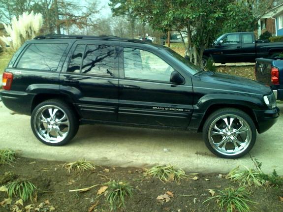

NOOOOOOO!!! Not My Jeep!!! Just makin' fun of big rims!!! Here's mine
