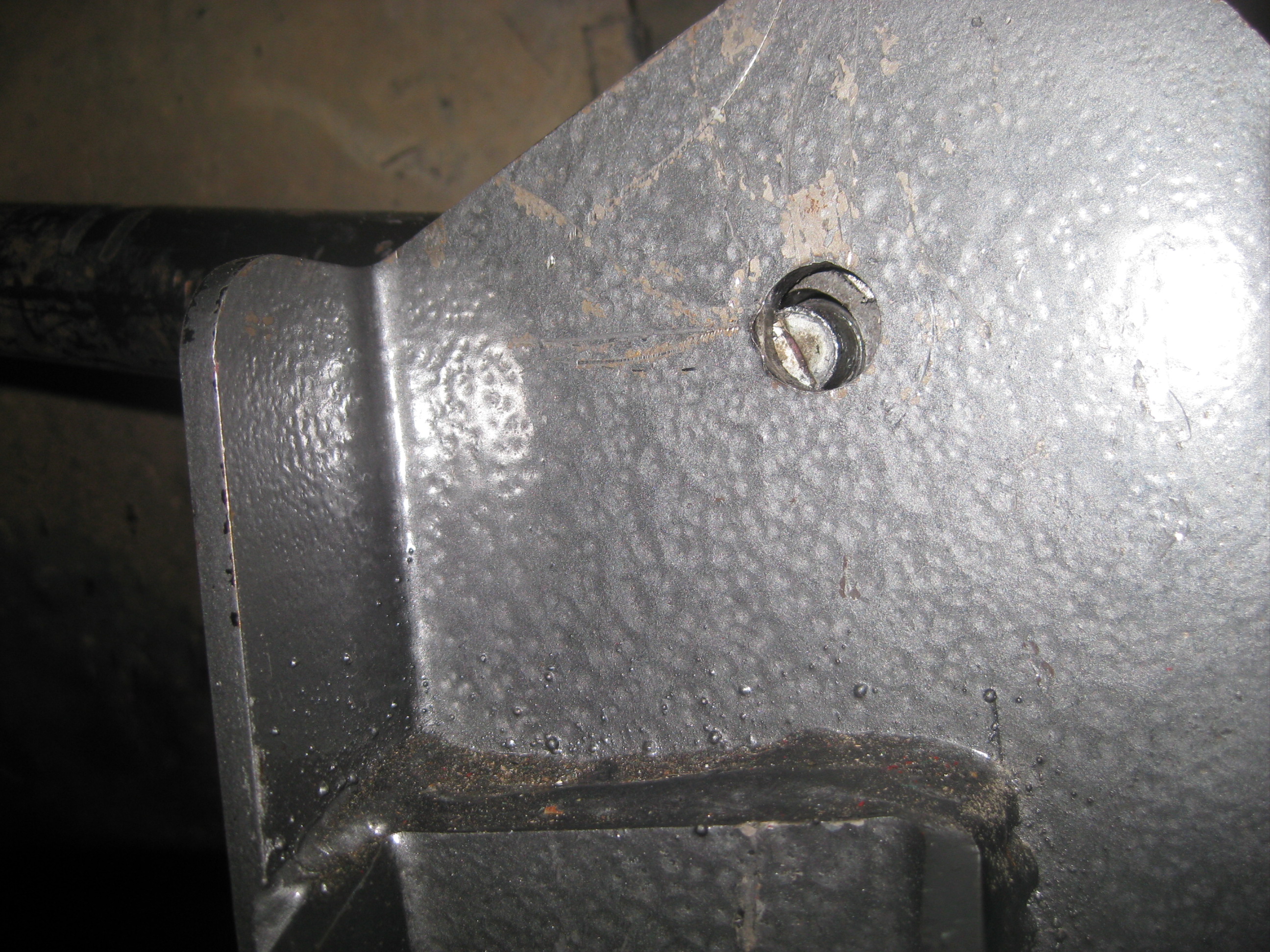

Jesse New member Dec 28, 2010 #1 I'm having a hard time with one bolt on my rear track bar. Does anyone have any suggestions on how to get it to line up? Is it easier to do a certain side first? Attachments IMG_0486.JPG 1.6 MB · Views: 127
carnuck New member Dec 28, 2010 #2 I use a comealong to the frame to pull the axle to come closer so they line up.
Jester32 New member Dec 28, 2010 #3 That works. Or if you have a couple of buddies around you can get them to push on the body while you put the bolt in. Ive done both ways.
superj Well-known member Dec 28, 2010 #4 i used a ratchet strap both times i put lifts on vehicles with trac bars
T TexasT New member Dec 28, 2010 #5 I used a ratchet strap too. The big yellow type truckers use. I also used the winch on my four wheeler once too.
