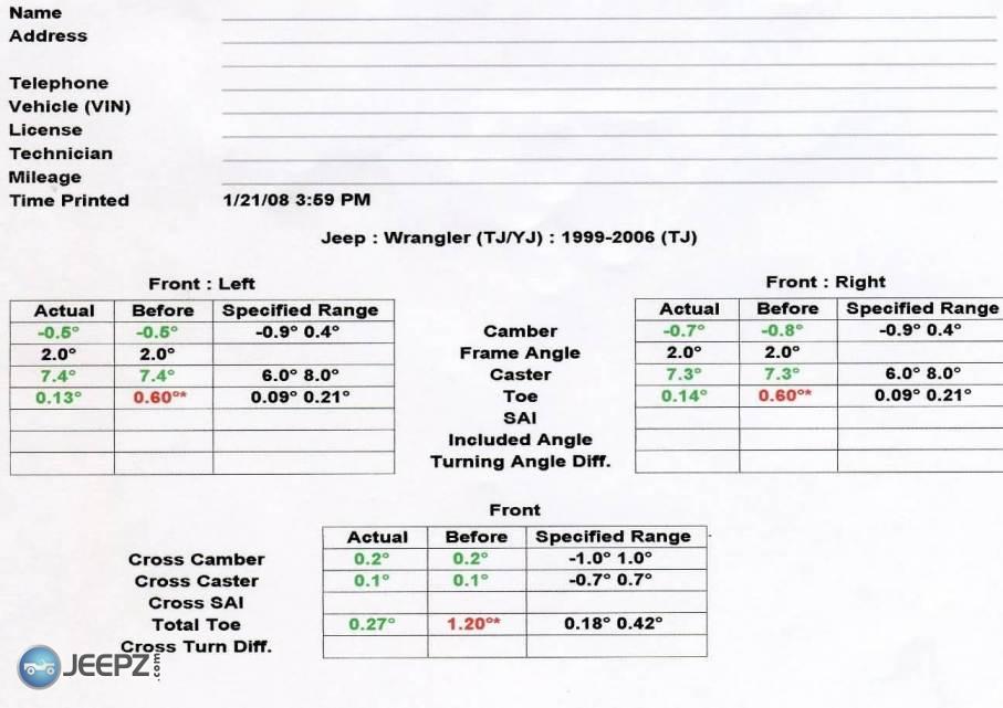

As to if you need an alignment, you probably do. Your toe will likely be way off. If you aren't getting a lifetime alignment then I'd wait and align it when all the final parts are in place.
Here's a printout after I added 2" spacers
