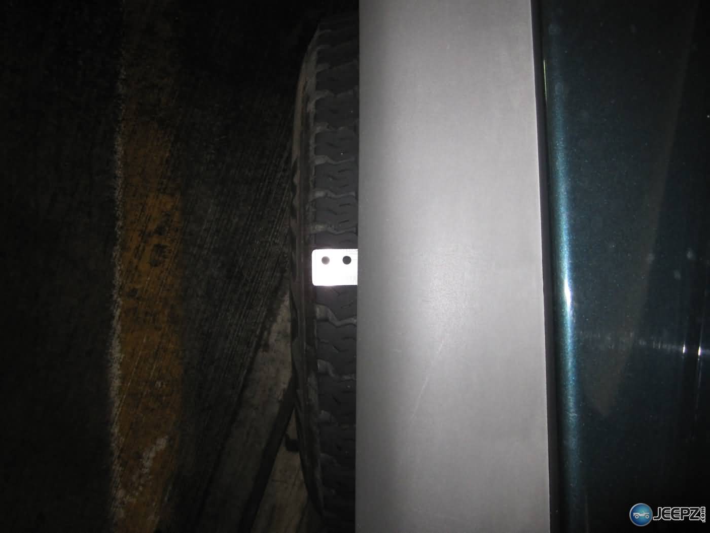

The easiest way to do this is to have your jeep on the ground, and install the new adjustable trackbar on one end (the frame end), and leave the axle end unhooked. The look at how far each tire is sticking out past the fender flare, like this:
If you need to move the axle one way or the other, you may be able to turn the steering wheel back and forth and "walk" the axle over. If not, you may need to use a comealong (I did this, and it was a pain), or jack it up, push the axle over, and lower the jeep again.
Anyway, once you get the axle centered, you adjust your trackbar to that length and install it.
