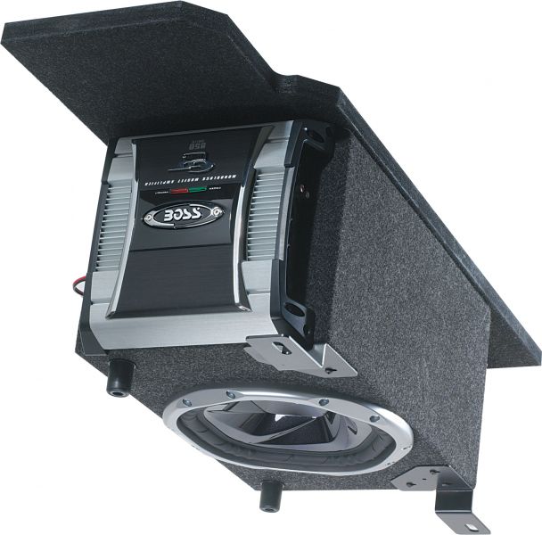

I've got a 2005 wrangler SE with a console that was added by the dealer. The console is not designed for a sub, but I'd like to add one. I've got the stock single disc CD player, and was wondering if a Jeep sub like the one in the photo below plug directly into existing wiring (meaning, they wire all wranglers for the sub, but only install it in the higher end ones)
What do you guys think, will I need to upgrade my head unit, or get some line level -> RCA converters for this to work?
If you want to add a sub. you will have to change your radio. I replaced my stock radio with an aftermarket, and I dont think the stock radio has RCA plugs in the back of it. I would tell you for sure, but I am at 'work' and my radio is at home.
It the sub is 8" in diameter or bigger, you will need to run an amp to push it, which will require the RCA's.
That photo is the stock Jeep sub, which has a 50 watt sub build in - it's supposed to go into the factory center console. I belive that you're right that the stock radio doesn't have rca pulgs, but I know that it has cd changer controls, etc - I wasn't sure if the stock sub used line level inputs, or some other magic.
Ultimately, I was hoping that all the wiring was already done for me, and I'd just have to plug in :rolleyes:

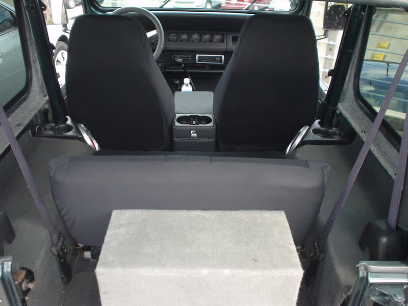

Here are some pics of my set-up to give you an idea of how everything is installed (I think I've posted these before, but anyway):

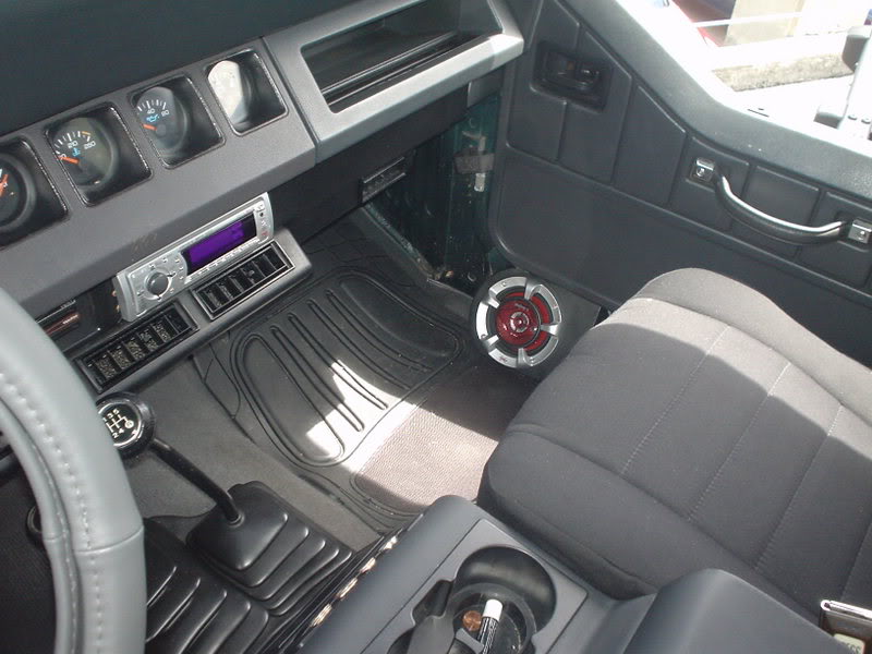

Main unit and kick panels under doors:
Sub unit and main unit:
Rear speakers:

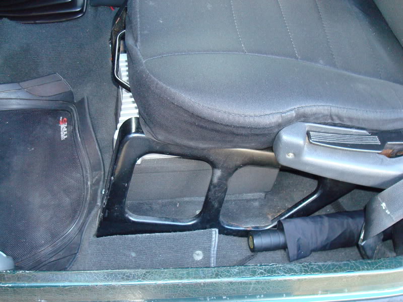

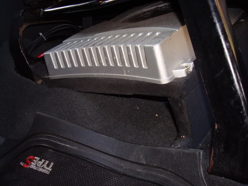

The amp/HD tunner setup is under the driver's side. I basically made a stand with playwood, covered it in black sumbrella (water proof fabric), and installed the amp on top (so head can escape easily) and HD tuner on the bottom so that both units are higher than the floor of the Jeep (in case I spill something or do something stupid like not taking the setup out and going through a river!).
Both the HD tunner and the are fed through an independent fuse that I can take out and disconnect electrical flow (so I can leave the cables in place when disconnected)

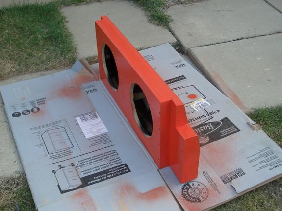

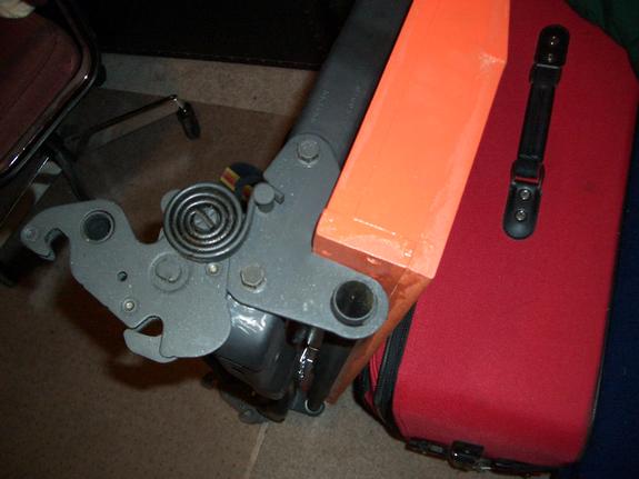

That sub above actually mounts inside the rear seat. You just pull the bottom cushion off, and rip a lot of the foam out, and install the box. The only downside that I can see is that your seat will end up being 50 - 80 lbs.
I may try to buy a used (and beat up) rear seat to install this on.
Hmm... Interesting approach. Then it sounds like a good option to do it like that. For the amp, what you can do is mount a piece of plywood to the seat rail (so that it moves forward and backwards with the seat), cover it in the same color fabric as the seat, and mount the amp upside down so that looking from the outside, it is as hidden as possible. This is not the way I have it (because it is harder to uninstall when I go offroading), but unless you see deep water, it should not be a problem (there should be plenty of space between the amp and the floor!). Also remember to run your amp line directly from the battery with an individual fuse set as close to the battery as possible...

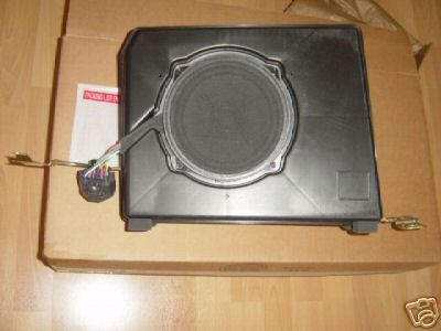

What about this? It's a little expensive, but a clean install and not that noticeable to would be theives. It's in the Quadratec Essentials catalog. As far as the stock sub goes it's what I have and it sound plenty loud enough for me. If I remember right it only uses two wires for power and plugs right into the original harness.

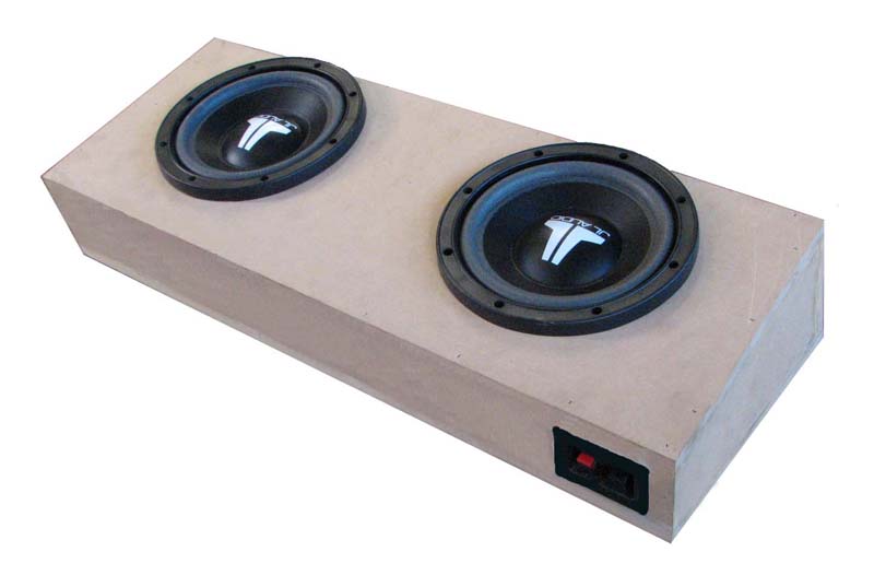

That's cool, but I'd hate to use up all my storage space. I've been thinking more and more about the under seat subs, and I think that's the way to go. Take a look at this site:
Jeep inside seat subwoofer

Finally got around to taking a pic of the amp assembly... Thought I'd share it with you. The HD radio is upside down beneith the amp on the rear of the plywood base.
This picture is taken from the door of the Jeep. You are looking at the driver's seat, and the amp is barely visible below it.
This one is taken from the pedals looking back. Here you can see the two screws that I take out to remove the entire assembly, one on the far side of the amp, and one on the bottom of the near side leg
