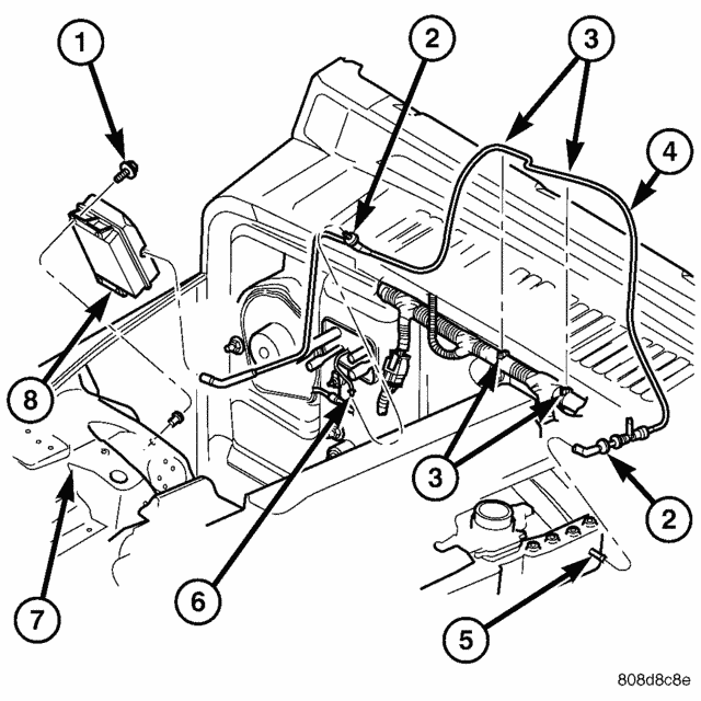

JPNinPA Well-known member Jun 14, 2016 #6 BobW said: Vac leak was the problem. The rubber tube that goes into the manifold was rotted away. I used a tie to clamp it down until a new one arrives. Click to expand... near #2 in the diagram? That one is often found disconnected. Check the rest of the lines for cracks.

B BobW New member Jun 15, 2016 #7 JPNinPA said: near #2 in the diagram? That one is often found disconnected. Check the rest of the lines for cracks. Click to expand... Yes, number 2.
