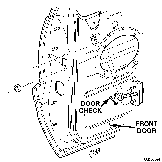

FRONT DOOR CHECK
REMOVAL
  1. Remove trim panel.
  2. Remove waterdam.
  3. Remove speaker.
  4. Remove screws attaching door check to A-pillar.
  5. Remove nuts attaching door check to door Door Check
  6. Remove door check through speaker location hole
INSTALLATION
  1. Position door check on door through speaker location hole.
  2. Install nuts attaching door check to door.
  3. Install screws attaching door check to A-pillar.
  4. Install speaker.
  5. Install waterdam.
  6. Install trim panel.
