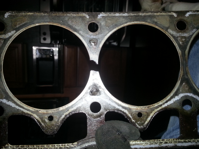

20140223_133843.jpgWell after about $300 and banging my head aginst the wall i think i have found my problem. For shits and giggles i popped the raidator cap off and started it up only to see bubbles. That told me it was either a blown head gasket or a cracked head. After ripping off the head the gasket was blown between #3 and #4 and thank god its not cracked or warped. That would explain why i have a missfire on #3 and #4. So i will be replacing the gasket sometime this week(lack of funds thanks to the duche bags at autozone for selling me shit i didnt need) and hopefully this will solve my problem and my wife will be happy to get her jeep back.
