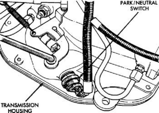

J jrodfox New member Apr 20, 2011 #1 Could anyone tell me where the nuetral safety switch is located on a tf999 transmission?
M mcmud New member Apr 20, 2011 #3 Well,... maybe this will be a bit more helpful. It will be found on the left side just over the case/pan seam, and then the switch contact would be made at the underside of the Starter (solenoid)relay. Attachments 42264873.jpg 42.8 KB · Views: 829
J jrodfox New member Apr 20, 2011 #4 Thanks for the help, the nss quit this weekend, so I just grounded the bottom post on the solenoid to get by until i could change it.
