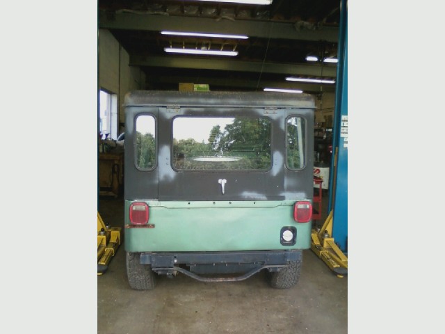

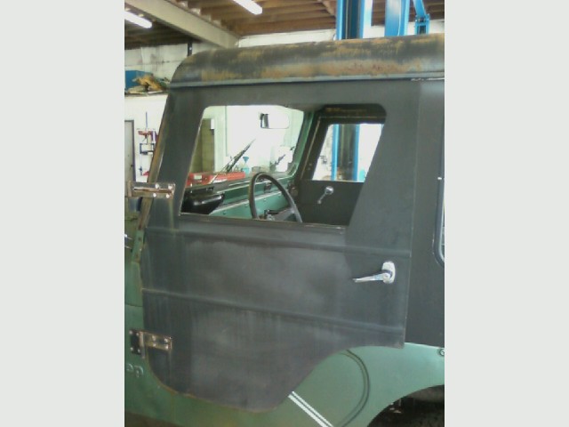

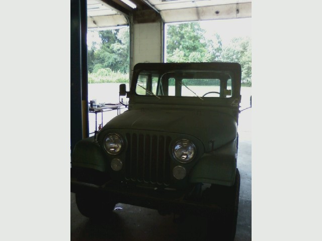

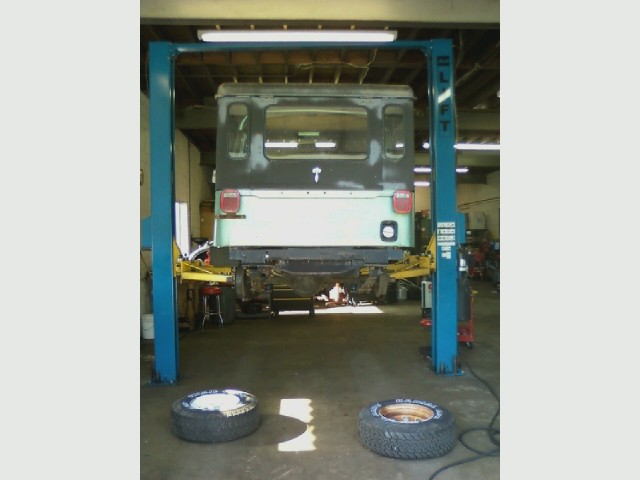

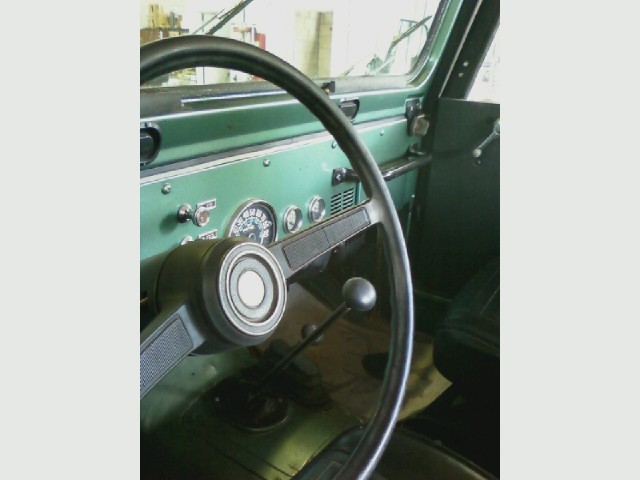

Well my question didn't get answered, but I figured I'd still put up a couple pictures of my recent acquisition. 1978 CJ5. I'm in project mode.

as for your fuel and temp gauges there are wires connected to the the back with 5/16 nuts they tend to come loose from how the harness hangs under the dash
another thing is that the ground could have came loose or your power connection at fuse panel is loose or a blown fuse , speedo cable could have came loose from back of speedometer or it may be a bad gear in trans where cable goes in
or just a bad or kinked cable altogether , also check the back of the speedometer itself is it all corroded or are any of the connections cracked ect

Bravo tripz, rally the '78's~! :D Great find with a hard top, difficult to find in my neck of the woods. When I acquired 'Black Betty' (also a '78) first thing I had to do was address grounding issues, despite there being very little rust, I had to take one of those toothbrush shaped wire brushes to the back of my dash where the speedomter mounts and everything started working.

[edit] Uploaded another picture of it up in the air with rear wheels/drums off.

Since it's on a rack, good opportunity to check body bolts, brake lines, underside motor, trans. & transfer case leaks, exhaust hangers, etc.
The exhaust hangers are literally hanger wire. Gonna have to fix that.
