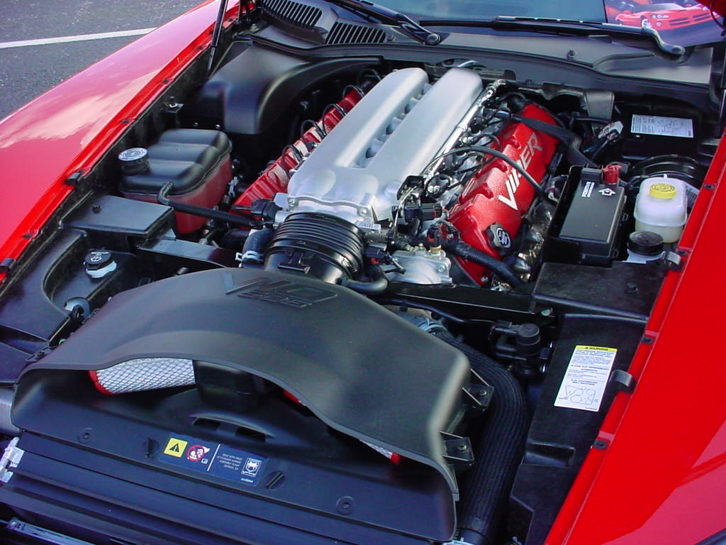

P.S. I actually do know what MOST of this is talking about, but I really menat more along the lines of, power to weight ratio, best for the price, gas mileage, ease of install...you know, laymen (a.k.a. dumby) stuff. :D
Adapters? Forget them and go with the entire drivetrain from a donor truck. Then you only have to pick up a motor mount setup from AA or Novak.
What about computer stuff, wiring, etc? are there alot of issues when it comes to things like, my Jeep not having abs, but the donor ecu came out of something that did? Or, say...airbags? Or are all those type of things controlled by other systems, not associated with the engine's computer?
You can use a generic pcm to fit your needs from the performance section of the manufacturer. For that matter, since it's a GM, There are a lot of outfits out there that caters to GM Performance from a Street Rod to an Alcohol Burning beast. Likewise on the Mopar side. They also offer a generic PCM for different applications. The only thing that i would advise you to stay away with when it comes to a transplant donor of a Powertrain is an MDS and Skim equipped 5.7 Hemi. Commonly found on the Durango's. It was a Temptation that i backed out of for $800.00 with 27,000 miles and it was a 4X4. After making a few phone calls, there was more issues with the MDS system than what it's worth.
Screw the Generic motors BS; What's wrong with a 318 (my preference) or a 360 Magnum??????? They put em in Grand Cherokees so it oughtta be easier to find swap parts; mounts and all; after all the same GCs were available with the same 4.0 as a Wrangler was, right?? yeah I know; 4.0 and 318 take a different trans; but so what; other than swapping sides on the starter for whatever reason, between the Dodge and Jeep versions of the same transmissions, there are plenty of Rams and Dakotas ripe for a swap!!

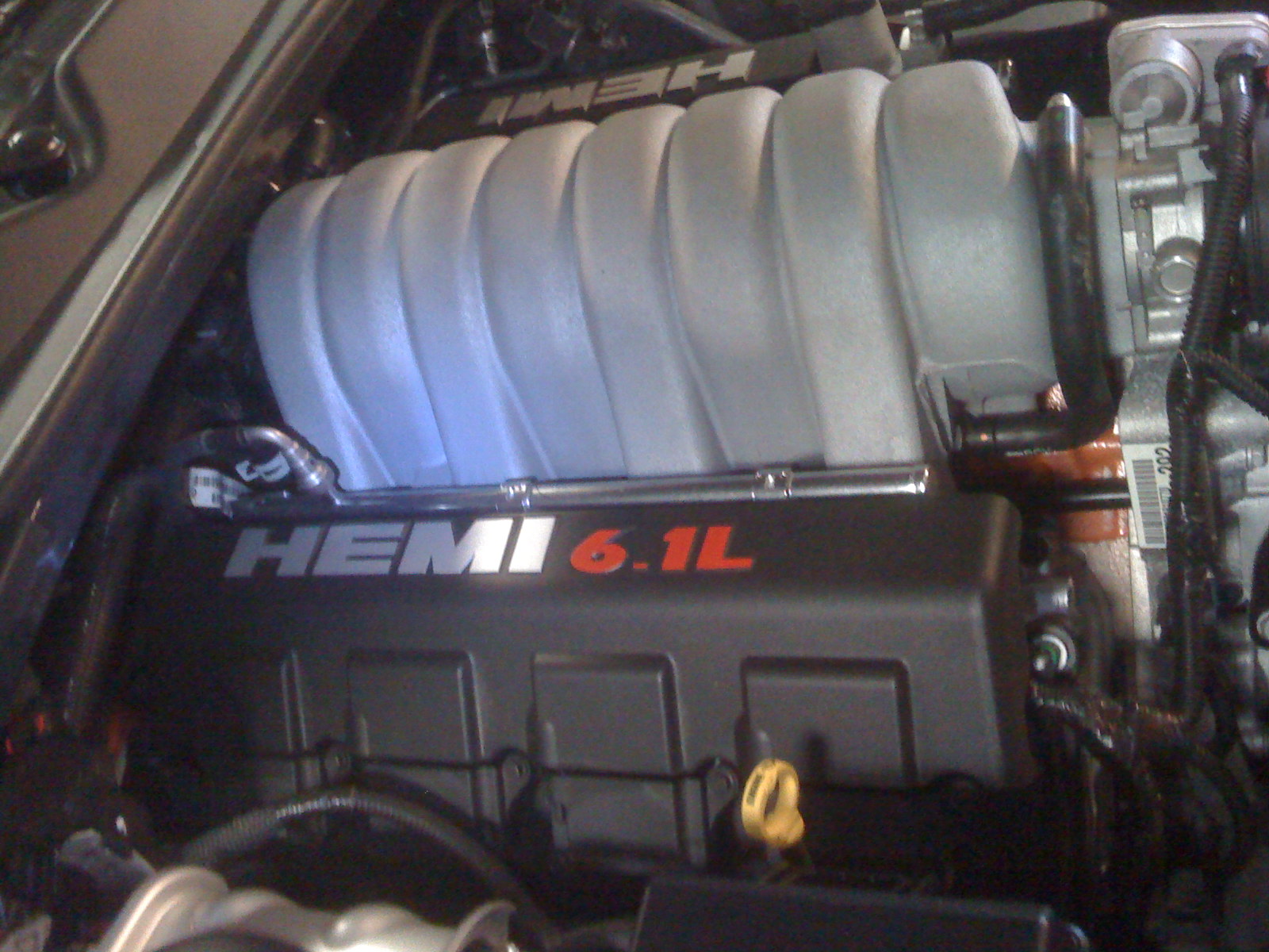

For more power and less cost than either the 6.1 or the Viper motors you could stuff this one under your hood
PLUS It uses a Carburetor so there is NO stupid ECM crap to deal with.
