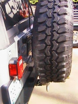

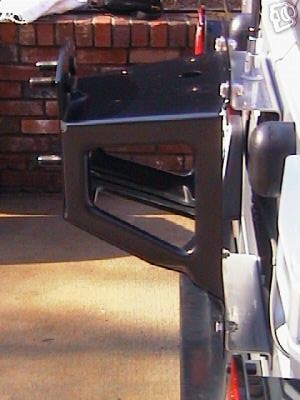

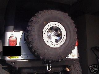

Hey, I recently bought a full size spare for my TJ... but I've got 33's. Here's what i did with mine and so far. After a few months of dragging the tire around with me i haven't had any problems with it. However, since my shocks are still stock from the stupid previous owner, and until I get them fixed, I rarely do any light wheelin, if at all, so the tire doesn't get jacked around too much. This is NOT a pic of my jeep, it came from ebay, where I got the brackets. I'll try and get some pics of it with my jeep for ya. And I hear ya about the prices for those bumper mounted ones...I would LOVE one, but on my current student budget, I definitely can NOT afford it haha. Sad Days but this works fine for me for the time being.;)

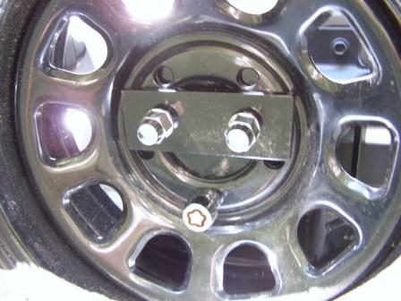

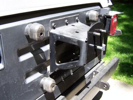

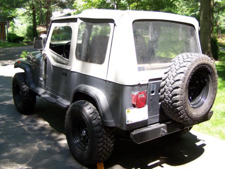

FYI, I did get the spare mounted on the stock mount. I had to shift the tire up about an inch on the mount to get it to clear the bumper, so i had to fabricate a bracket to make it work. It really was very simple (used some plate stock aluminum lying around the garage, drilled a couple holes and clamped the spare down). Also, becaue the backspacing is less on the rockcrawlers than the stock rims, i had to extend the rubber bumpers on the tailgate. I ended up using the ends of rubber mallets ($1.95 each at Wal Mart). Now the tire clamps down onto the rubber bumpers on the tailgate as the rim is tightened down onto the spare tire mount. I think this really adds stability and limits movement of the spare during driving (off roading).
I'll take a couple pictures later this week and share.
A good friend of mine runs a '94 YJ Sahara with 33's all around. He's been running around and doing some heavy wheeling down in Panama with the 33 X 12.5 BFG MT on the back for about 2 years now with no issue. The key is to make sure there is no play (meaning that the wheel is held tightly to the tailgate). If you achieve that (you will probably need to adjust the rubbers on the tailgate to achieve this as mentioned already) you should not have any problems. I am planning to put a 33" as well on my '94 YJ based on the fact that I have already seen it work.
Well, thanks to all that contributed! I have attached a few images in an attempt to illustrate what i ended up doing. A brief narrative was provided in my 5-21 post. Hopefully the pictures will clarify that explanation...

Looks good!! Just keep an eye on the hinges....I think you'll be fine - depending on what life deals out!!!:?| :?|
Happy trailin'!!!!
