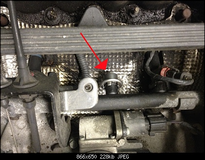

Will try..Took out newly installed TPS and found out I forgot the seal that goes with is. However it appears it was in right. Put new seal in when re-installing TPS. There really wasn't a need to turn clockwise. It slid right in flush mounted. like the original one I replaced. There is NO Schrader valve on my fuel rail.. just the little round attachment that helps regulate fuel pressure on the rail. TPS % reads 16.3 constant with new seal in. Still getting P0136 code which is the sensor I replaced with a Bosch. All my transmission codes are back P0743,P0753,P1765. Also still getting P1495, P0136 plus 14---ABS cluster malfunction.. WTF?
dlm ny country
the photo is not my fuel rail just showing the fuel rail round gizmo
Yeah none off that worked. For some reasonI'm getting a code 14 ABS cluster malfunction and my code reader won't let me clear it. Says module is busy. Recycled code reader a few time...?$?$?$?$?$
dlm ny country
The port usually is near the front 2nd cylinder pointed away from the engine.
