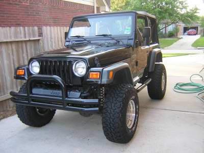

OK, so, for all that have gone before me..........what do I need next!!!!!!
2000 TJ Sport, 4" susp lift, 3" body, 35 x 12.5, soft top. Will be used 95% road, 5% off, maybe even more road than that.
What will make it look even better?
Thanks in advance, take care.
My TJ rides fine, I just wish I could loosen up my XJ a bit. I think I will give it more time since the lift has only been on it since Nov.

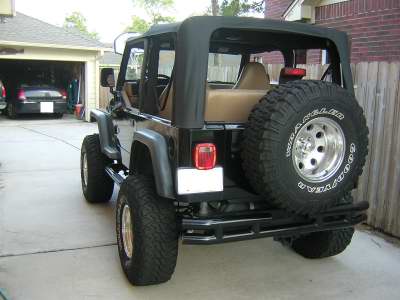

Here are two, front and back, although not a great.
Take care, and thanks for the ideas.
What do I do next???
