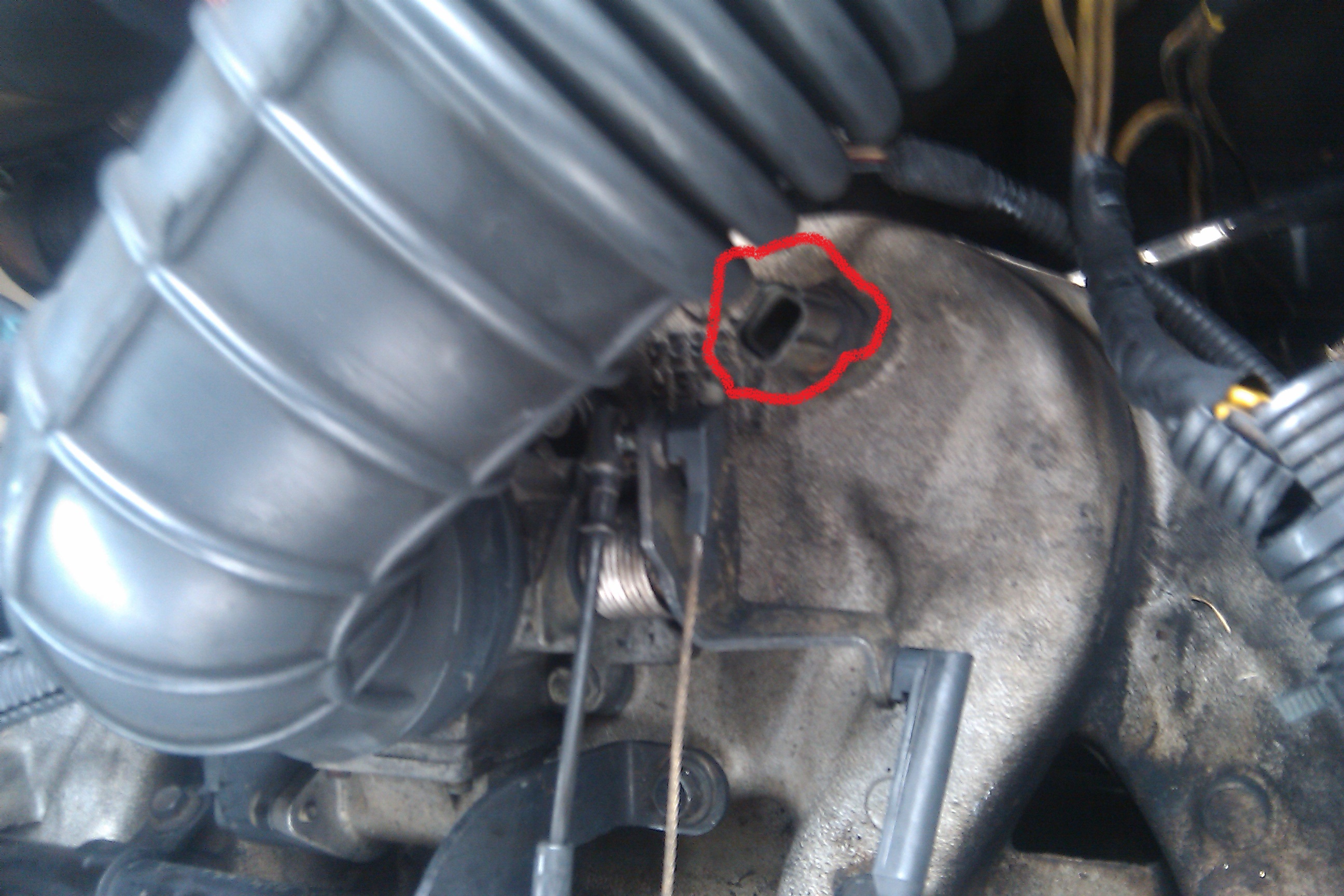

so here's a pic from the top of my intake. Is the circled item where the CPS attaches on top? please help me out!

Could be mass airflow sensor my toyota woudnt start after an engine swap until I remembered to plug it in if the computer desent register any air it won't give the engine any fuel

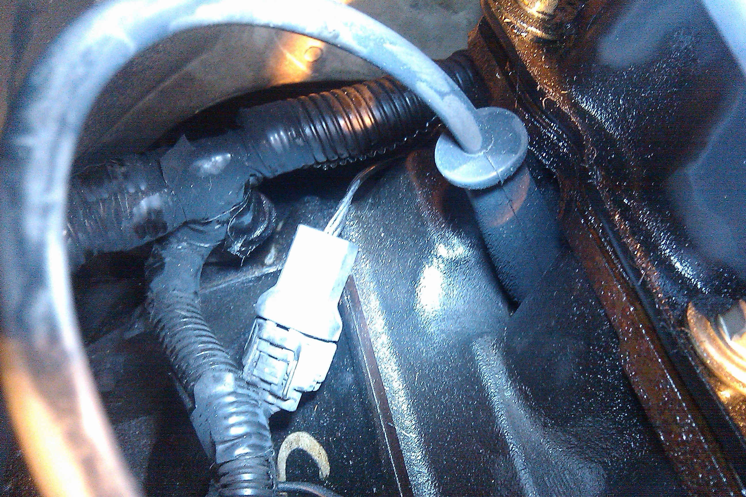

so crawled under the car couldnt see anything loose from the bell housing. felt around up top and couldnt find anything. the circled item is still a mystery because i cant find anything loose that would fit it either. my chilton guide is useless with diagrams for my truck..really close to doing the "beat it til it works approach! really bummed, i wanted to turn her over and hear what she sounds like with the new exhaust manifold.

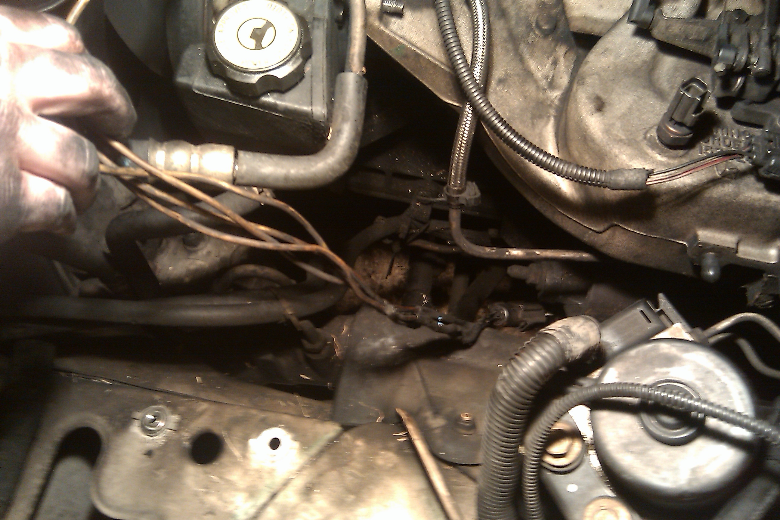

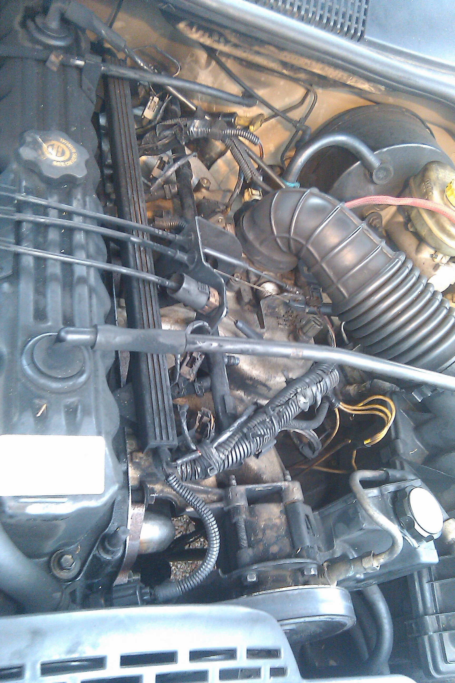

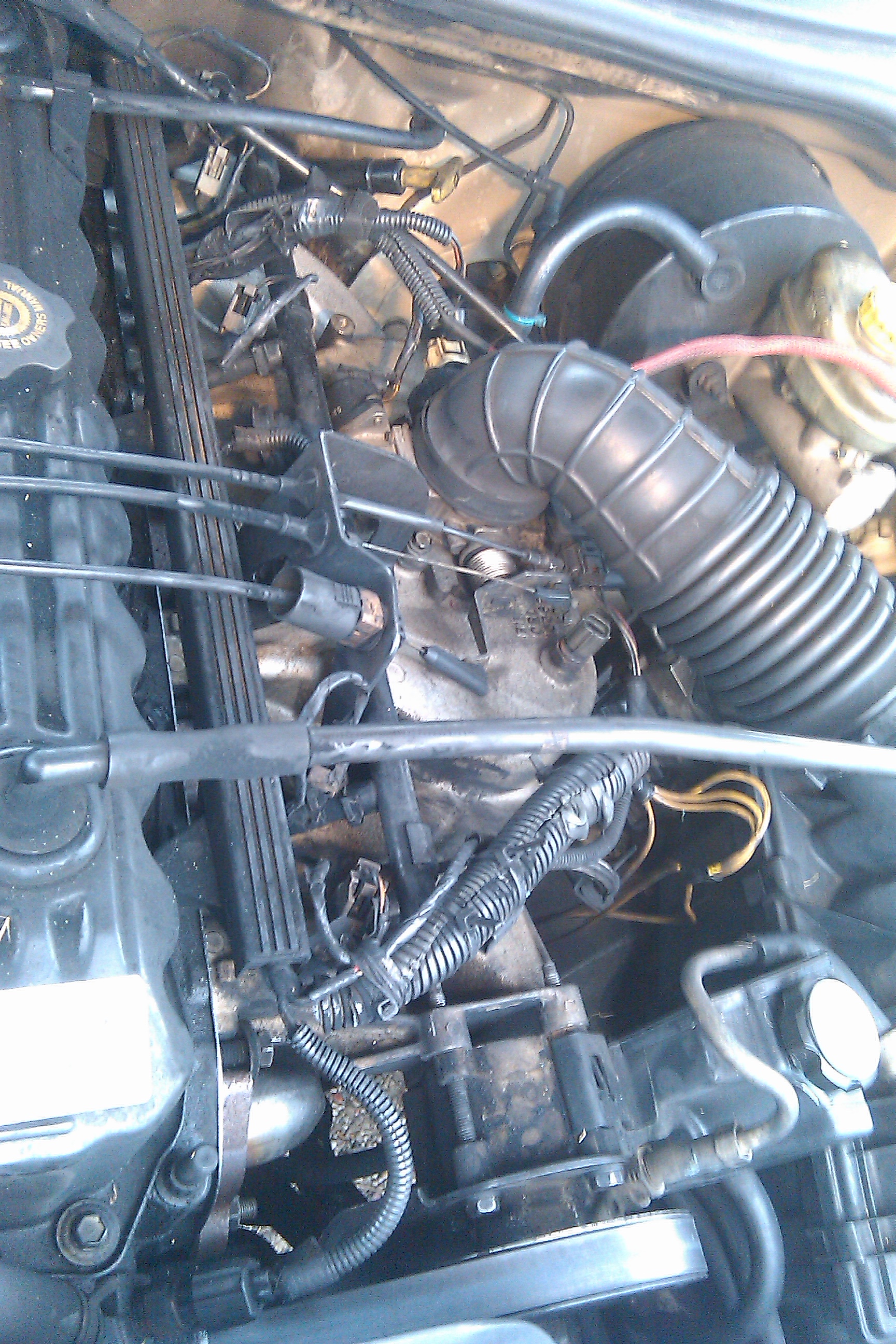

So Ive hit a brick wall. I've attached some photos. The third one is the sensor from the bell housing, but on the passenger side of the engine. any ideas?

So I replaced the CKS (crankshaft sensor) it wasn't that. She still wont start and now my battery is dead. No Check Engine Light so I can't check for codes..I have no idea. Please Help!!!
Make sure none of the wires got pinched between the manifold and the cylinder head. Check the 02 sensor connectors for proper connections. Verify that they are not plugged in the opposite sensor. Re-check the map, iac, tps, iat, ect sensors connections.
