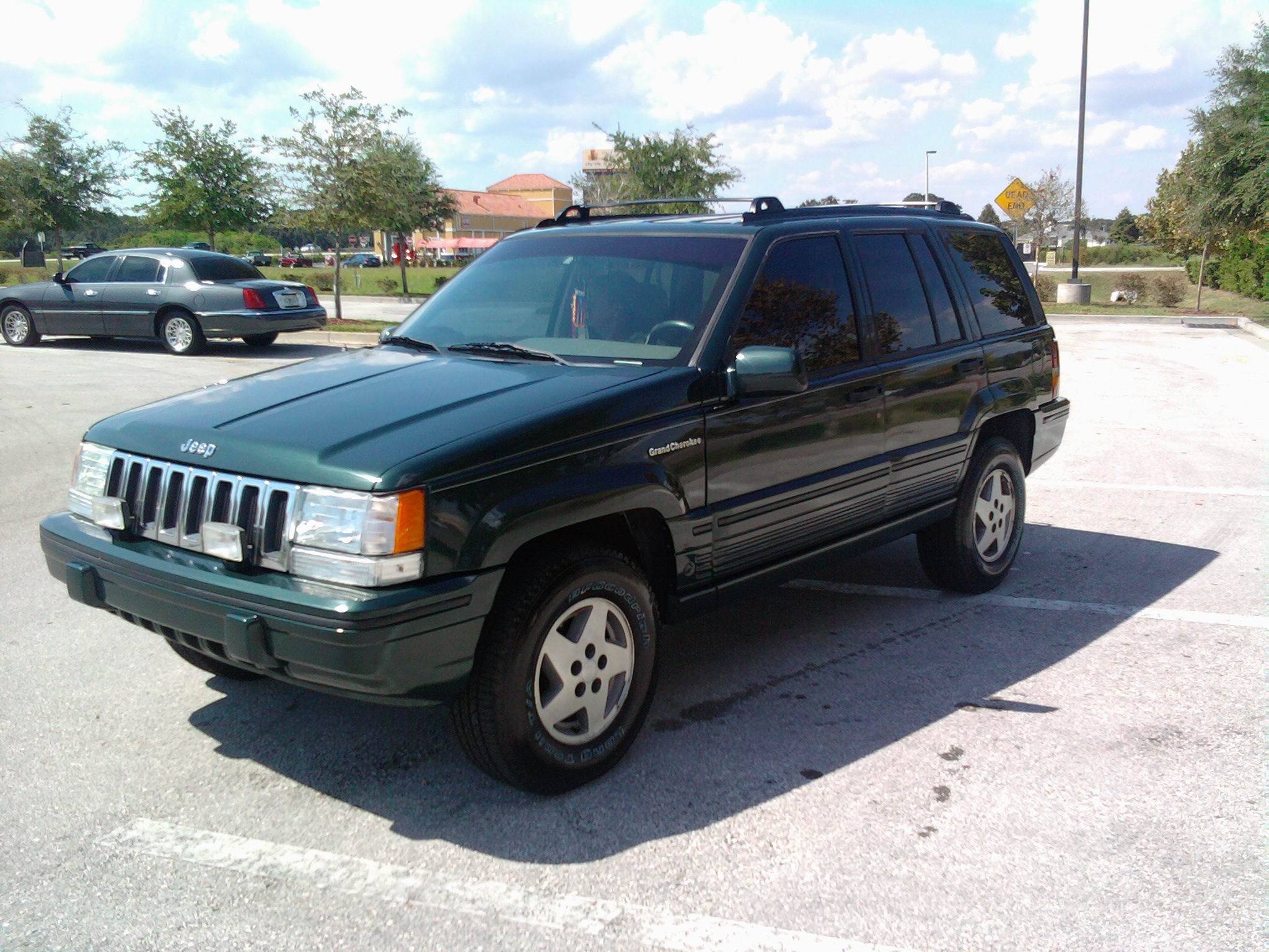

Hello All,
My first post, sure hope I'm in the correct forum. Anyway, I was slowly restoring my 1994 Grand Cherokee, first the engine, then paint, front axels, and catalytic, when I ran into a wall. With 147K miles, the transmission began to give me problems. The transmission will not shift into third unless I put the gear in neutral and allow the RPM to settle, then shifting back to drive the transmission shifts into third and fourth. All other gears work great, including the O/D. Not sure what transmission I have, I think it is a 46RH, but it is a full time 4WD, with a HI/LO option. I found other similar threads, but none for this year make. I even bought an output speed sensor, but my transmission doesn't have one, it just has a vehicle speed sensor on the transfer case. The first thing I did was to check my fluid level, and it was OK, so then I replaced the filter and fluid (Castrol ATF+4, 4 Qts). Short of replacing the transmission, I'm out of ideas.
Please advice
Best Regards,
El Brujo

:???:Well, I contacted Jeep as Terry suggested, they responded within 24 hrs; verey fast. I do have a 46RH as suspected, so no output speed sensor here. I also replaced the fluid twice, with new filters every time. Used Castrol ATF+4 fluid, again it only took 4 Qts. Lastly, I added a bottle of Lubeguard for Mopar trans as Carnuck recommended. The truck ran perfect for about a month, then the trany began to worsen in a hurry. Grinding, slipping, hard shifting, late shifting, you name it. I parked the truck again, awaitting a new trany.
Seeking recomenendations on a reputable trany shop, preferbly in the Kissimmee/Orlando FL area. I'm not letting my JEEP become a clunker, no way.
