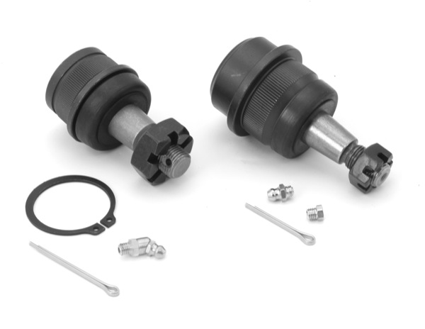

The pictures of the two joints show grease nipples provided with both, but with the lower one there does not seem to be any space to fit it in.

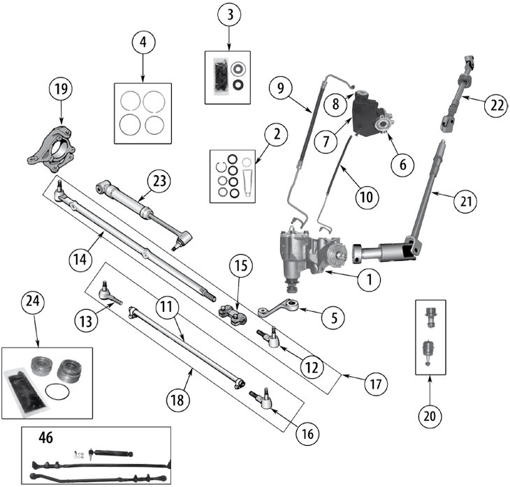

Do you mean 12 & 14 or 13 & 16
Is your system stock? Pics please

Thanks for the advice so far. Having had a closer look at what is on the car it seems that I have one greasable ball joint and one that can't be regreased. I have attached a pic of the knuckle and also a pic of what Crown are offering as a replacement which clearly shows two nipples in the pack.
There is just no space to fit the nipple between the top of the joint and the universal joint so it seems you have to run it without the option of regreasing, which does not seem a good idea.

The new lower will have a grease fitting and a plug in the parts pack.install the fitting in the joint and grease the joint.remove the fitting and install the plug.

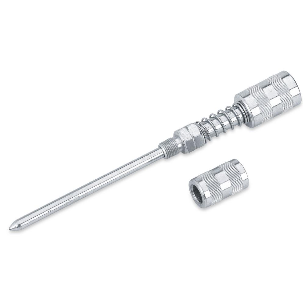

Now I see your concern. ^^Agree ^^ use the plug or get a 'sealed for life' one. However there is a way to get some grease into the boot.
New
Alternative:
If there is room or an alternative path can be made.
Older part near end of life
The needle works but I recommend going under the boot if possible.

Thanks for the advice eveyone. I think I will do a combination of both as well as pumping in more grease before I fit it. Re the plug suggestion. For later on I'll see if you can position the U/J so you can remove to plug and fit the nipple and then put it back. I had not noted the plug in the picture.
