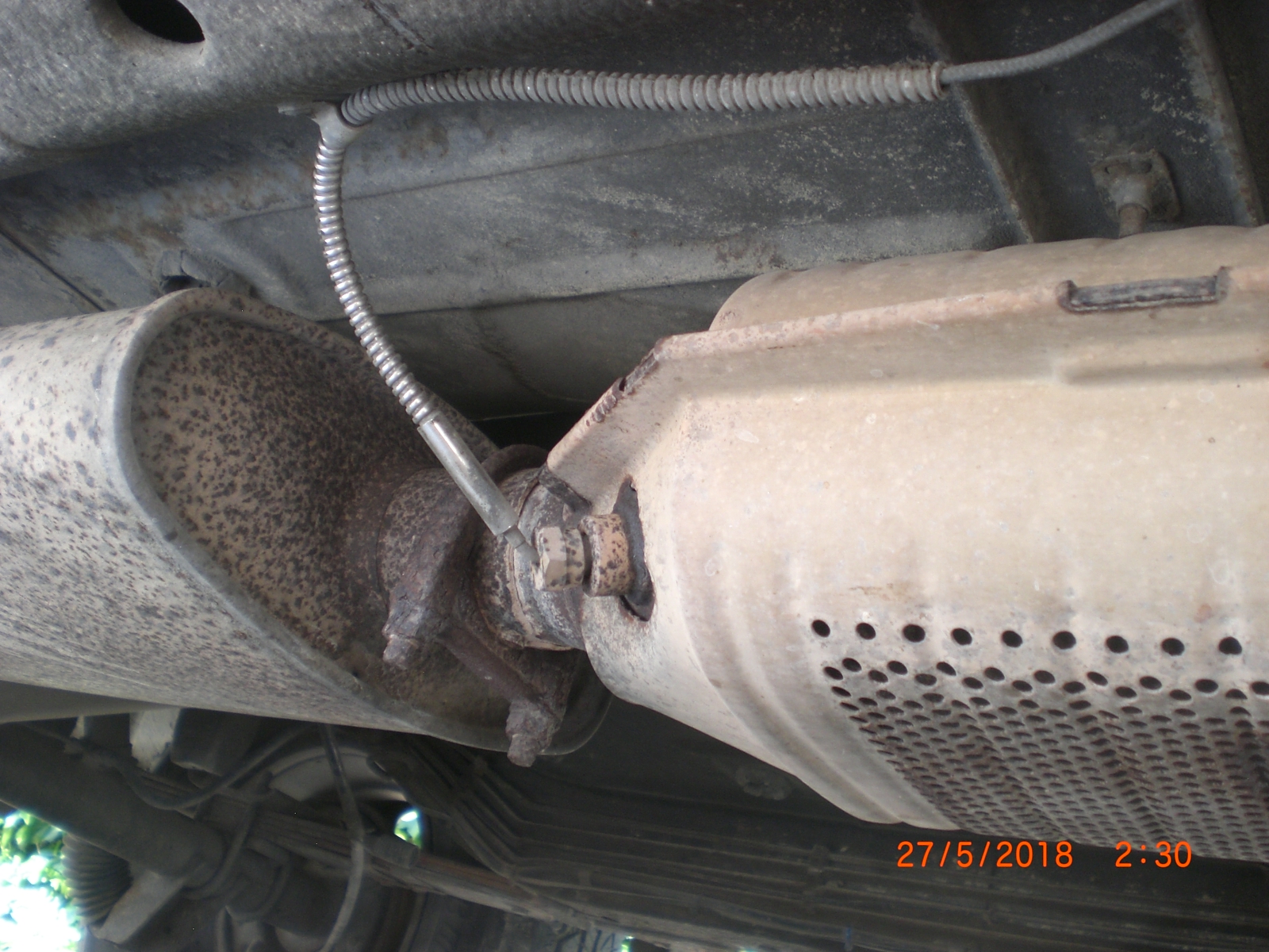

Hello,
I will be fitting a new cat shortly and may have to fit a new rear, (after cat) oxygen sensor if the current one gets broken.
I have hunted high and low but can find nothing like the one currently fitted so can someone please help.
Apart from the baffling number of choices and equivalent information which seems to differ depending on where you look I am still none the wiser.
As the picture shows it looks normal enough at the bottom end, but there is no connection nearby instead it goes up past the starter motor picks up the hood release cable in a conduit and goes inside behind the dash.
There surplus length is coiled up and the plug connects to a little black box. The cable must be at least 2 metres long.
Does anyone know what I have got and where can I find one? All suggestions welcome.

I have been advised that this is not an oxygen sensor but a temperature sensor. The mystery is why it is fitted to my Jeep when after cat oxygen sensors did not come in till 1998. I can find no mention of temp sensors.
I don't know its purpose. Is it simply to warn of high exhaust temps or does it go to the ECU and control he injection? Does anyone know?
To confirm that it is a temp sensor check this out:-
https://www.aliexpress.com/price/exhaust-gas-temperature-sensor_price.html?src=google&albch=search&acnt=479-062-3723&isdl=y&aff_short_key=UneMJZVf&albcp=266121556&albag=7593673036&slnk=&trgt=dsa-42862830006&plac=&crea=64152518716&netw=s&device=c&mtctp=b&memo1=1t3&aff_platform
The problem now is which one is it? All suggestions welcome.
I have been given the following Jeep part number 52079197 which comes up as a temperature sensor for a RHD European spec on a Mopar site but I cannot see any further details.
Rear O2 sensors did not appear till later.
Comparing the pic above to what I have shows a much fatter item, mine only measures 3mm dia just behind the 17mm hex nut and has a non detachable 3m braided cable only 4mm dia.
I need details for the temperature probe to do a fitment check on the new cat which is M18 x 1.5.
I also would like to know why it's there and what it does and can anyone find one for me or point me in the right direction?

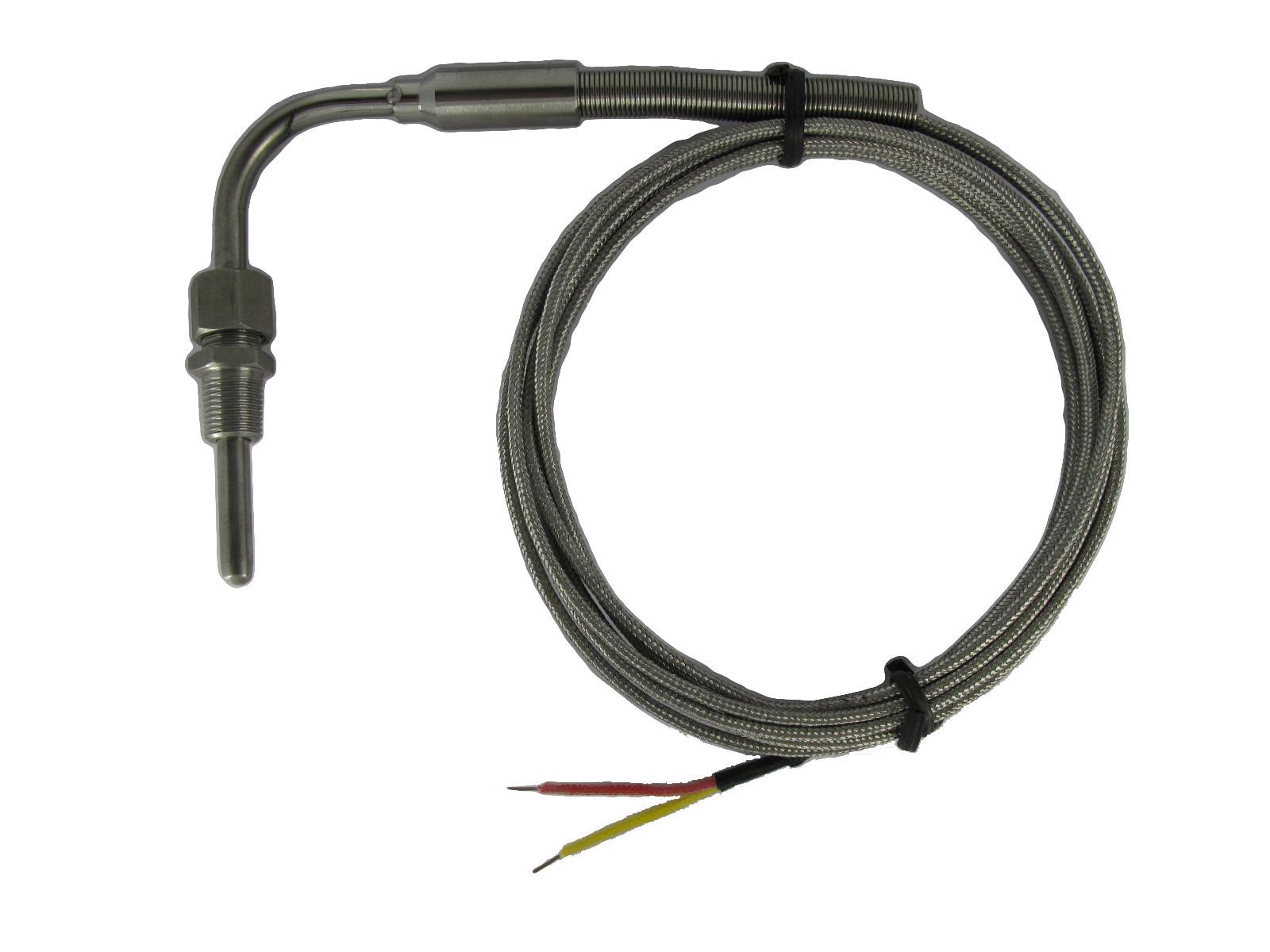

The temp sensor is a K Type EGT (exhaust gas temperature)and can easily be found on Ebay. Ensure it has a 3m (9.8 ft) cable and afitting on the probe with a 1/8 NPT male thread. Buy one with a 90deg bend soit sticks out less under the car. It should look a bit like this and will costless than £5 ($6 or €5.70) incl p&p.
2Q==
Z
There will be no plug on the end so use the old one and follow the colour code of the wires. Solder the connection and put heat-shrink overthe joint. Do the joint a couple of inches (50mm) from the plug.

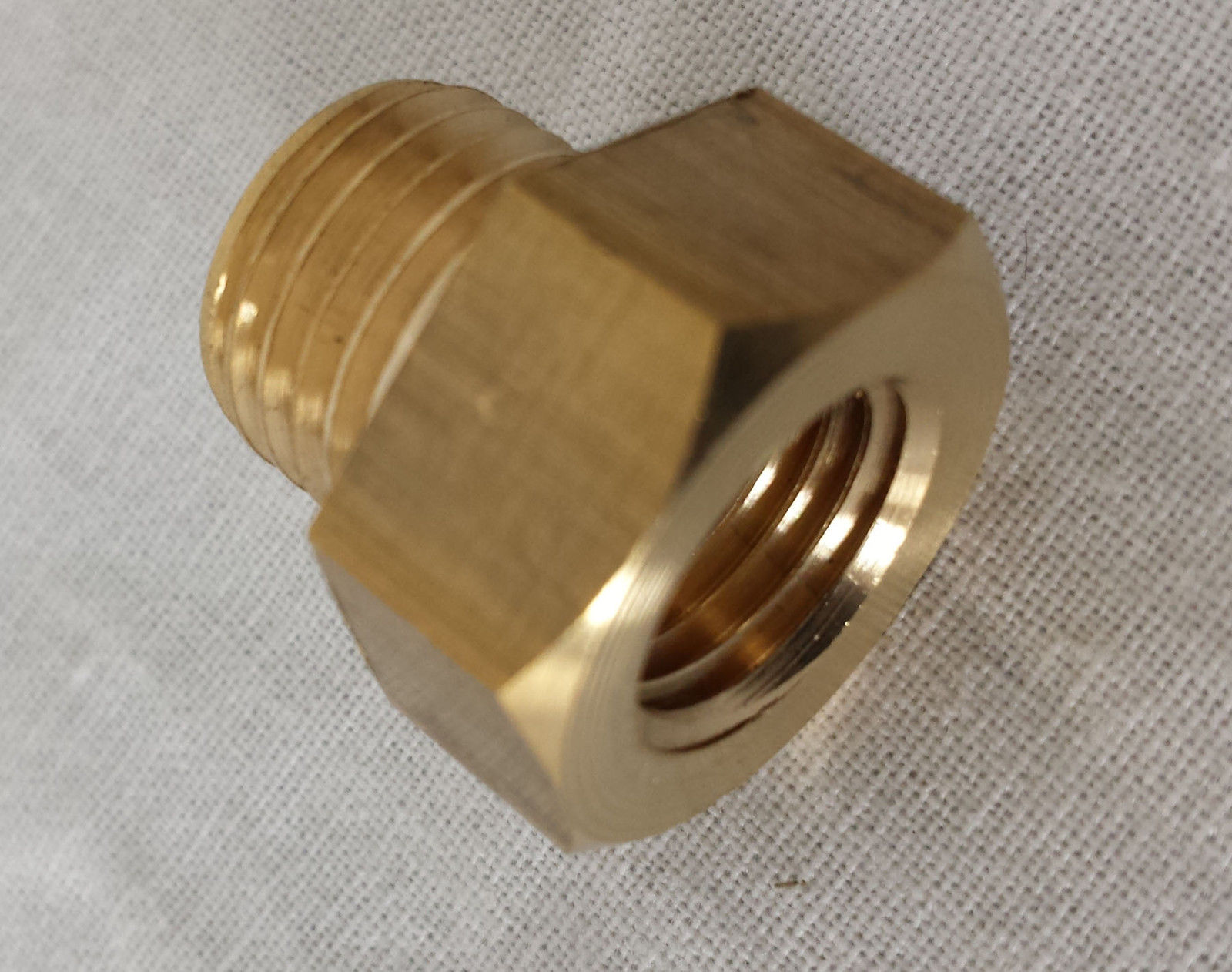

Next you need an M18 to 1/8NPT Adaptor. Again, you can find these on Ebay described as a sump (oil pan) plug adaptor. I got a brass one for £12 ($16 or €13.70) incl p&p.Itlooks like the one above.
Now all you have to do is put it all together.
