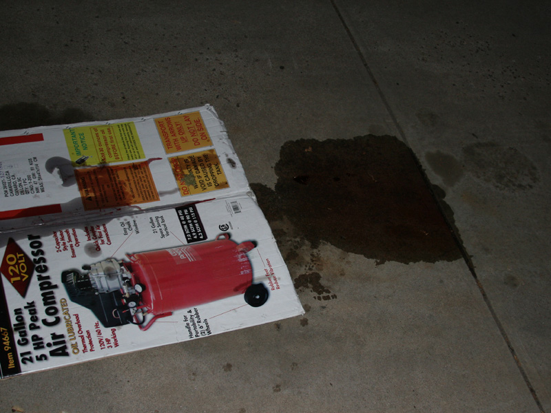

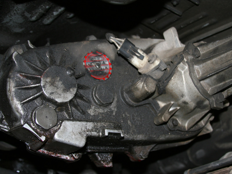

Saved a 94 4.0 Grand Cherokee from the crusher, it really only has one major problem. The transmission is leaking very badly at the t-case, which I believe is where all the problems started with it being run dry (previous owner). It slips and hunts for a gear, also it will rev past 2500 rpm before it shifts (sometimes). I have been told solenoids, governor, valve body and throttle valve cable all could be the cause, it may just need a rebuild. The previous owner did not take care of it well. So is it salvageable or should I just rebuild it? How hard is a transmission rebuild? Can a rebuild be done with basic tools? What should I be looking at first (fluid is full, clean and correct type)? This jeep is for the family and we would love to keep it going! Thanks guys in advance.

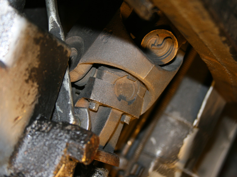

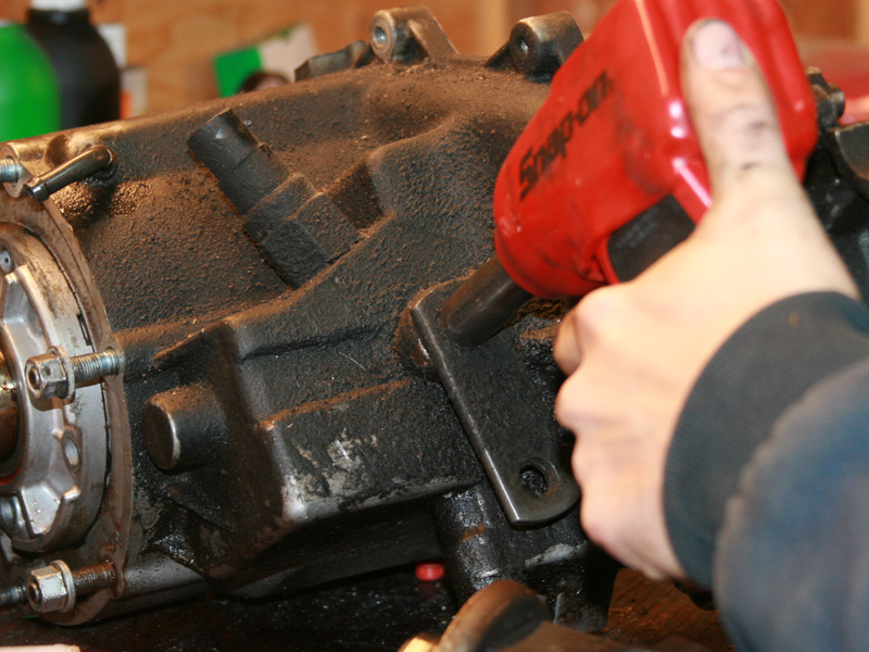

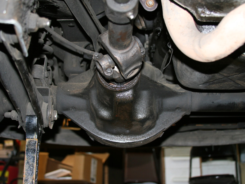

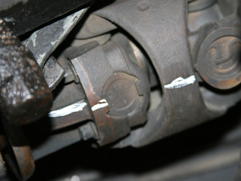

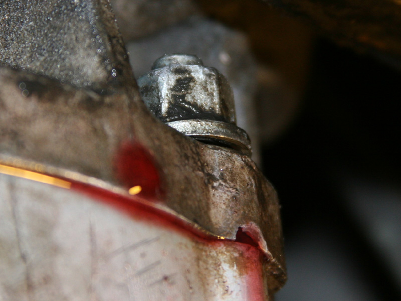

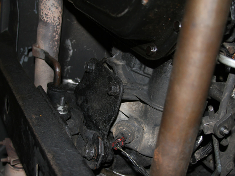

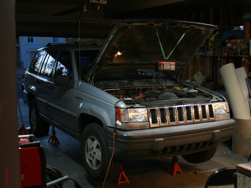

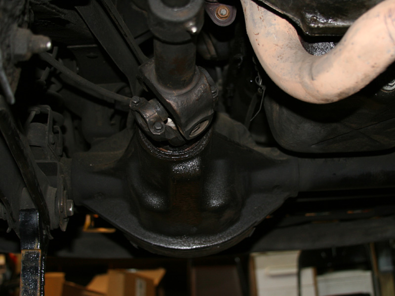

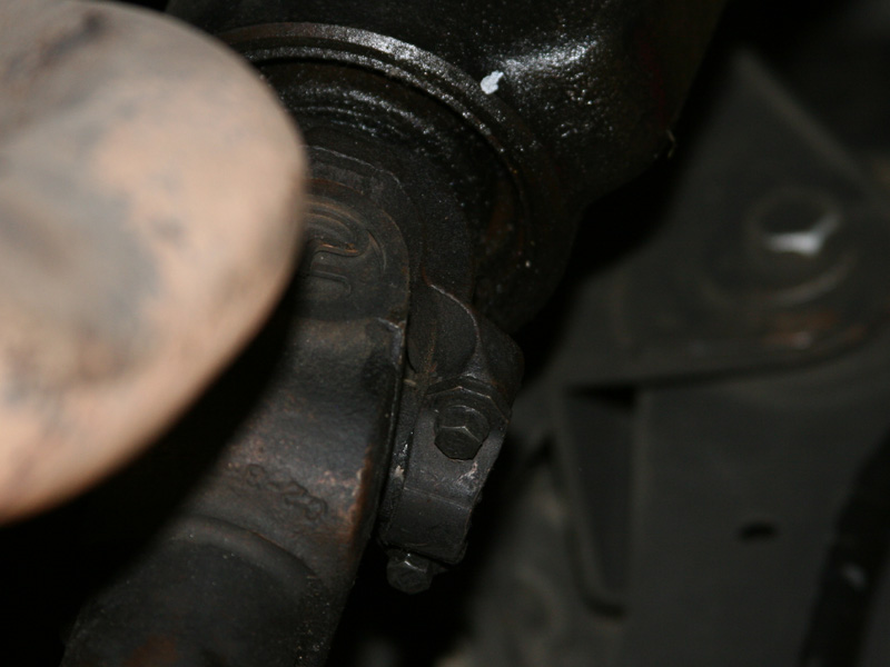

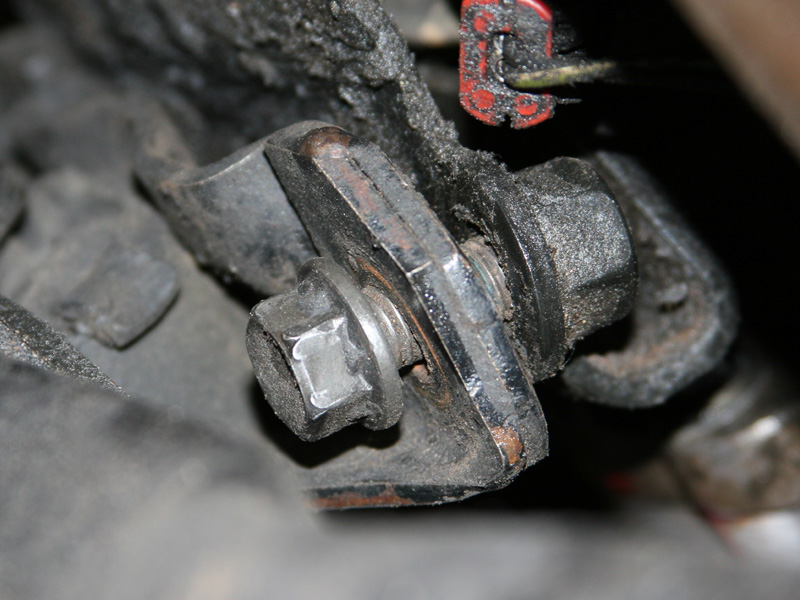

well started tearing in the jeep today and was i got a surprise, almost every nut and bolt was loose. plus the transmission mount on the lower cross member is dented and banged up so badly it is going to need replacing, heres some photos we took of the carnage.

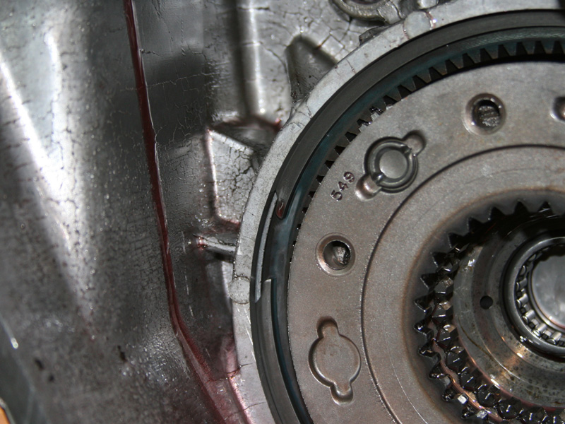

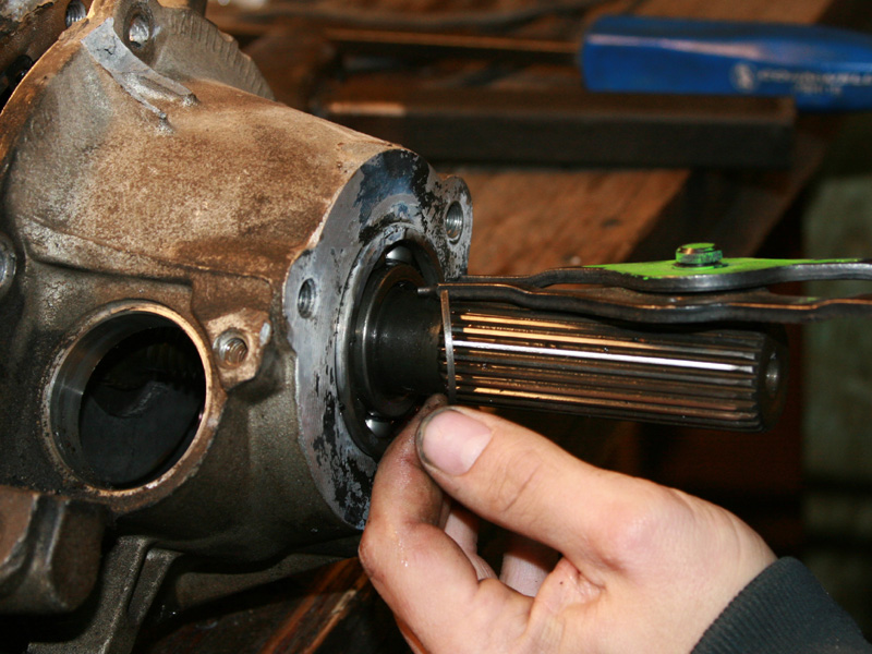

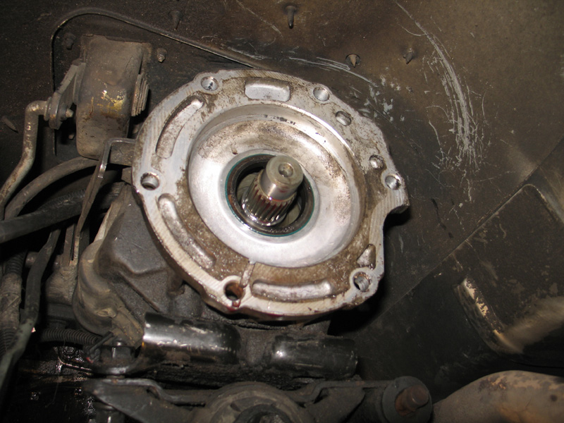

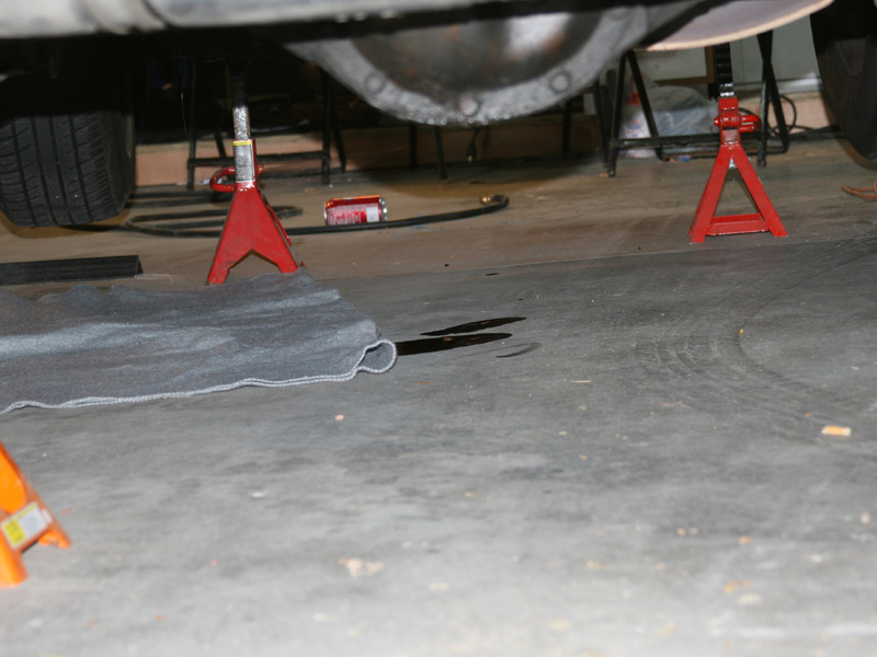

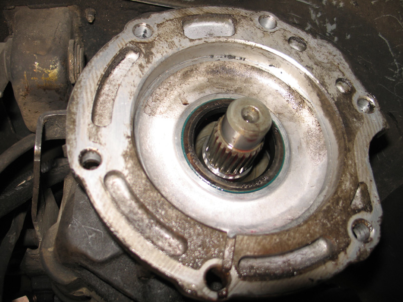

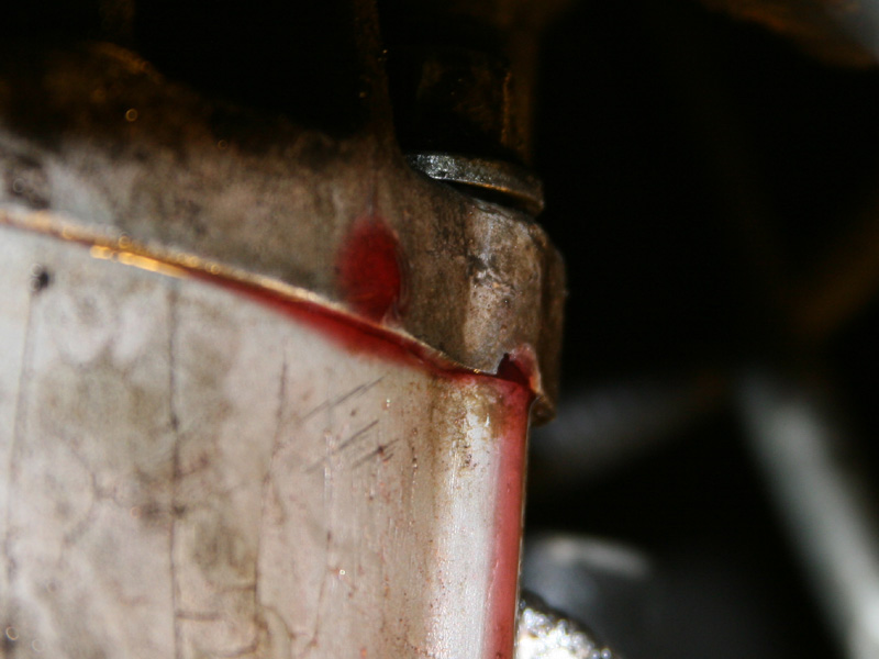

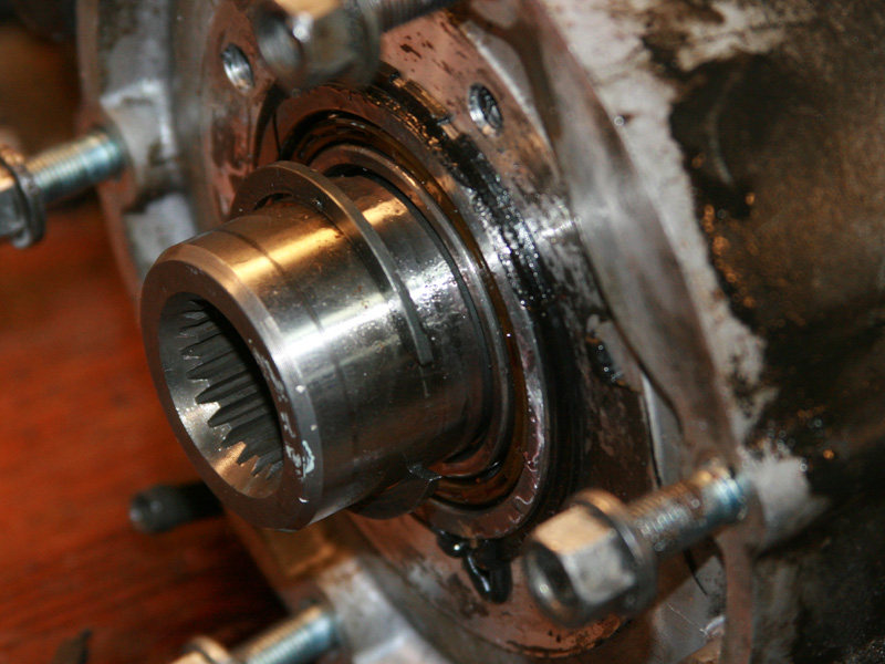

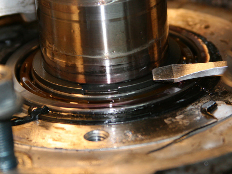

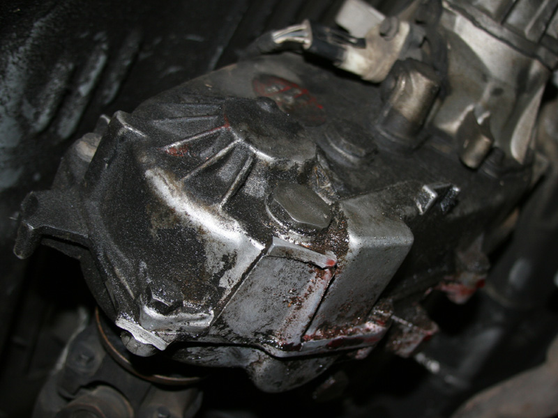

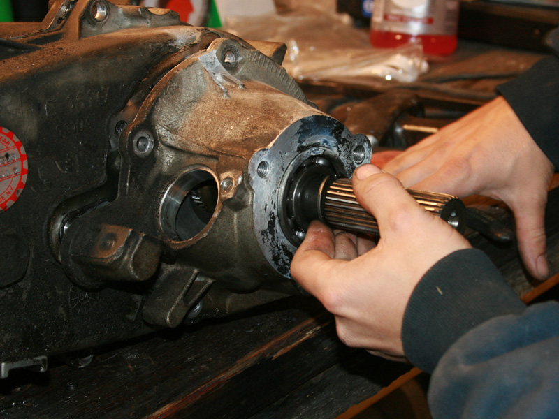

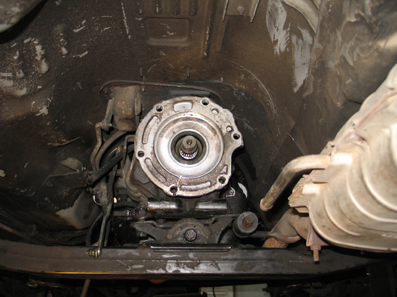

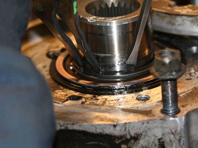

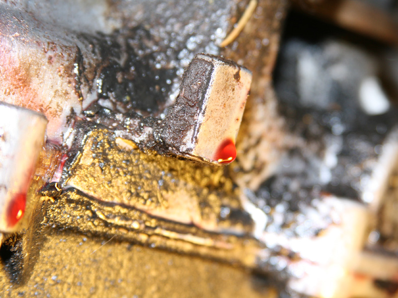

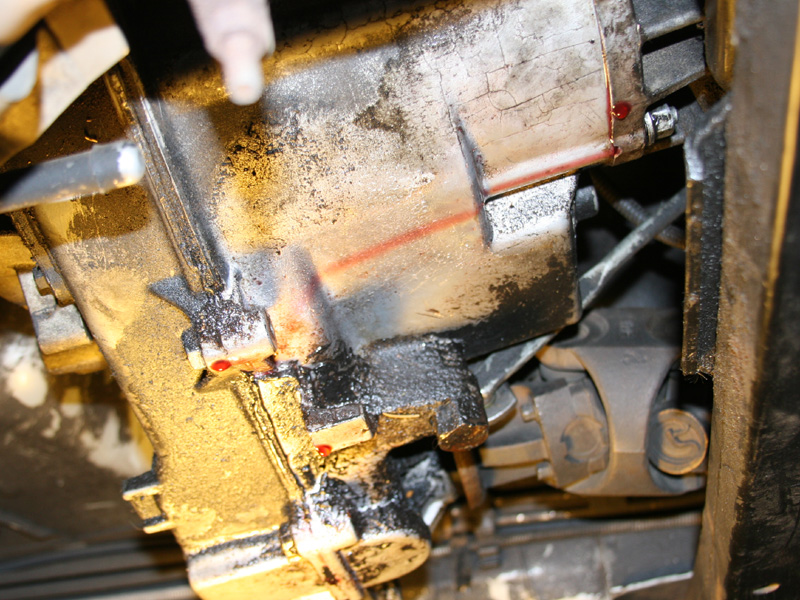

Hey quick question, is there supposed to be a seal between the overdrive unit and the transfer-case? Thats where the huge leak was coming from thus why I dropped the transfer-case. My Haynes repair manual is lacking a detailed exploded view of the drivetrain.
Yes there is, it's that black rubber ring on the inside of the tailshaft housing seen on the picture. There's also a seal on the mating flange on the t.case side.
Thanks steelheadz but is there supposed to be a gasket between the overdrive housing and the t-case (sorry if i sound dumb)
Some does and some don't. The only thing that gasket will do is keep the dirt and water out. For that matter, you can use an ATF RTV.
that was probably the whole problem, making sure everything was tight.
Just a quick update on the Grand Cherokee, I noticed that the throttle valve cable is broken so that explains why the over drive was acting funny, so that will get replaced, I'm going to overhaul the NP 231 transfer case and drop the transmission pan to adjust the bands , replace the filter and pan gasket for sure (also add a drain plug and maybe a temperature sensor). I would like to replace the seal on the back of the over drive housing but I'm not sure if I can do that without tearing down the the overdrive unit. And I would also like to know more about replacing the 42RE's governor. Any advice or do's and don'ts would be greatly appreciated. I'm working 10 hour plus shifts right now but when I have the time I will post more pictures. Right now the jeep is up in the air in the garage on a trickle charge keeping the battery fresh (I've been told the computer can loose it's map if the battery is drained for long periods of time). Thanks for any advice in advance guys!

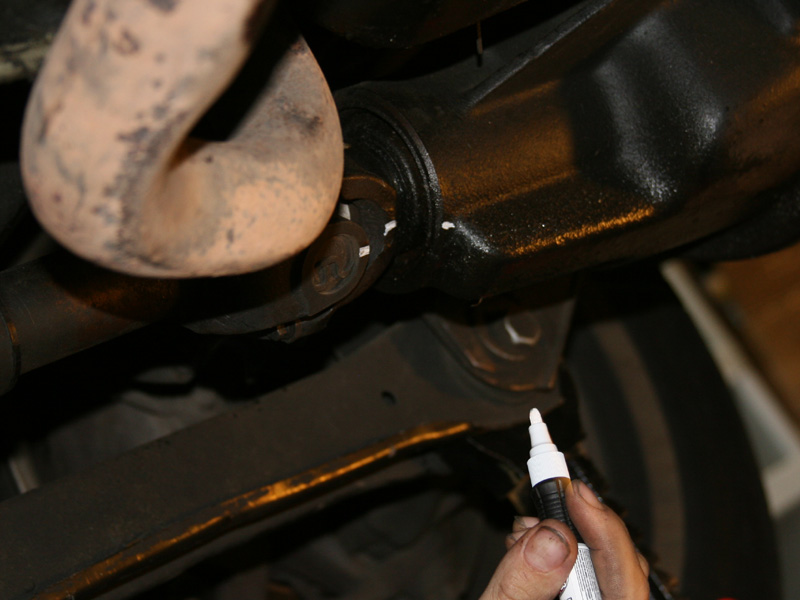

  28. Align and connect propeller shaft.

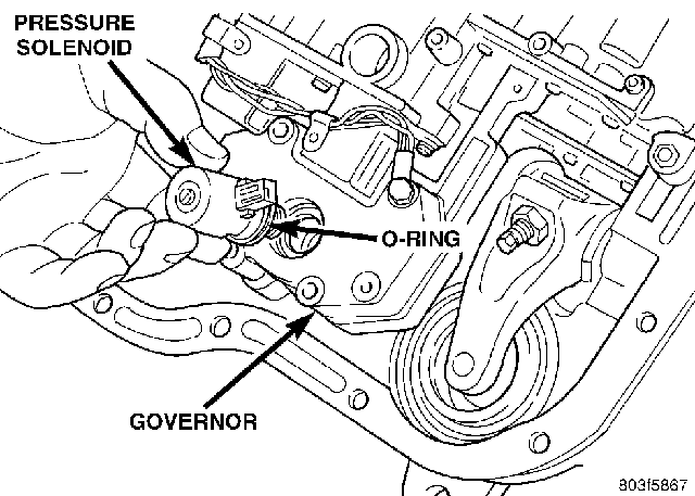

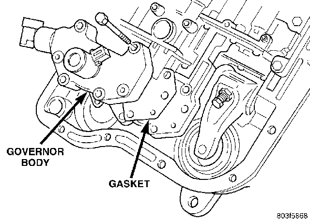

Gov. pressure solenoid:

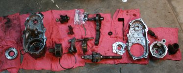

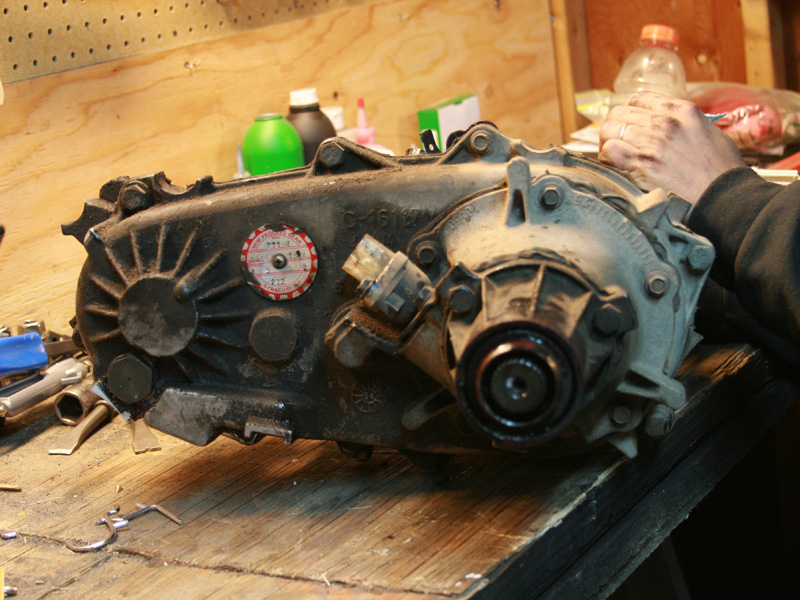

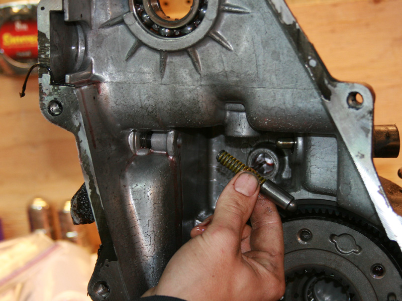

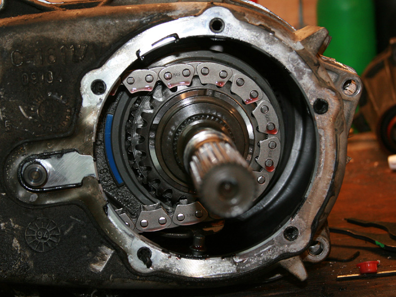

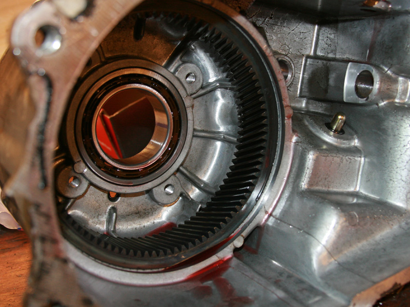

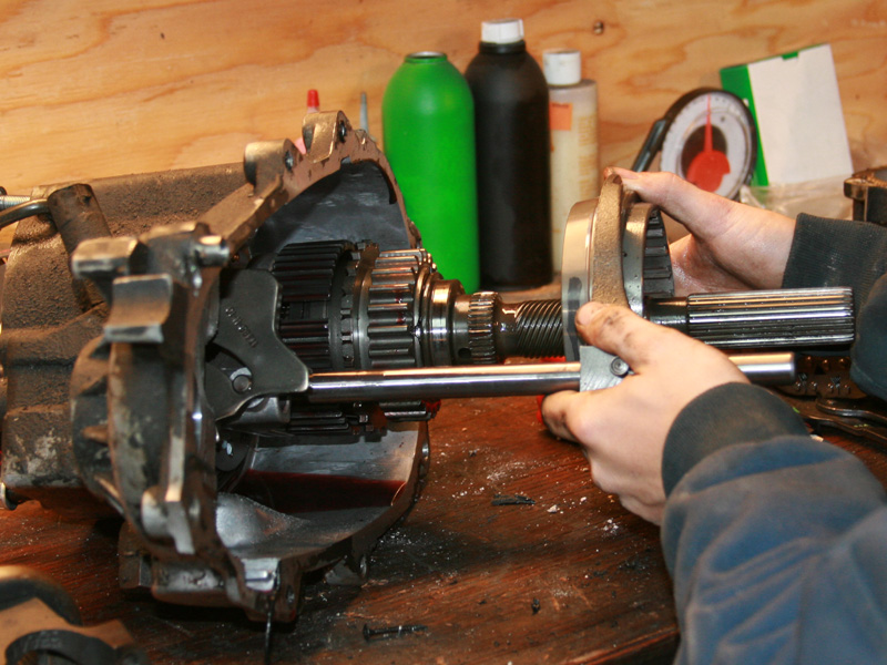

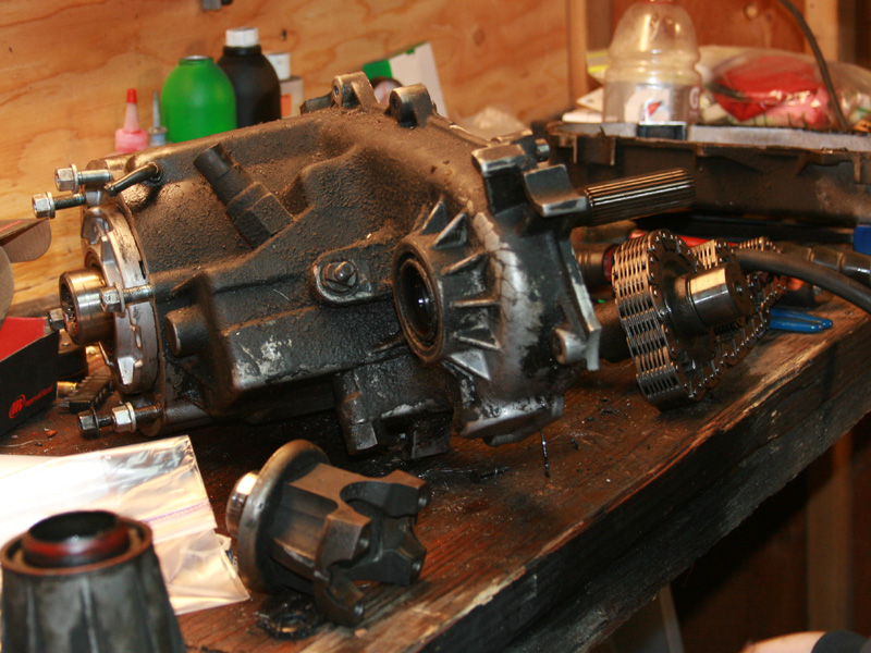

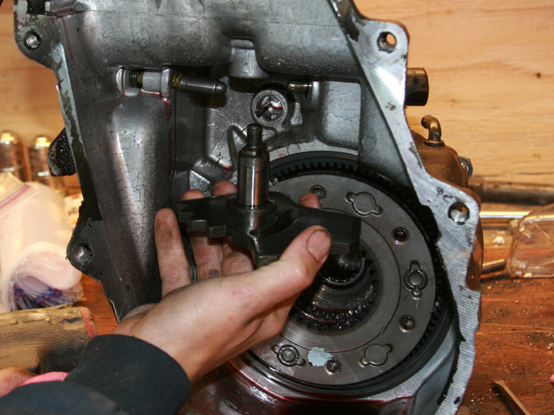

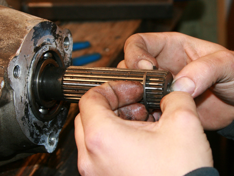

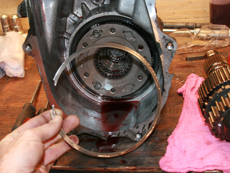

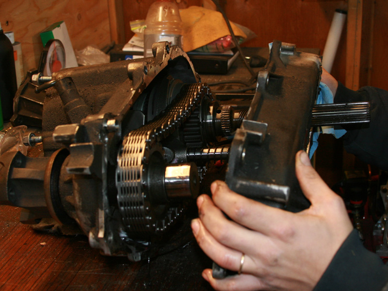

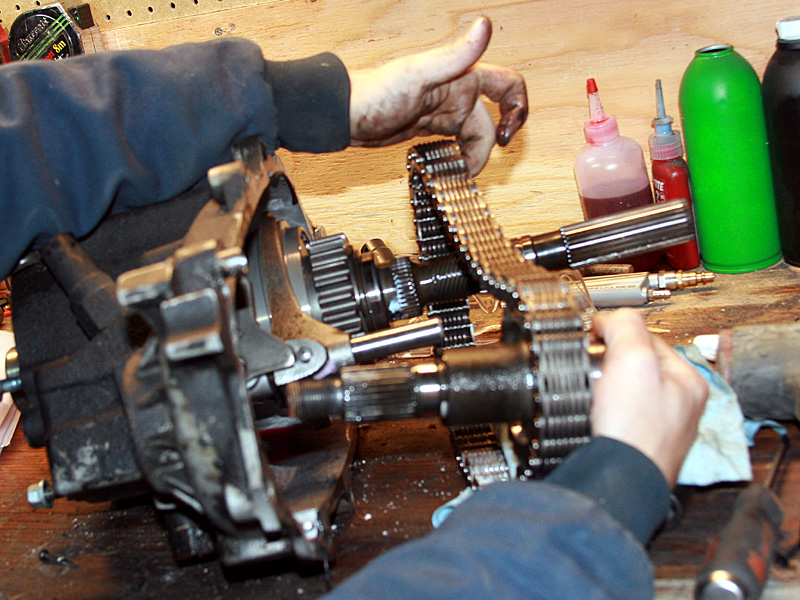

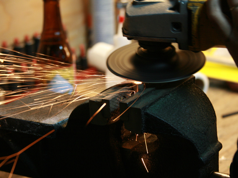

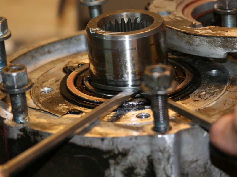

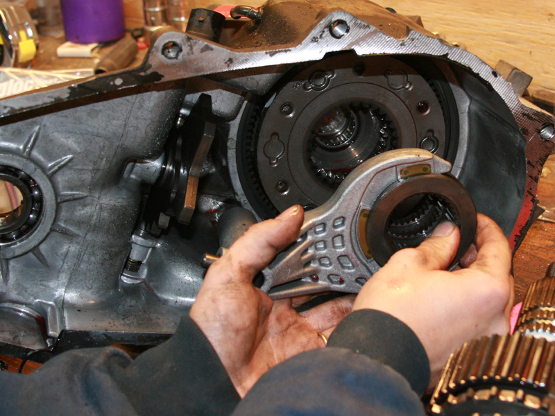

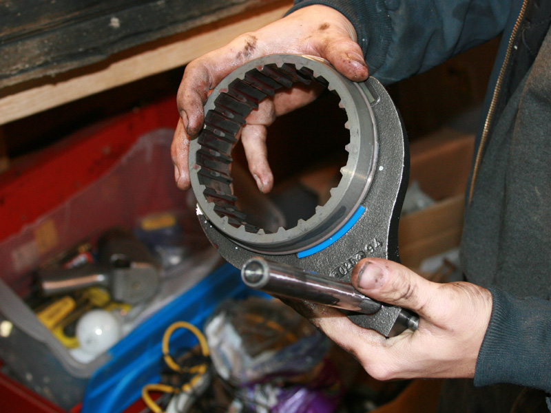

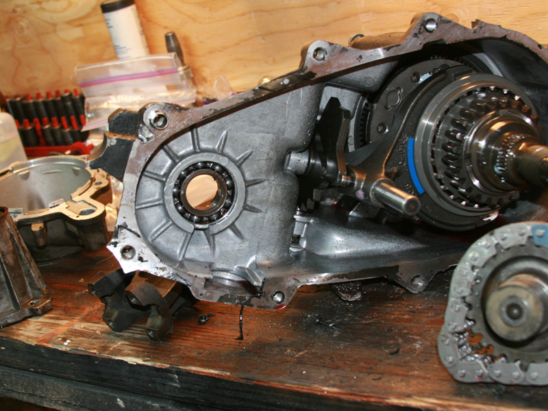

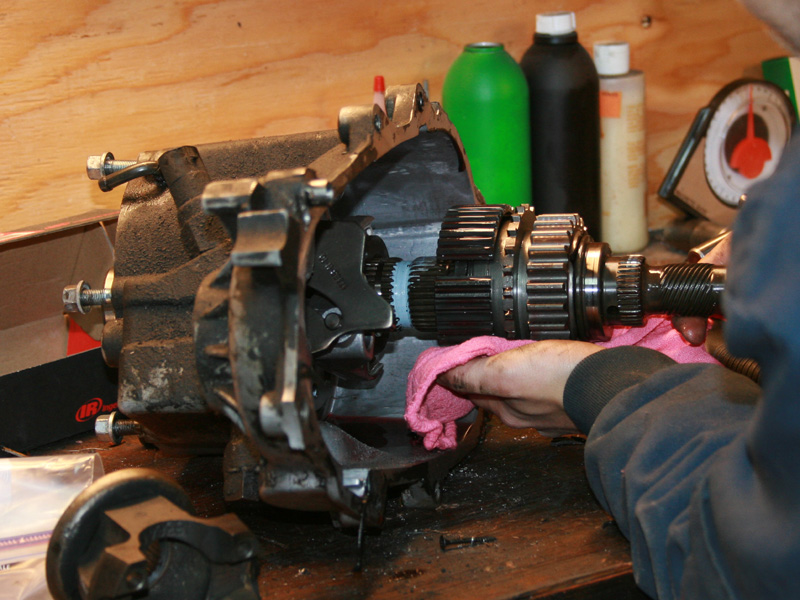

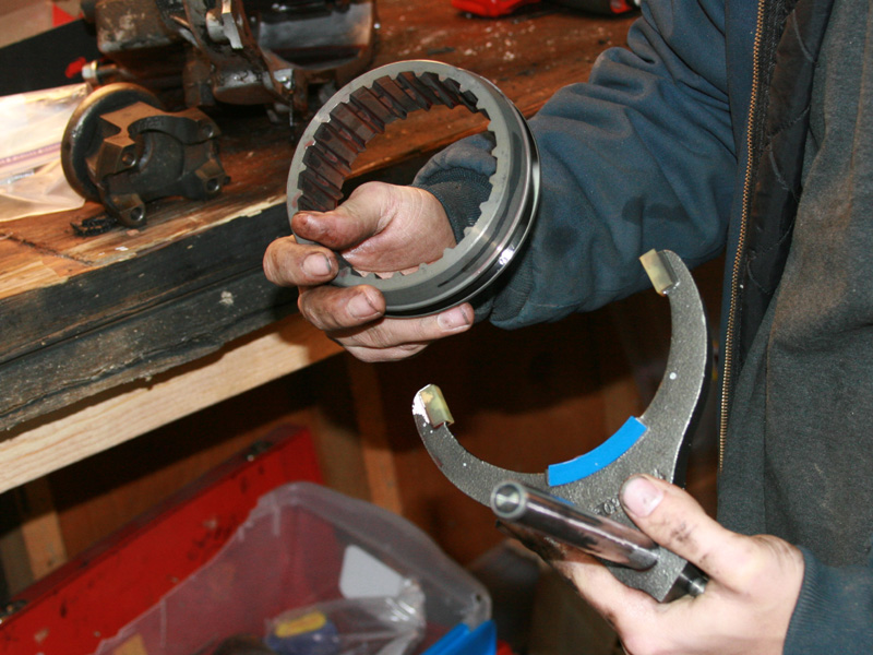

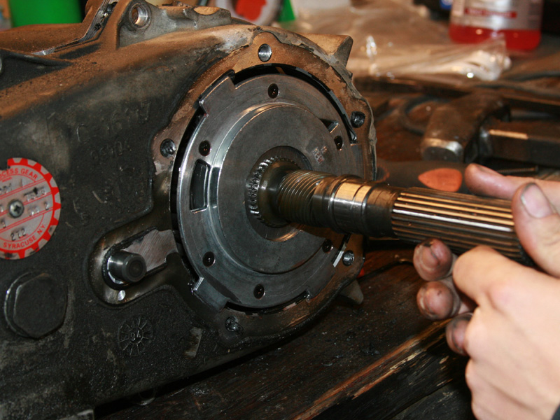

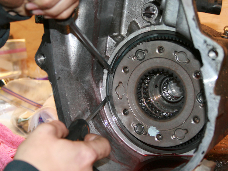

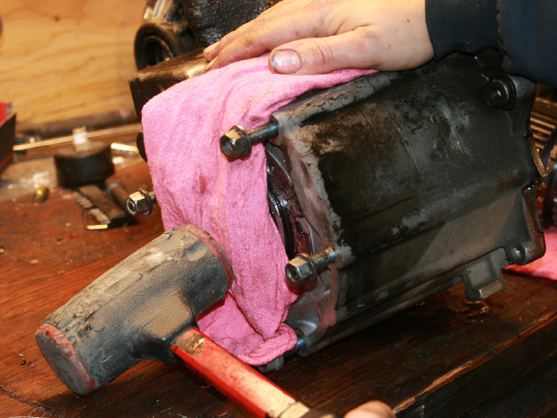

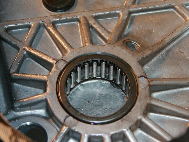

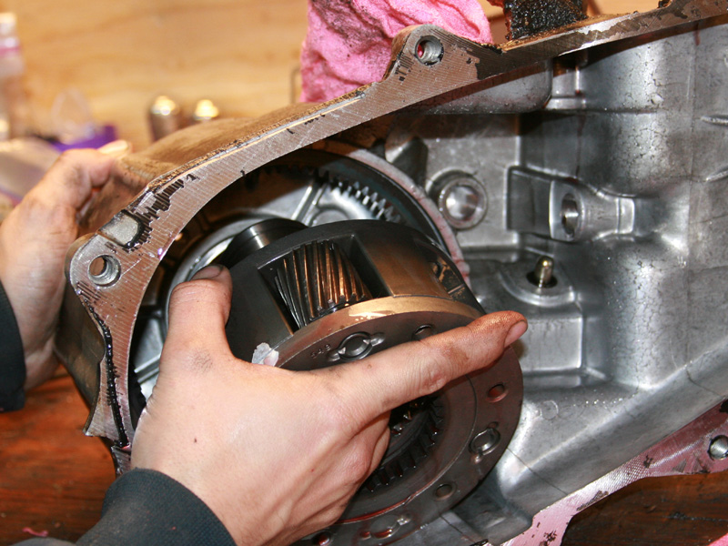

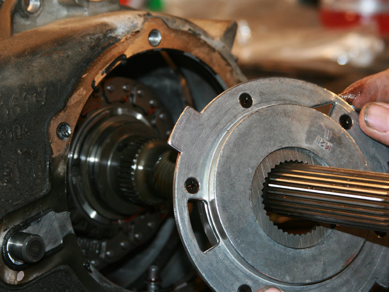

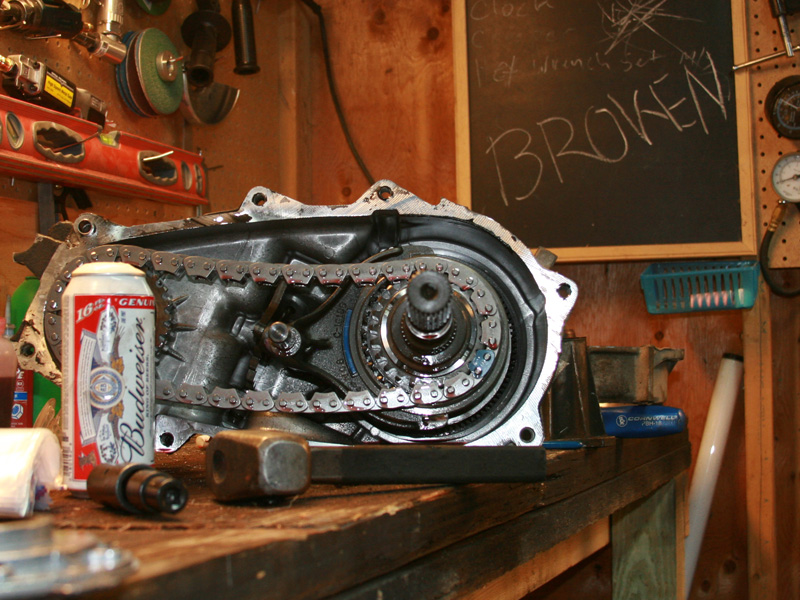

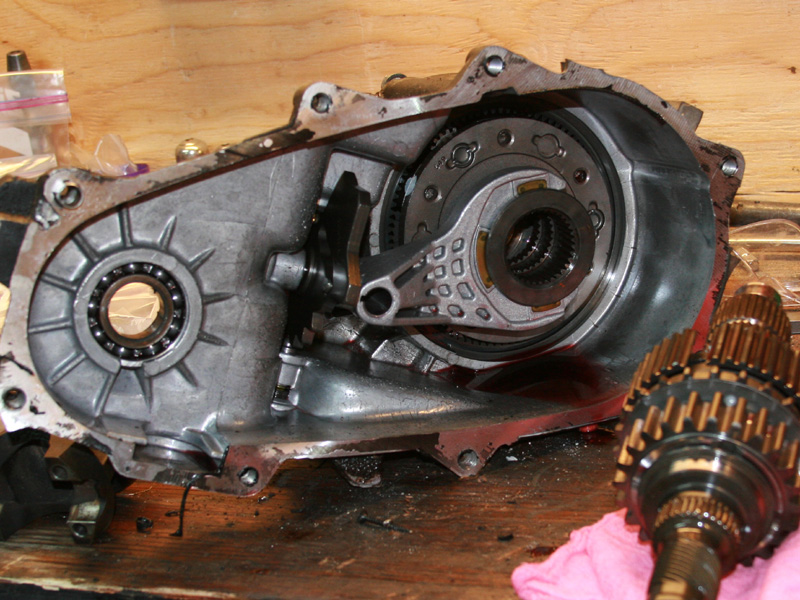

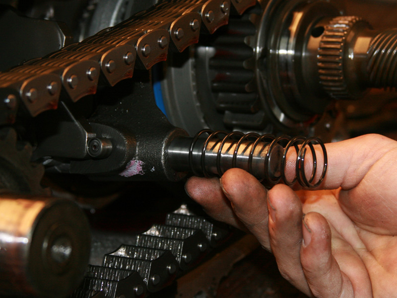

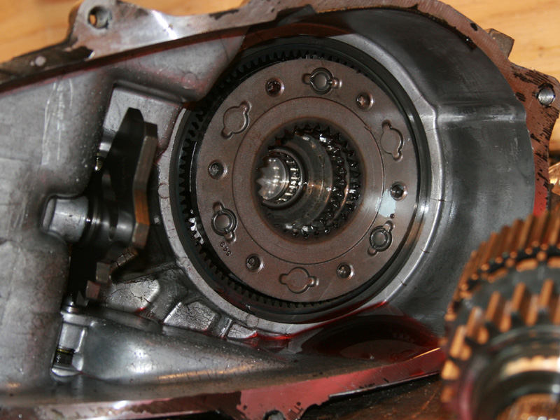

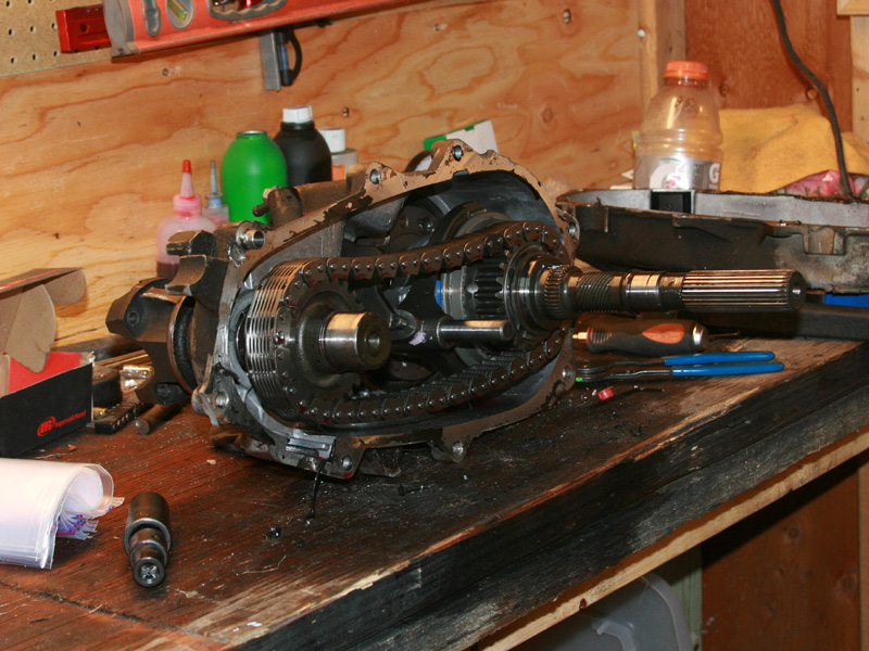

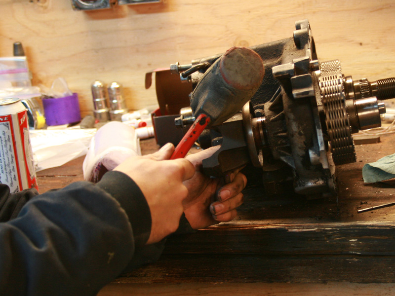

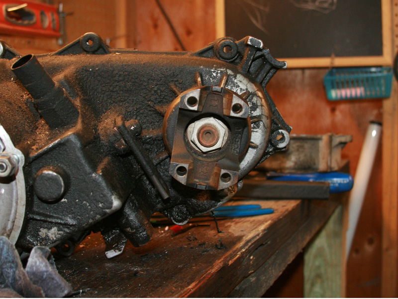

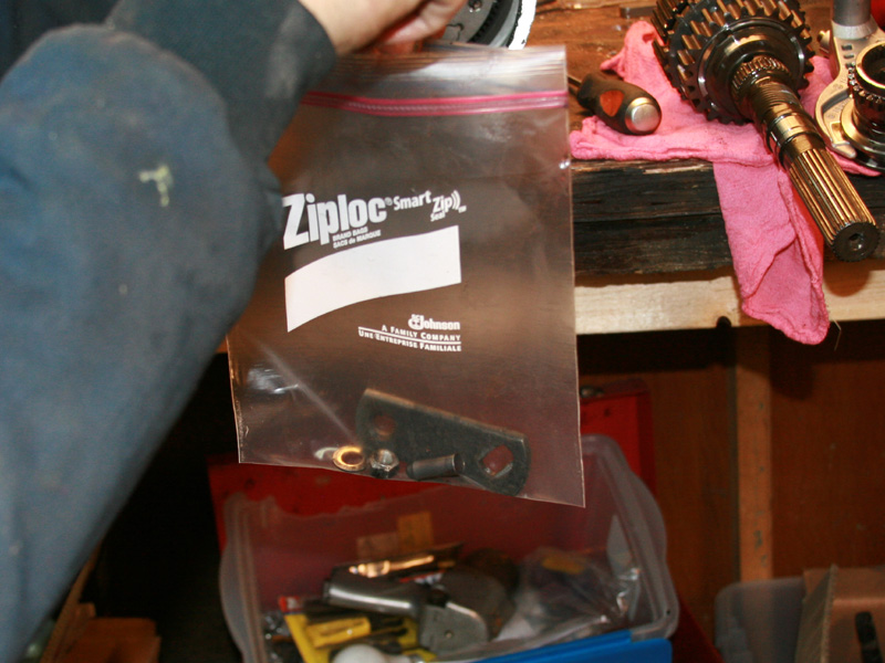

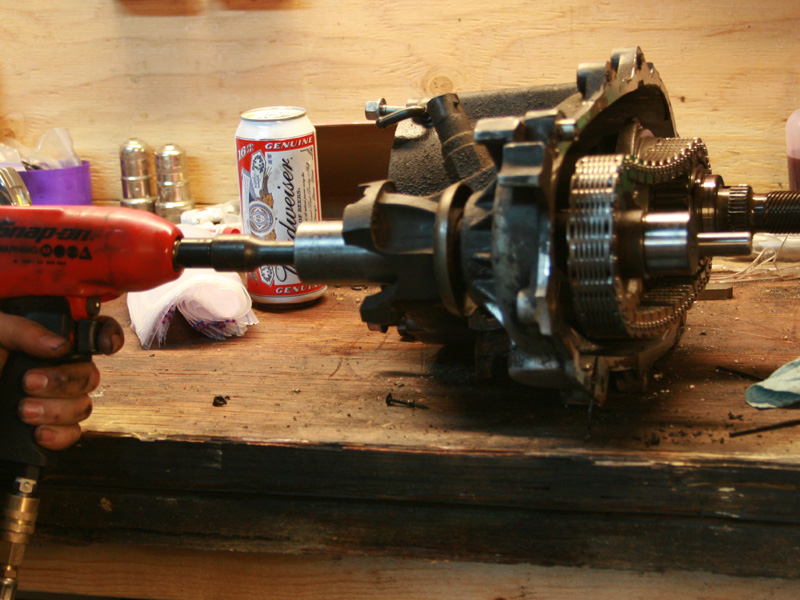

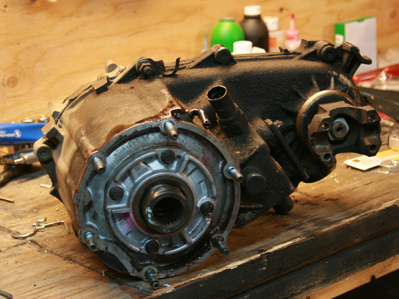

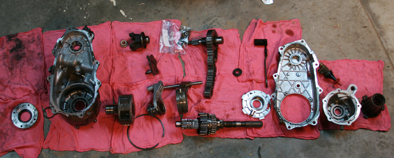

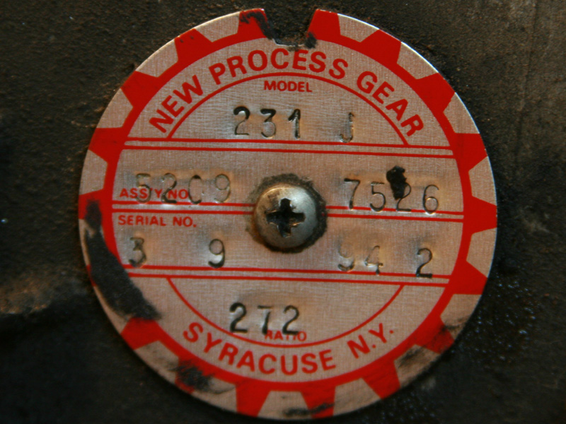

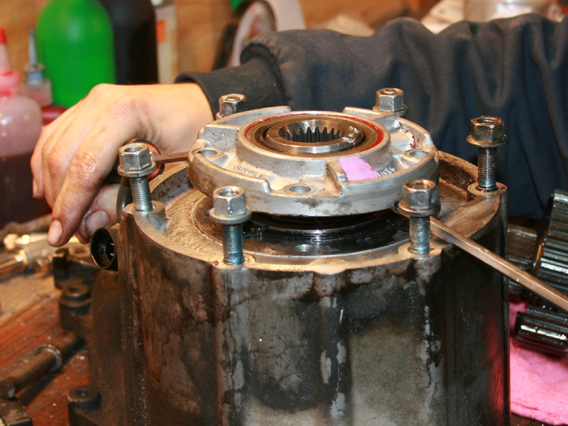

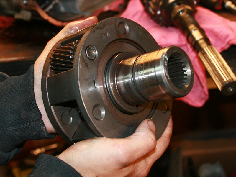

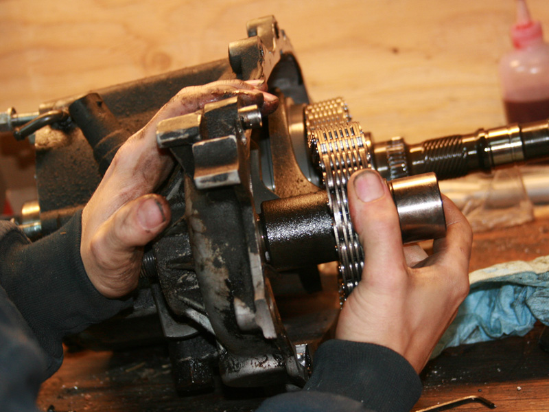

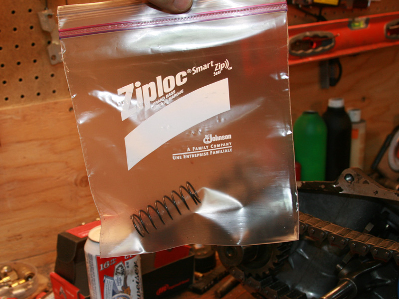

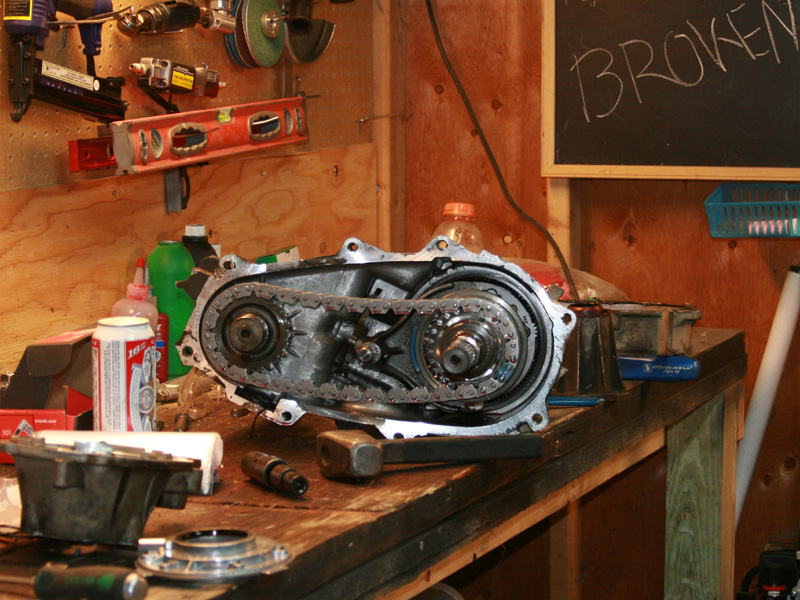

Pics from the tear down of my NP231 will order rebuild kit and take more pics hope these pics can help someone else with a tear down.

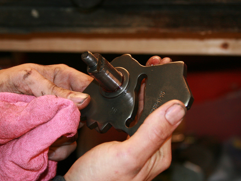

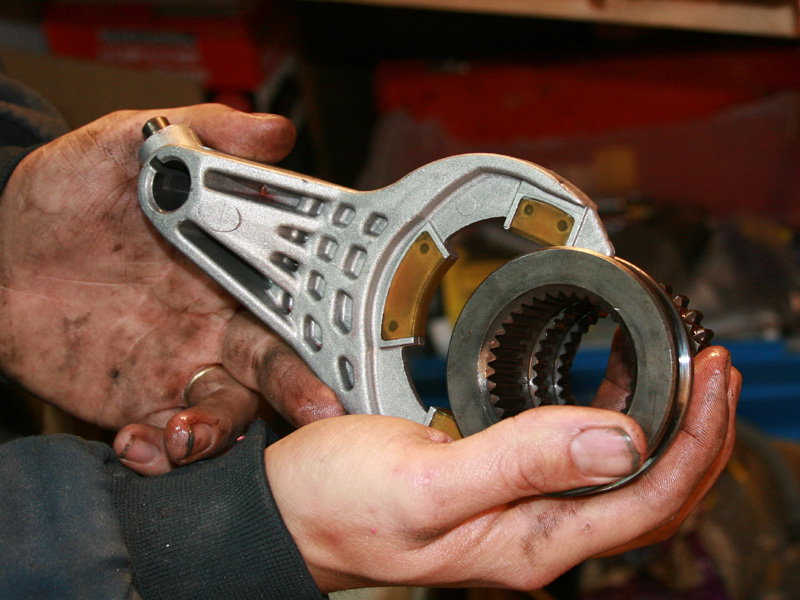

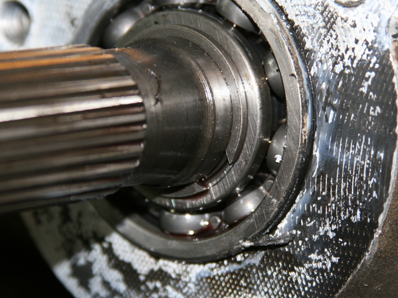

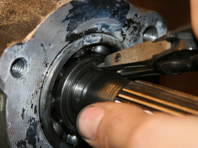

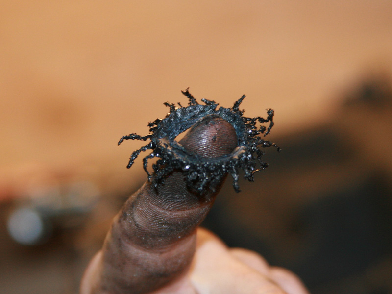

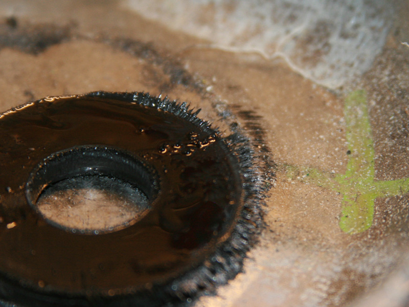

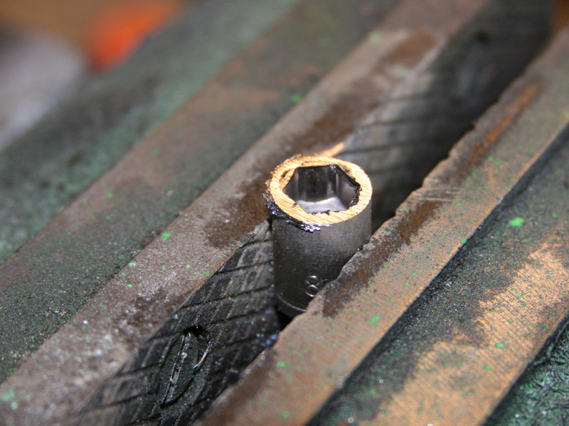

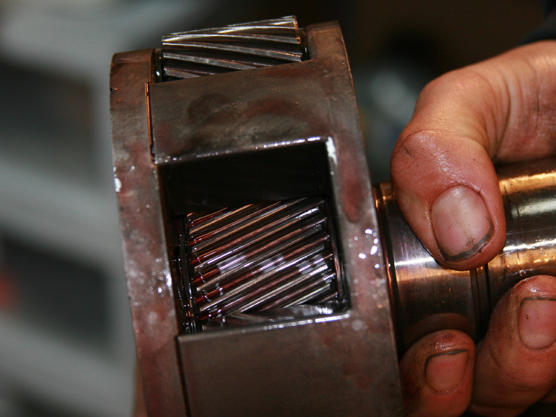

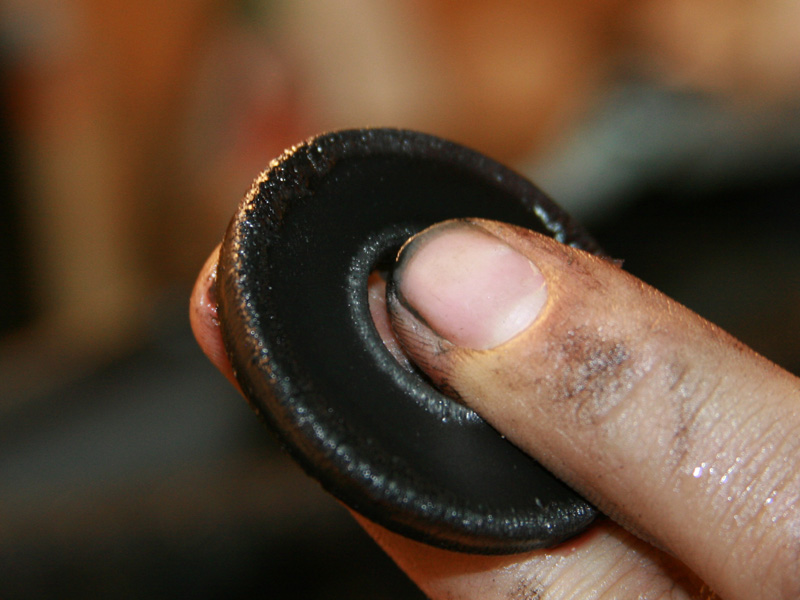

Quick up date, After cleaning all the bearings and running my finger nail across main shaft and front output shaft. Then very very slowly rotating the bearing by the inner cage feeling for any scaring, pitting and "bumpies". Then looking very closely at the gears syncros and chain. I'm 90% sure it just needs the seal kit, but having a veteran diesel mechanic come over and getting a second opinion on the condition of the parts tomorrow.
Just an update ordered the overhaul kit (part # TRS-TSK231J) from drivetrain.com, waiting on parts then ill post more pictures as I replace the seals in the t case then I will open up the transmission and will take more pictures and post them. More pictures is better right?
Well put the transfer case back together, but instead of taking editing and posting a lot pictures I made 4 videos about it, after a test drive the transmission feels great, funny how what started as a question about the transmission slipping turned into a transfer case service. Any way thank you all for your help, hope you enjoy my videos (pg 13). And happy 2011
