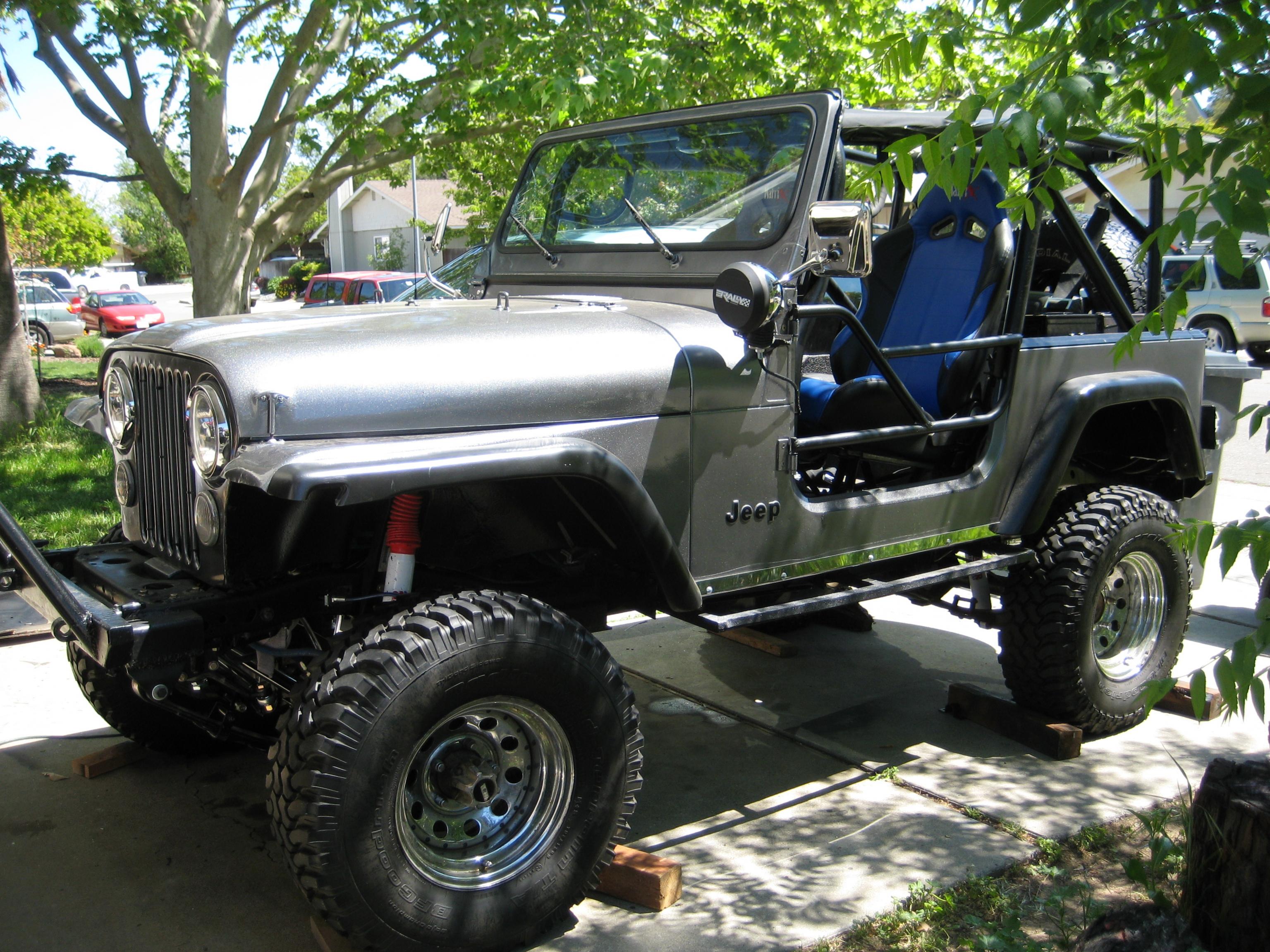

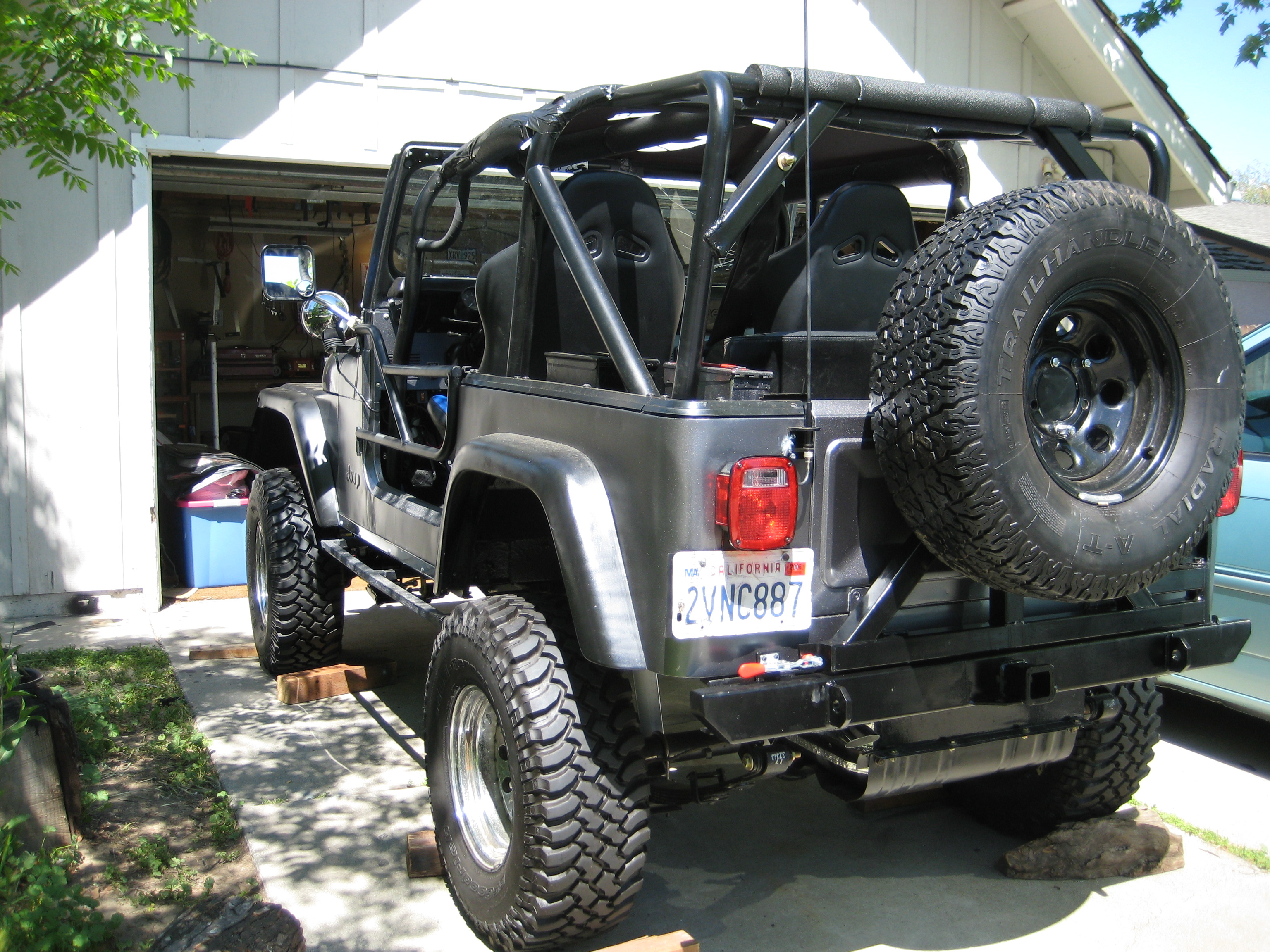

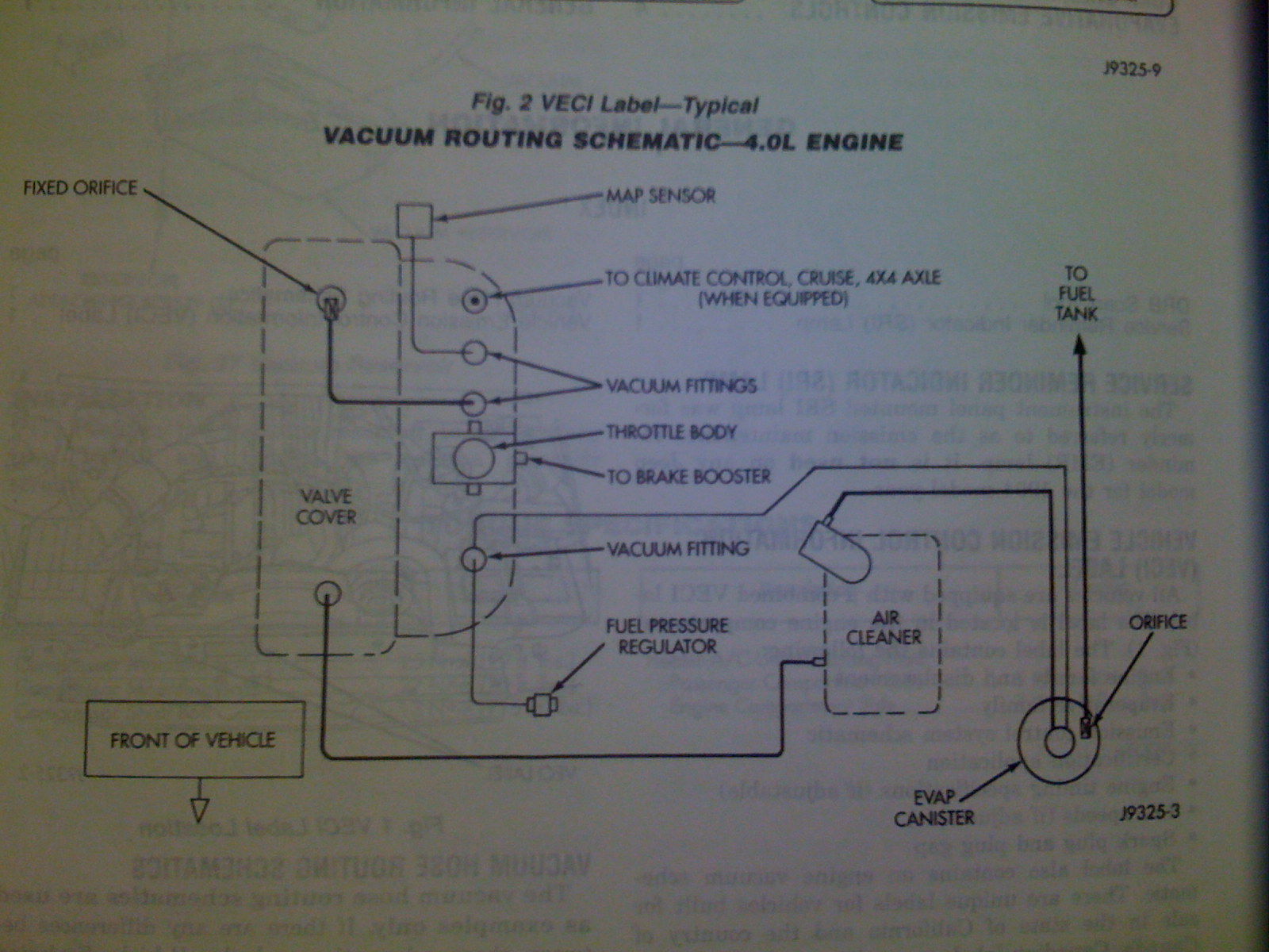

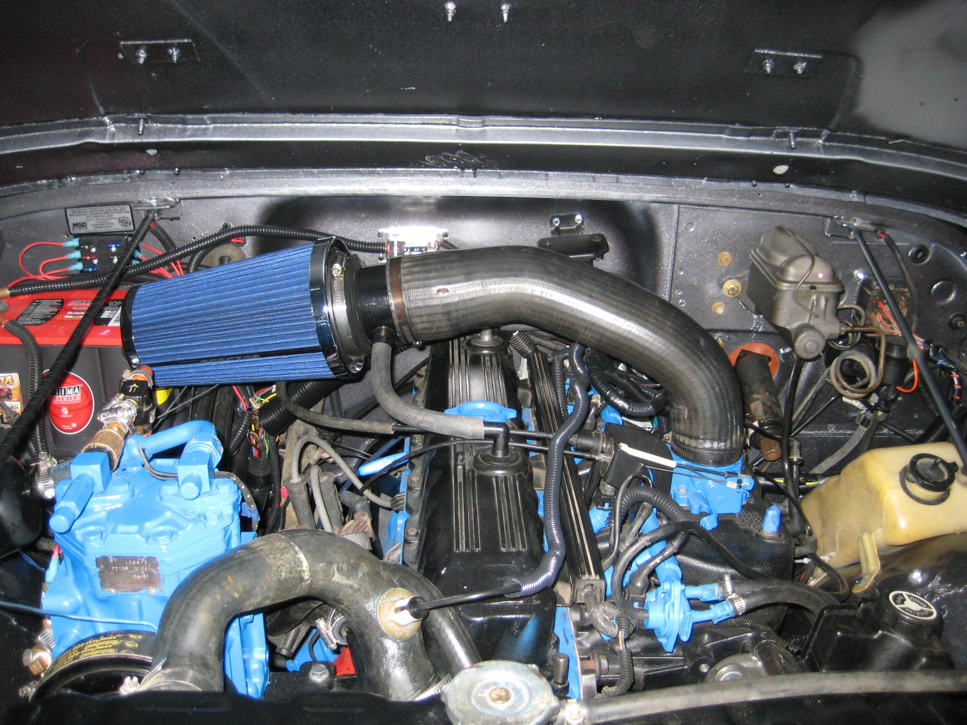

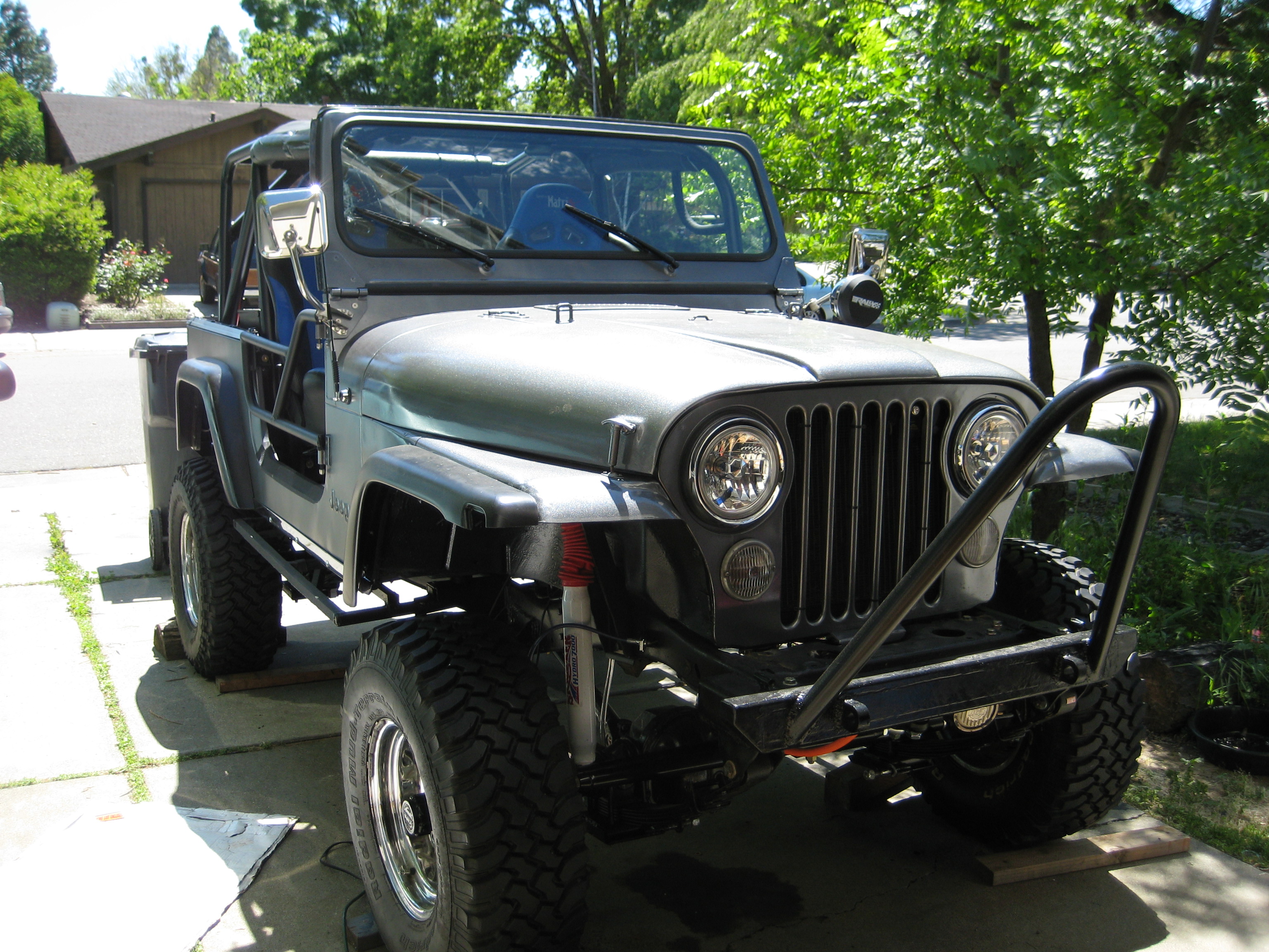

I'm almost done with the frame-off buildup/restoration of my 1984 CJ7. All I have left is the vacuum routing and the power steering lines. I'm waiting for a fitting in the mail for the steering lines, but I can't for the life of me find a 1994 vacuum diagram for a 4.0 Can anyone help me out? Once the Jeep is running I plan to make a complete writeup...I included some pictures to motivate you guys to help me get this 3-year project back on the trails! Thanks a bunch,

Would this help?

It's that simple? Wow, I remember how much of a PITA the 258 was when i had to re-do the vacuum lines. All I need now is the fitting for the power steering lines...c'mon UPS!
yep, a 1994 fuel injected 4.0 (it's really a 4.6l stroker but the wiring and vacuum lines should all be the same). The CJ had a 258 before the tear-down...
