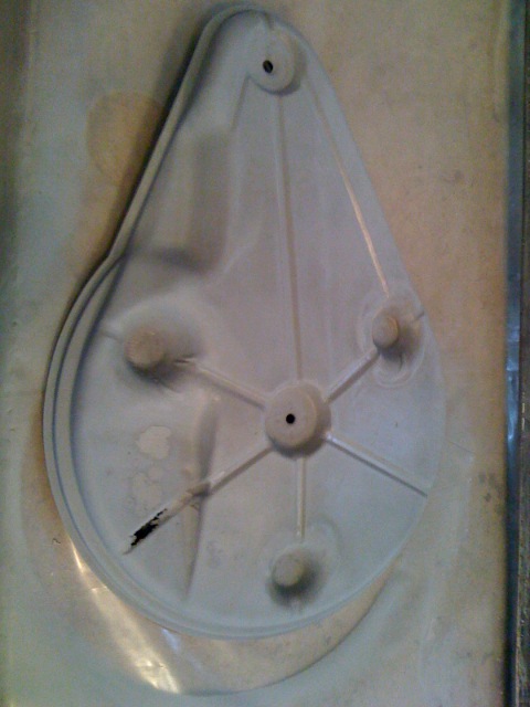

If you will dedicate your self to follow every instruction..then POR15 has the products which will allow you to preserve the one on hand. They market a small sized kit with everything necessary including a little patch of F/G which will cover your need very well.
I've seen the product in some of the Jeep mags but never looked very closely. Will def take a look. Thanks for your input.

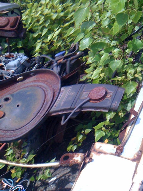

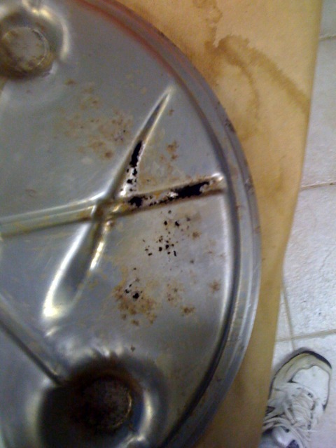

So the weld shop said no way. They said 3 hours minimum, but said the metal was too thin and they did not want to take the responsibility.
So, I did it the old fashioned way...

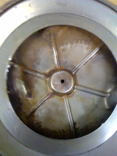

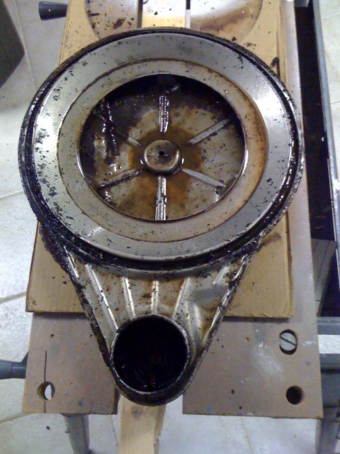

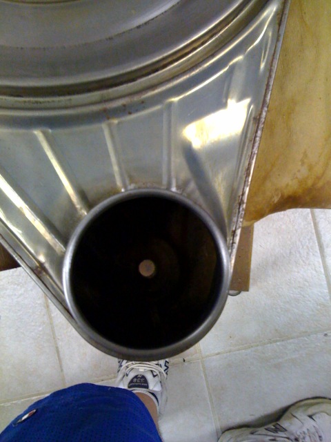

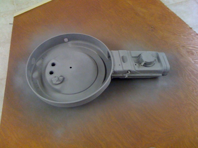

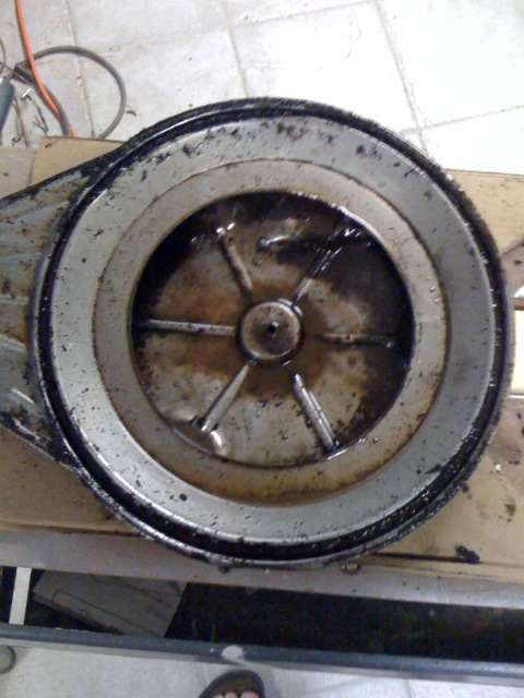

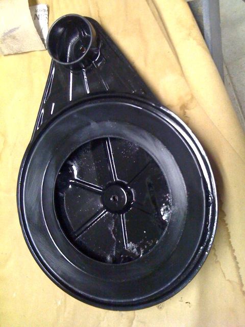

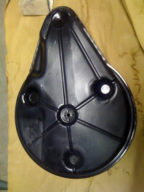

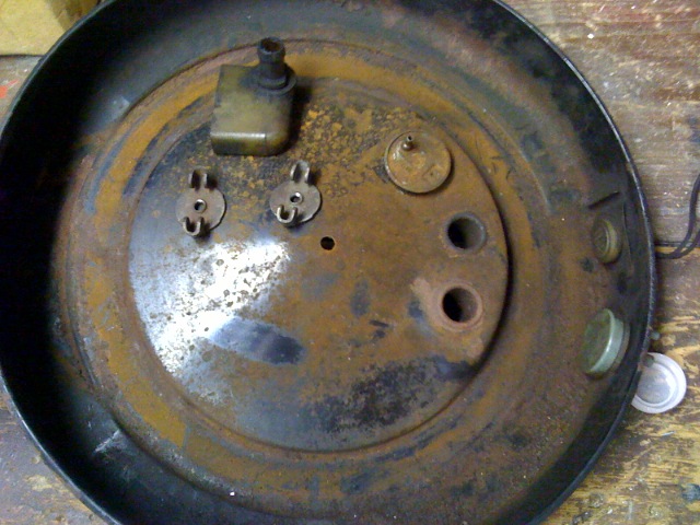

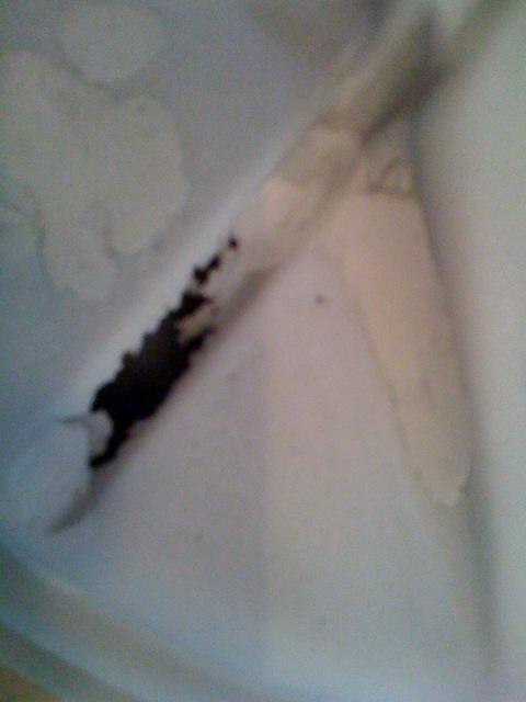

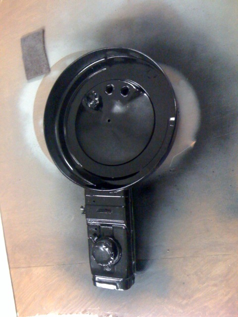

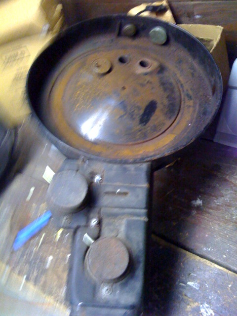

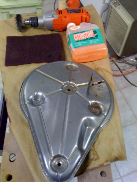

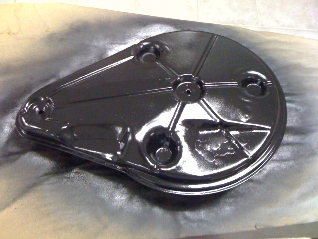

I blasted the inside of the cover with about 25lbs of sand to get all the rust flakes out. I filled the holes with JD Weld putty and sanded them down.
I then primed, sanded, and painted using a black engine paint. In the end, it turned out decent. I probably could do a better job the second go around, but it all worked out.
Here are some pics. I'll post pics of her after I give her a bath and detail tomorrow.

Messed up the order but here are some more...

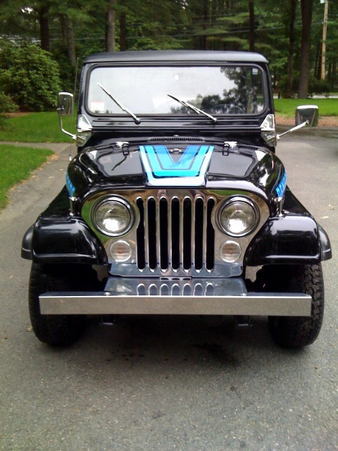

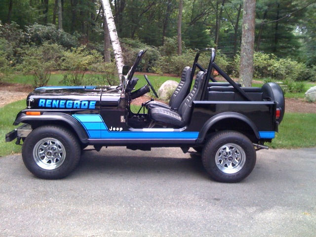

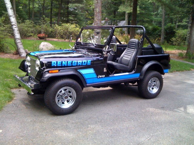

Started to rain before I could get a coat of wax on but here she is today after a bath and lambskin wipe down.
Here she is topless after a coat of wax.
