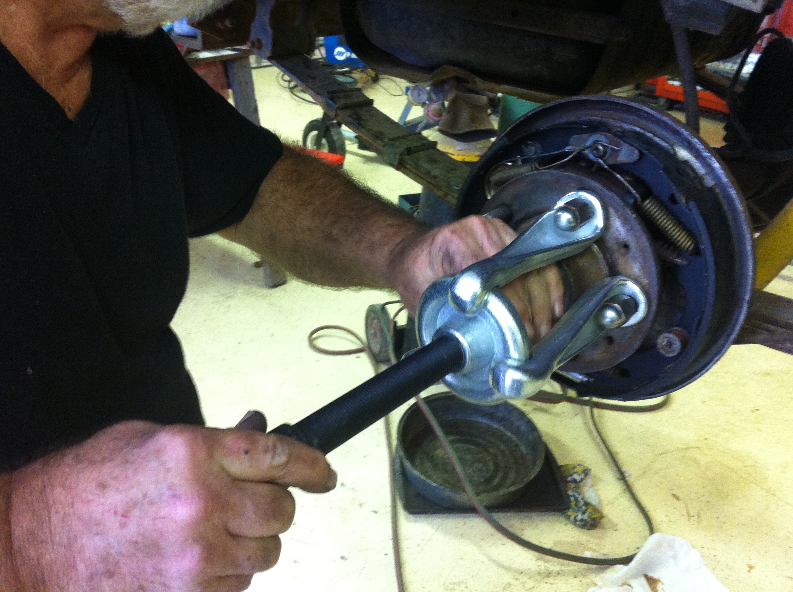

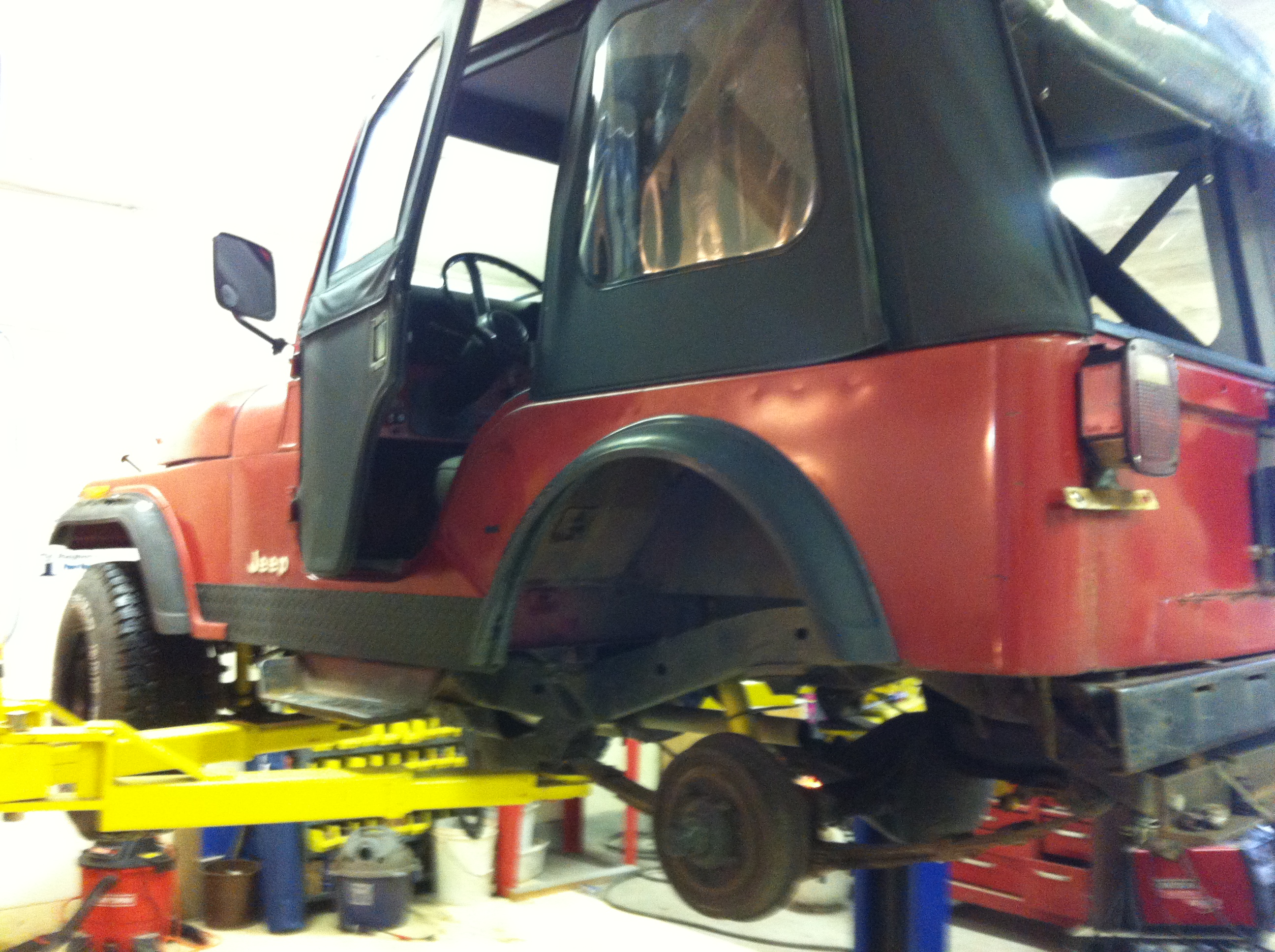

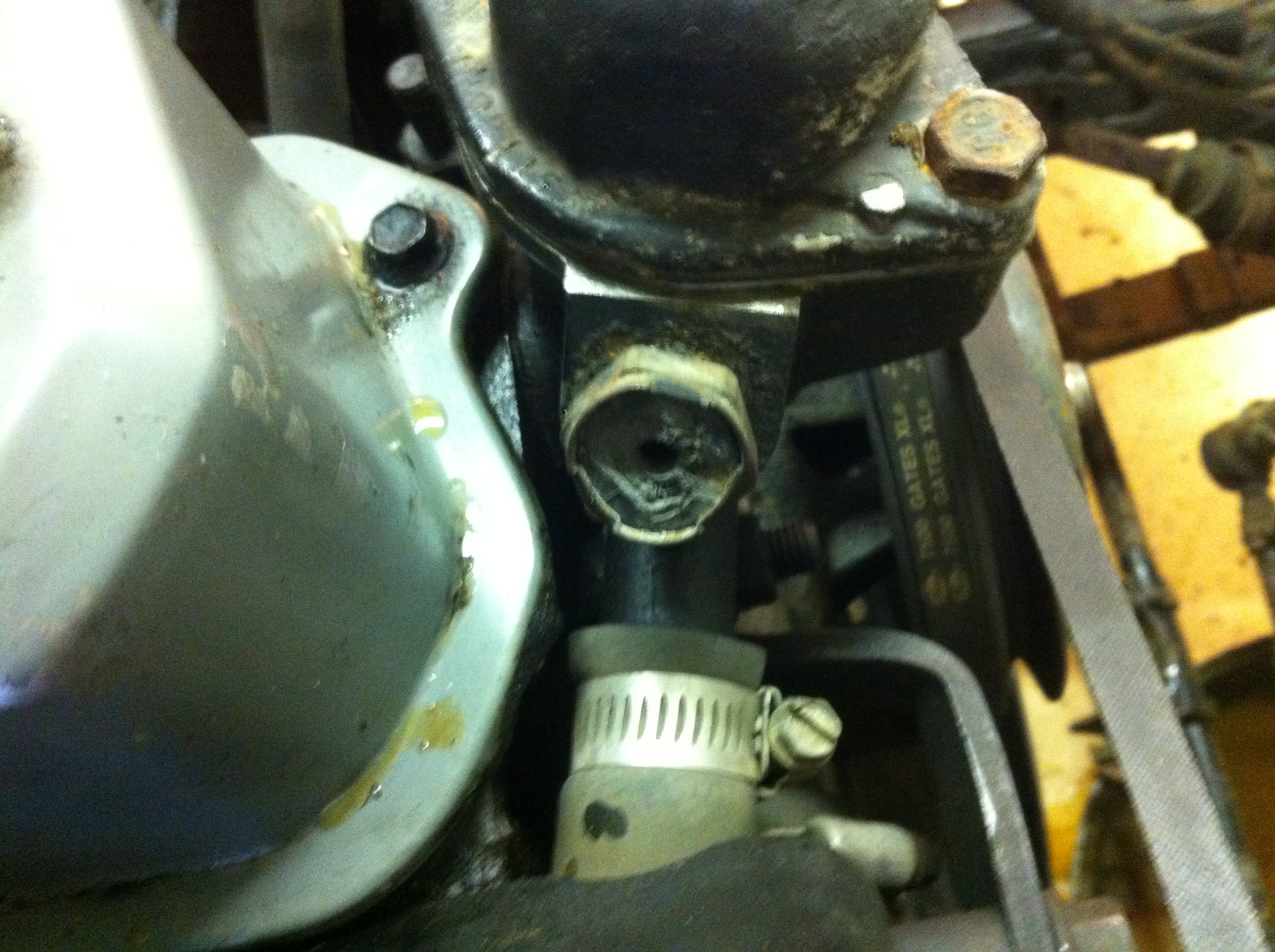

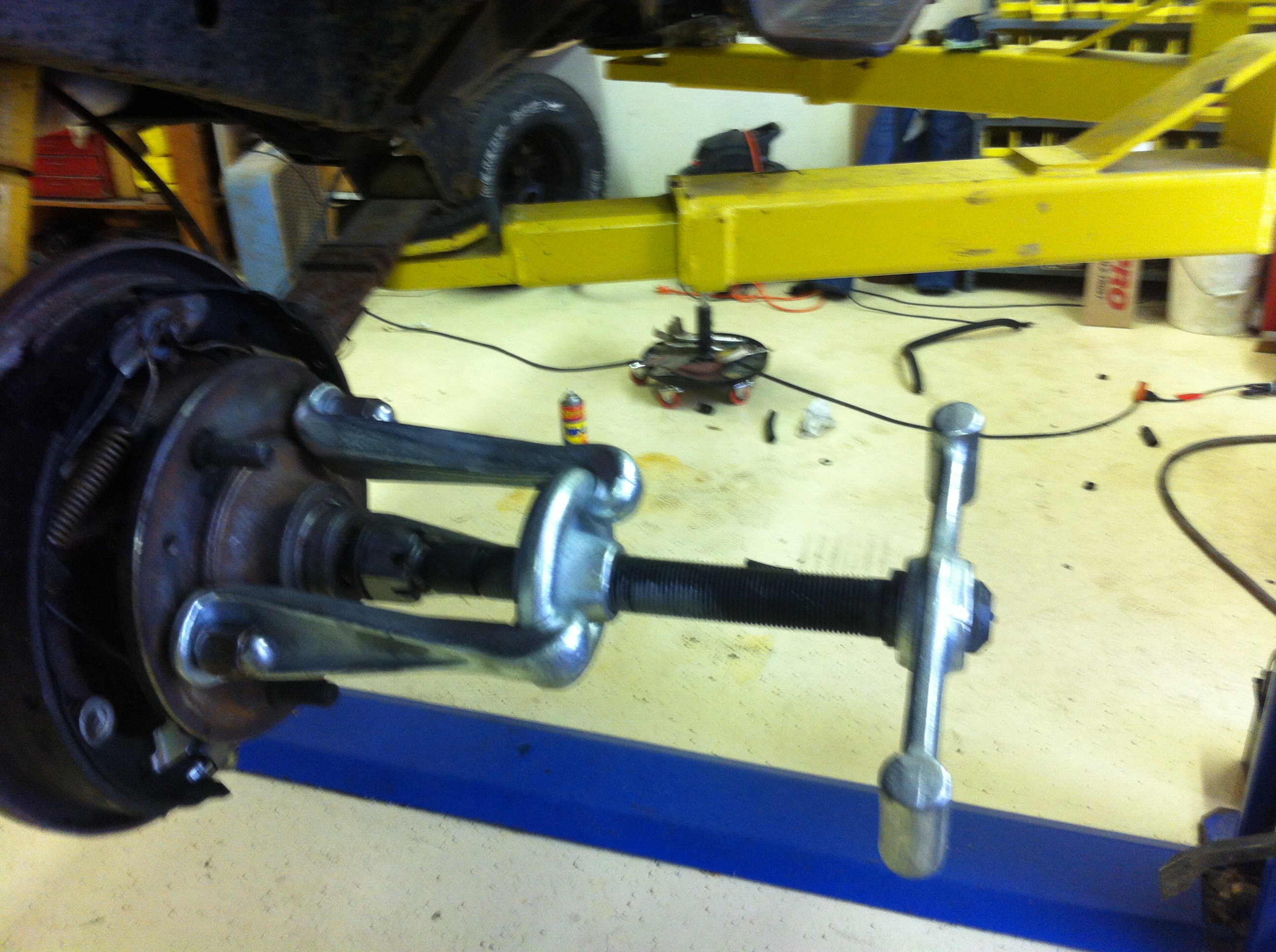

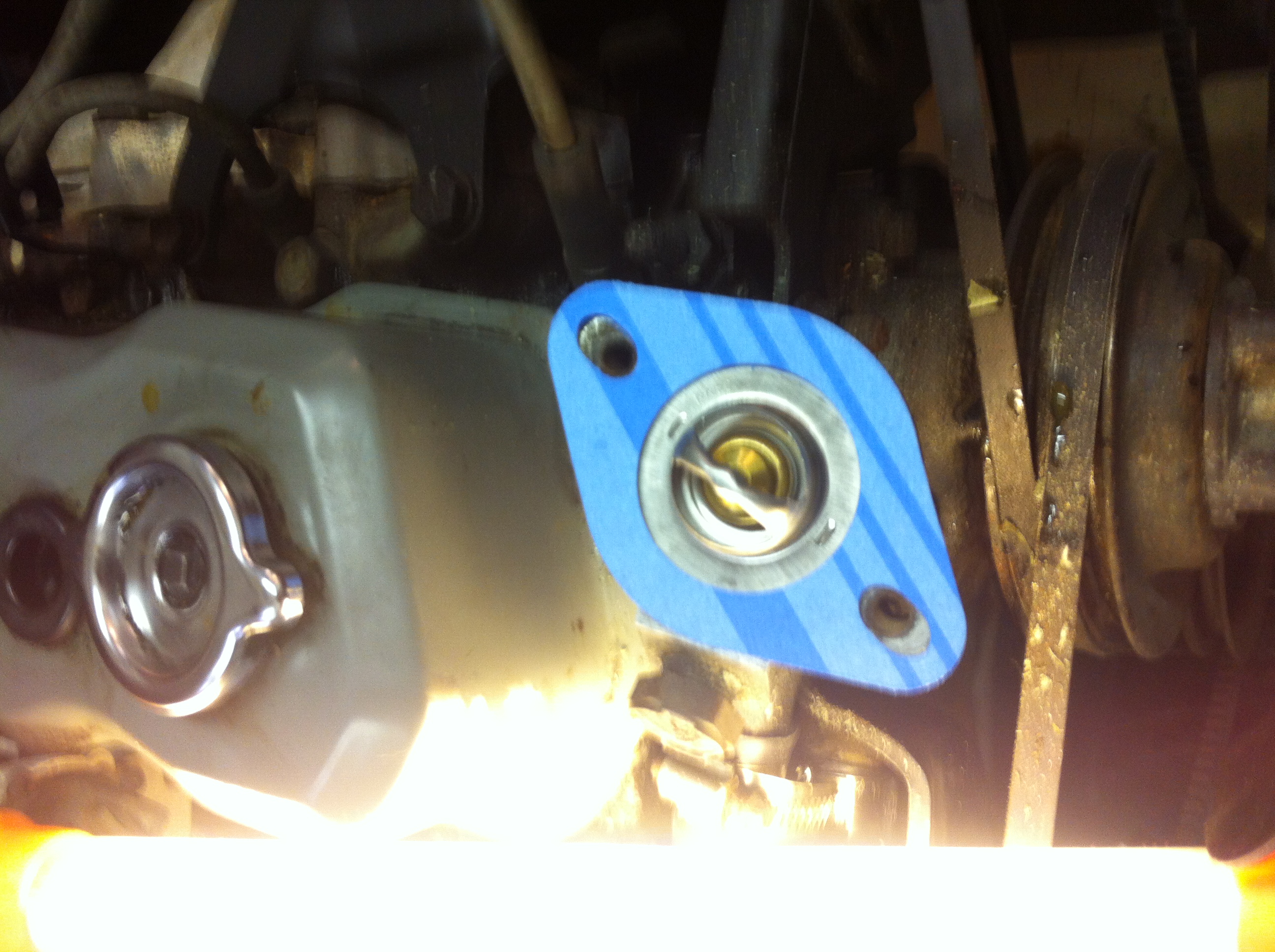

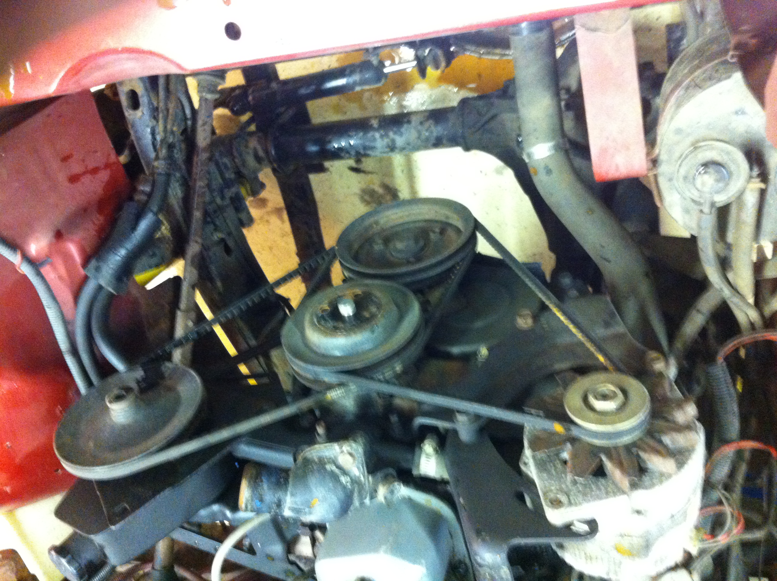

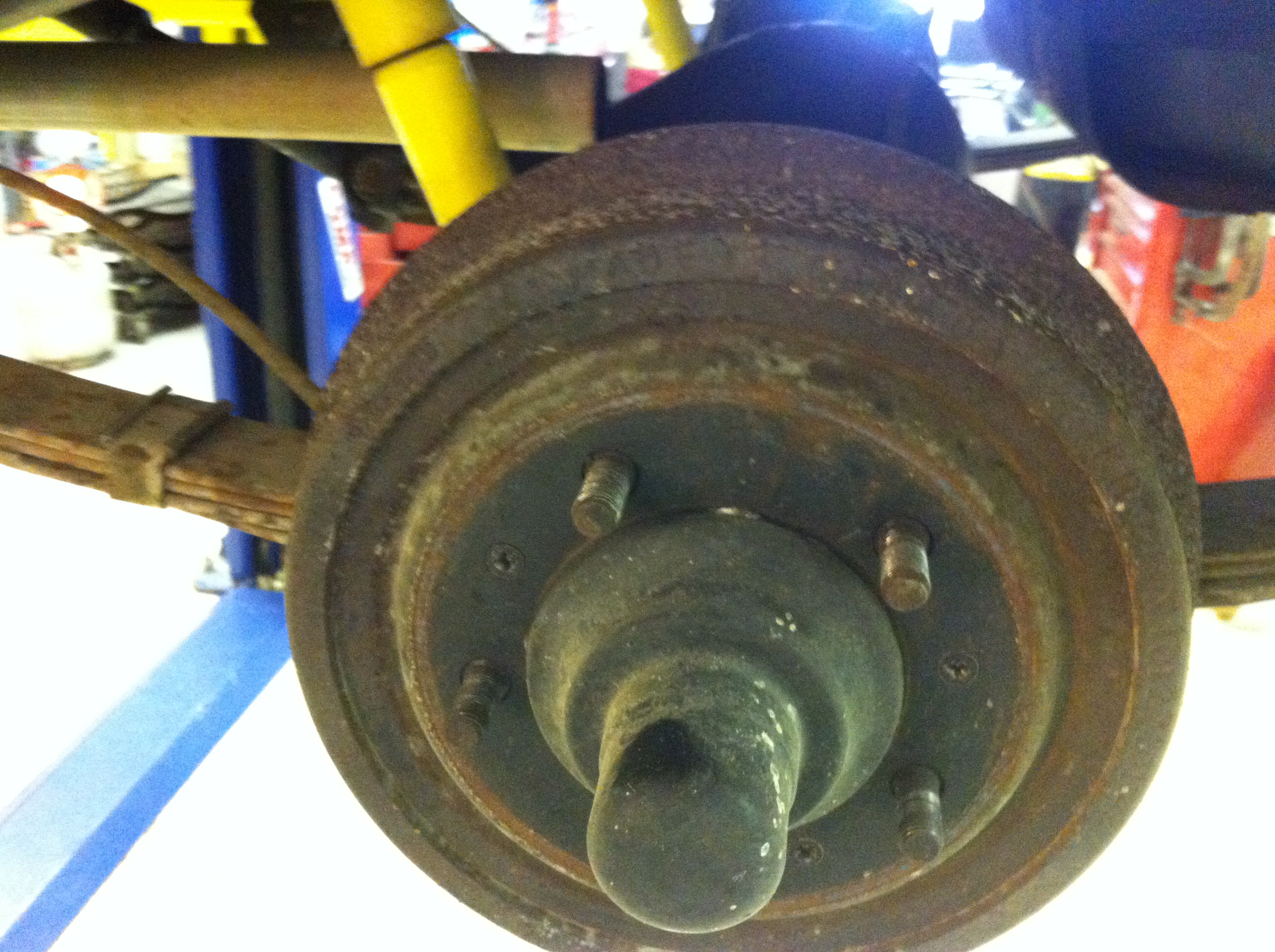

the start of tearing up and out. the brake job has started and stopped until we replace the rear hub seal. belts and hoses for radiator removed. to do this had to remove alternator. Radiator on way to shop to be boiled out ,looks to be in ok shape. one radiator hose and one heater hose change sizes from one end to the other. Allof this is a learning experience for me. I am having fun

You probably already know this, but when you do your rear hub, there is three phillips head screws holding your drums on, and a dust cap over the end of the axle shaft and hub nut. Take off the drum and dust cap, and loosen the axle nut, but leave the nut on the shaft to prevent the hub from flying across the room when it breaks free with the puller. There is a wood driff key between the hub and shaft, don't loose it.

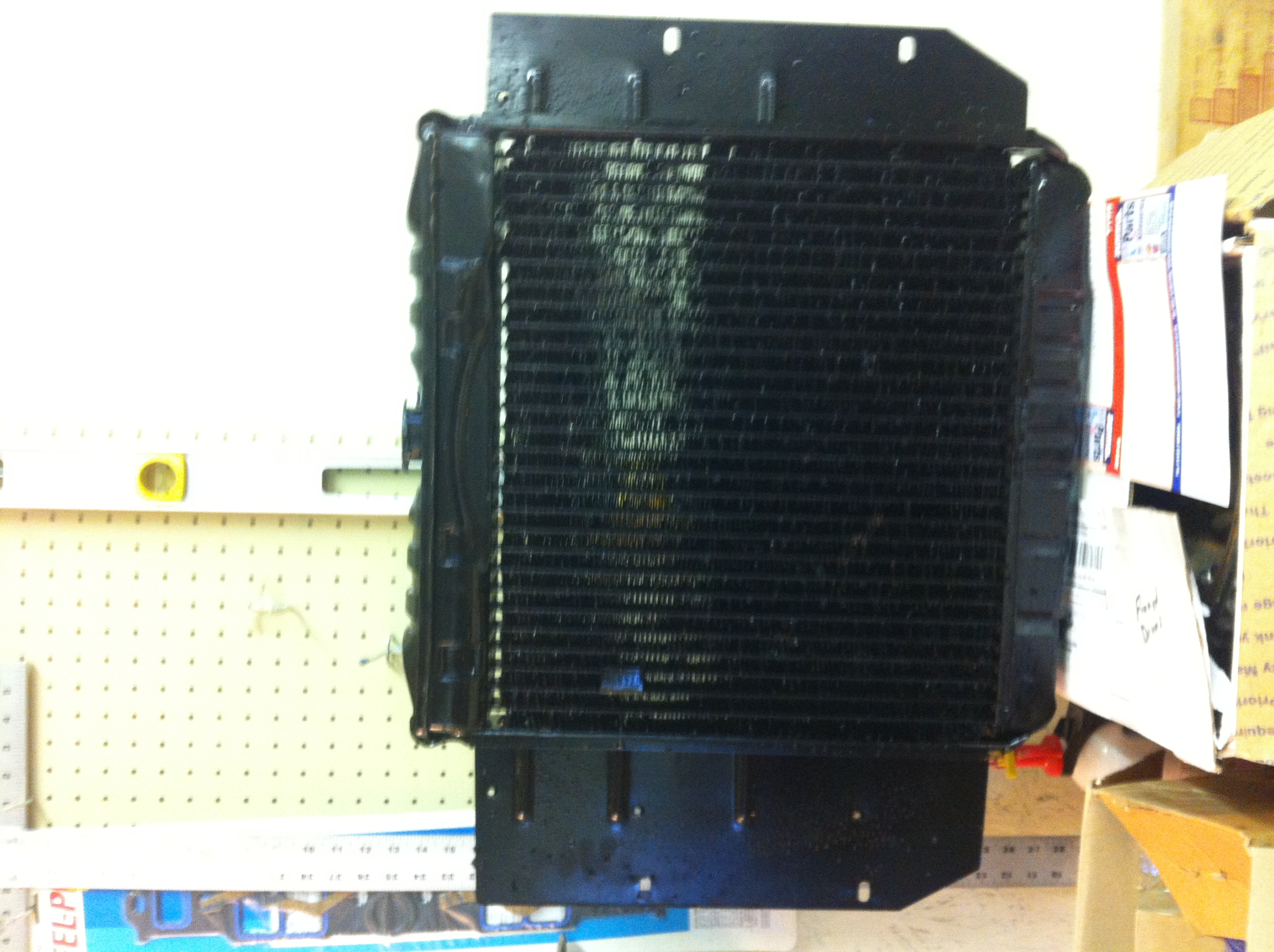

really getting going Radiator was cored and painted

doing lot of preventative maintence, all new hoses, belts, and brakes. where we ride is far from anything with no cell service. I have a lot more respect for mechanics and their prices after doing this little bit. to replace the heater hoses you have to remove the alternator completely.I dont know how anybody does this with a v8 engine.Sunday will finish brakes and go after vaccum problem,
