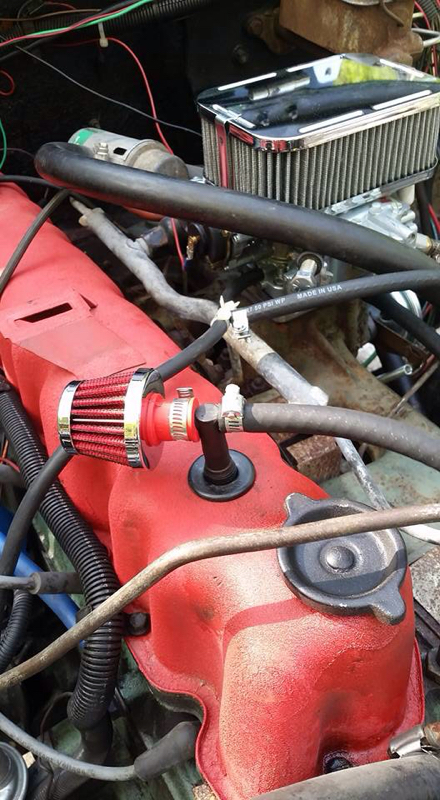

do you have a hose going to your vacumn advance can on your distributer coming from your carb or manifold? The lack of vacumn advance can cause bucking and backfiring while driving.
was that hose hooked to the pcv sucking air? (pulling vac). As I understand it, the pcv valve sucks unburnt fuel mixture back into the carb to be reburnt. so it sounds as if you are running rich and igniting unburnt fuel through your exhaust (back fire). not sure why the filter stopped it unless maybe the more air being sucked in by the filter diluted the mixture to the point it wouldn't ignite. This is a guess and not a sure cure, but I would try buying a new pcv and adjust the carb leaner. Their shouldn't be a filter on the pvc, it has to pull vac from the engine not the atmosphere.
hmmm wouldn't a backfire through the carb be a lean condition? I think the OP mentioned his spark plugs were white. While out the tailpipe be indicative of a rich condition? Not to sound a smart@ss I've been working on my Jimmy too and my mind is a little clogged, better break out the Draino.
I always thought backfire through carb was rich, I could be wrong. white plugs do indicate lean though! being there in person would be a lot easier to diagnose than the intro net. Can the OP give a update? When I got my jeep, It ran decent but would backfire, buck and stumble at times, turned out cam was gone. Another time I had issues with backfire, it was cured by resetting the timing and carb adjustment.
