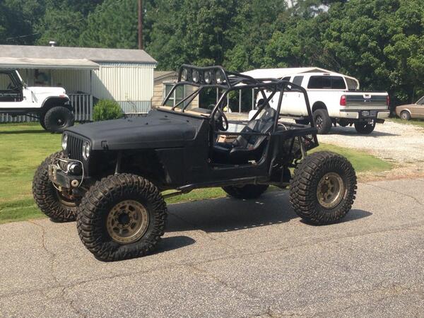

New sending unit. Unfortunately I had to sell my Jeep, needed something a little more fuel efficient for college. I bought an 04 TDI Golf. :roll: Thankfully my roommate bought a new toy.
I'll be back soon gentlemen.
