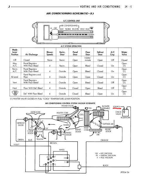

All the air, both a/c and heat, in the old '96 XJ is vented up at the windshield now no matter what position the control levers are in. I assume its b/c of a cable or something that's come unattached. What's the most likely cause of such a disastrous occurrence and how much trouble is it to get at?

I think I can help you with one question. to the best of my knowledge the vent doors in your dash are controled by vacumm, you may want to check in your engine compartment and trace any vacumm lines going into your firewall. I had a jeep onetime that the gasket around the blower fan was not installed at the factory right and over time let dust and debris in and clogged the heater core and made the air vent doors stick in place. be forewarned that taking the dash apart is a huge job.
I hope this helps.
Start with the Vac lines. Besides the line that goes to the Heat system if there is no another large leak that is stealing from the heat. Often the connection at the intake or the reservoir under the battery is an issue.
Besides looking you could start the engine then slowly spray WD40 in the vac lines listening for the idle to change. When it does you found a leak.

defrost, vent, floor is MODE selector. As mentioned vacuum operated and check vacuum first.
I underlined in red where to start
PS defrost is the default mode.

Thanks yall that's gotta be it. I was messing with my battery this winter and somehow broke the vac line that goes to the front air bladder in the bumper. My cruise stopped working so I thought it was only associated with that.
