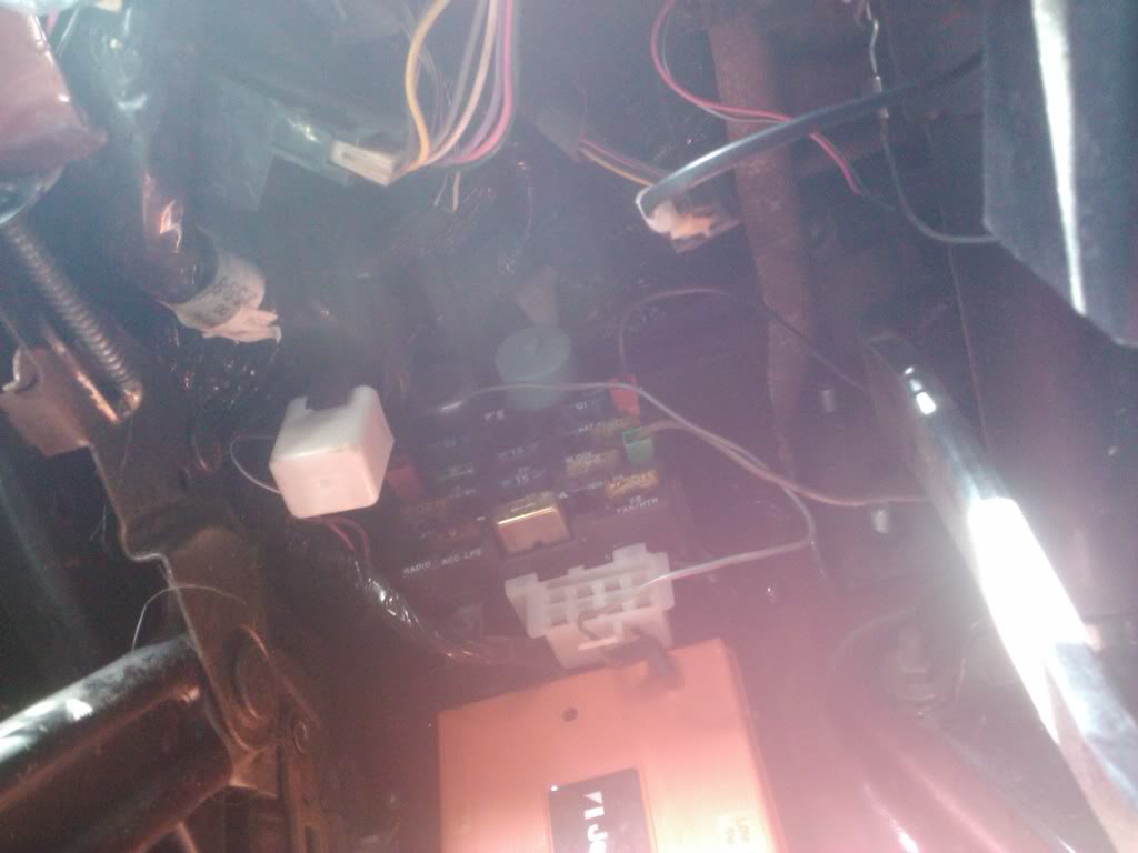

Turns out my Battery 12V is only getting 0.44V+ so I started tracing my wiring back. I found this little guy.
Can someone please explain where it belongs.
It's pink with two black/white wires beside it. (The pink is the Battery 12V+ )
Jeep YJ 91

Everything runs fine just my stereo isn't working. I got it professionally installed but when I was doing something with my dash it fell down. My head unit isn't turning on but I hooked up a multimeter and my main 12V is getting almost no power.

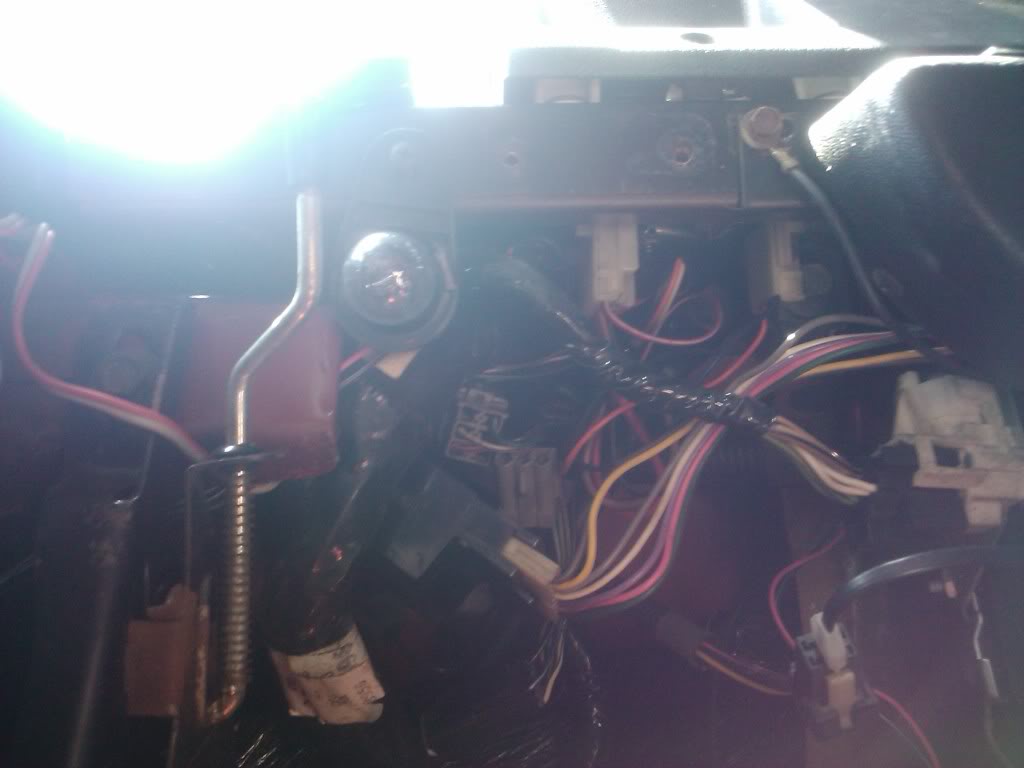

i didn't get your message till after i had already showered an am ready for bed. i was under the dash all afternoon though. look above your parking brake pawl area and there should be a mass of wiring harnesses. one of them had three wires like those sticking out of it when i was messing around and since yours all pulled out of splices, look for the other two red splices that are missing wires and a loose wire right near those two
I found a harness where I believe they go. But I was looking at the other side and noticed the same pink wire. I couldn't pull them apart so I just plugged the multimeter into it. It's giving me the same amount of current.
The adapter is from the wires coming from the rear of the jeep.
ok, i put it on the calendar to remind me to take a pic when i get home at 1500
I could be wrong but i think it's the fuel sending unit wire. The only wiring for the rear is for the lamps, fuel gauge and pump. If you follow that wire to the rear coming down from the driver rear tub past the roll bar you should see where it goes from there.
There's also a Pink circuit that feeds the door jamb switches.
What's the best way to run something through the fuse box?
With a spade connector on the end so it slips into the plug. Those little single plugs are for accessories. Mine is ac and a cb. The third one, I don't remember. I also don't know what that grey wire at the bottom of the fuse box is for, the one not plugged to anything
