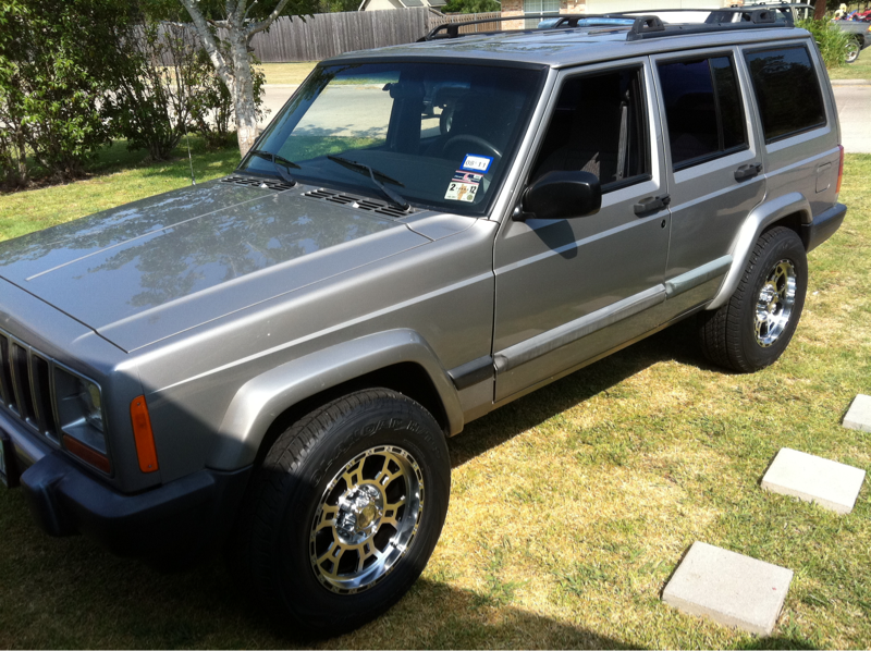

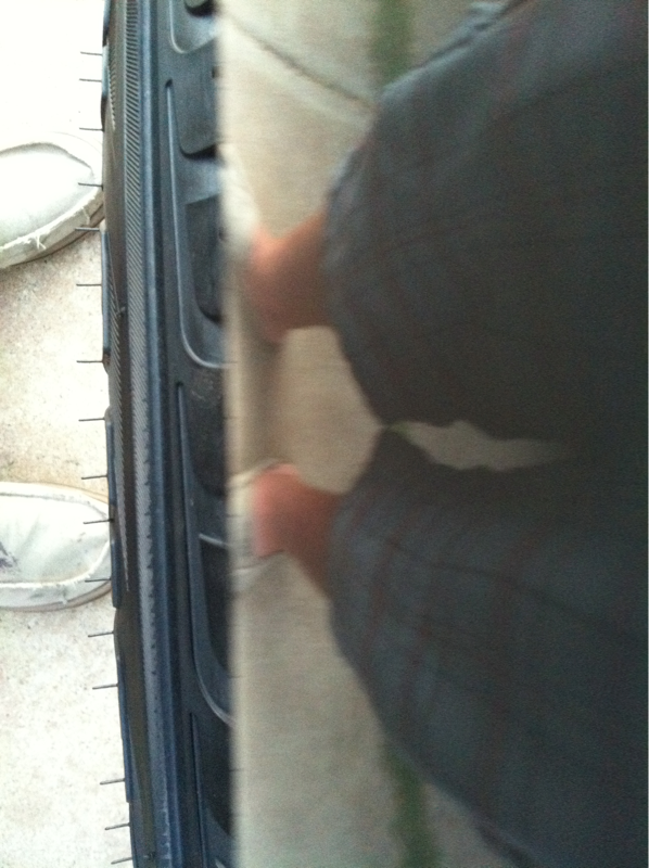

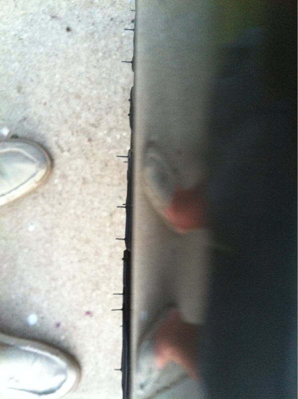

I have a 01 Cherokee sport, just put on my wheels and tires. It looks like the drivers side rear is tucked about 1/2 inch inward more than the rest of the wheels. is this normal? Or am I being a weirdo about it? All of the wheels are the same offset and I can't see where the real axle has shifted any.

Seems that the front spring eye on the passenger side rear has shifted. At Weever spring and axle now, and they are re arching the springs and replacing the bushings. Said they can re arch for 1.5 inches of lift and make my front coils too for $275 complete.... Not bad!
