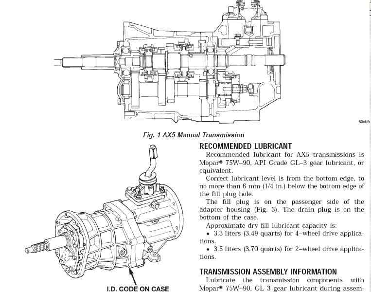

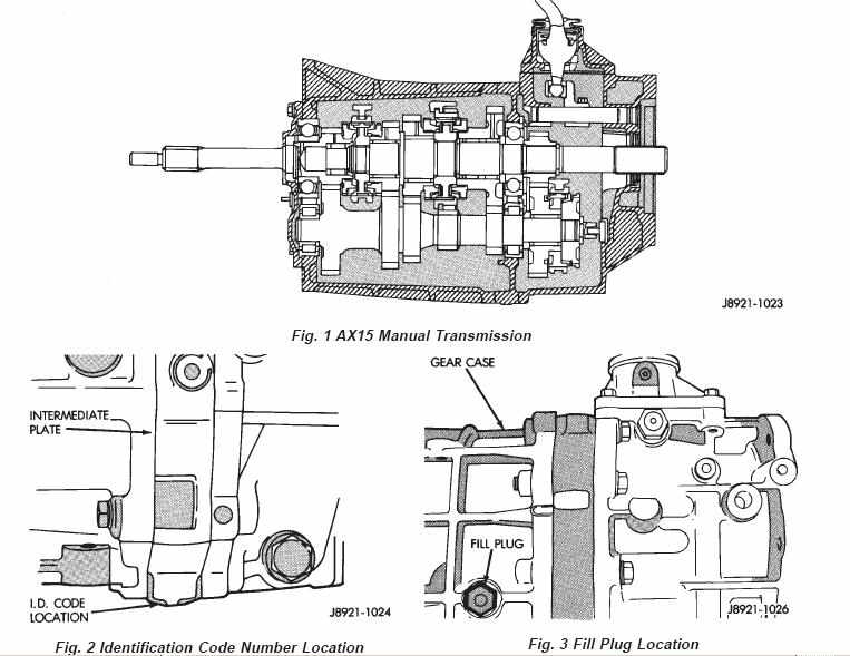

I checked this link and the transmission in my TJ doesnt look like any of them. Maybe there is a different model transmission in there from the factory? Really confused!

Good suggestion. I just checked my plate. Trans-DDQ, Engine-ERH. Geez. I checked this link (http://www.thegrecos.com/index.php?option=com_content&task=view&id=39&Itemid=49) and you would think I'de have an AX-15.....they coupled the AX5 on I6 models? So I paid extra for the Sahara and got the smaller trans. Now i'm even more confused....and a little pissed. I thought they were only used in the 4 cylinders. I guess I got a leftover?
I found this link ( http://www.stu-offroad.com/misc/fluids-1.htm) and it is exactly what I have, but it is referred to as an AX-15.
What gives??

AX5 is behind the 2.5L 4cyl, and the AX15 is behind the 4.2L and 4.0L 6cyl engines. Only exception I know of is the AX15 behind the 2.5L in Dodge Dakota trucks.
You should have an AX15.

I contacted a dealer and also daimler-chrysler about the build sheet for my TJ. The general consensus it that the 'DDQ' build code is for a '5-speed manual transmission', not a particular model of 5 speed. After viewing pics of the fill plug on both I've concluded that it must be an AX-15. The fill on the AX5 is a round extrusion from the drivers side case, and the fill on the AX-15 is an oblong extrusion that kind of looks like a small pad. Without a doubt though, the info leads to confusion as to where the drain and fills are on these units. Thanks all!
