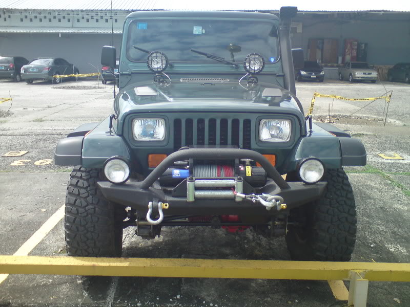

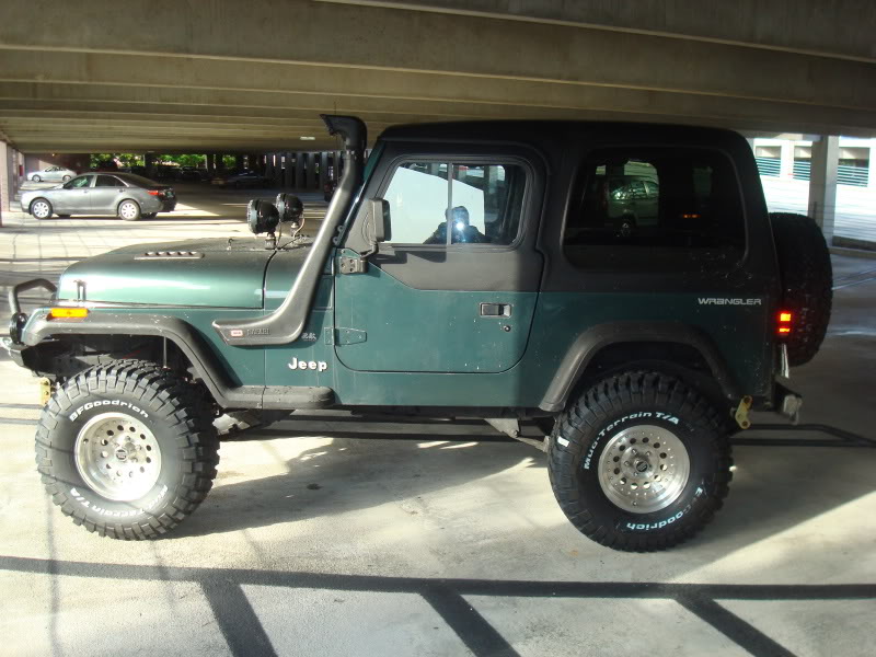

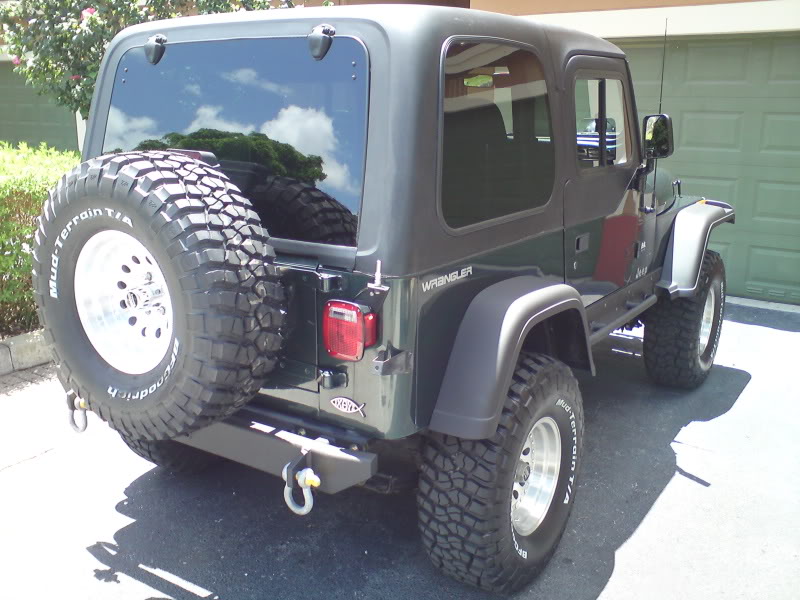

Mine's a YJ, but here's more or less (you are planning less lift) how you would look from different angles (i have 4" of lift, Outlaw II 15X8 wheels, and 33X12.50 BFG MT KM2's...)
