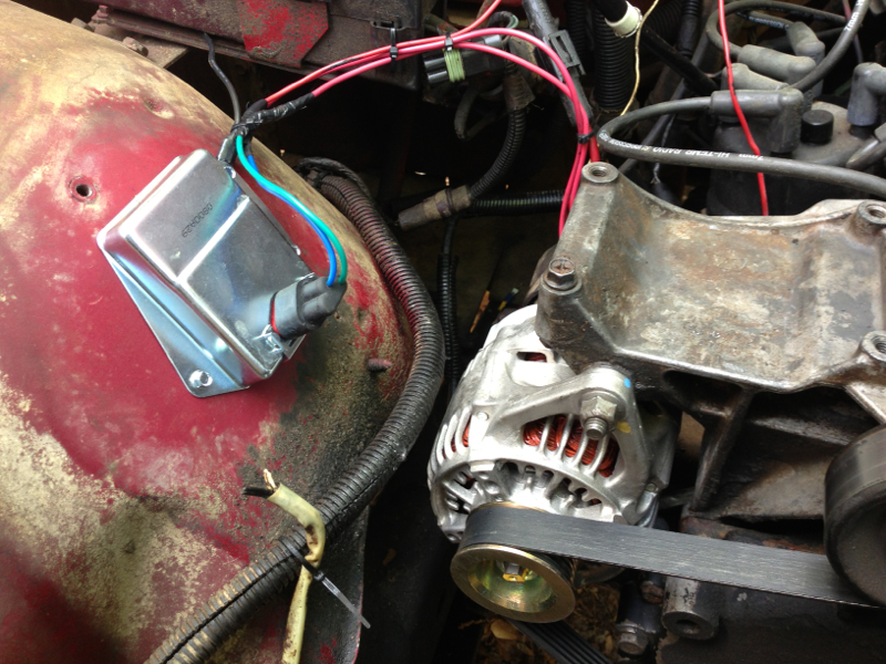

Installed voltage regulator because factory computer pooped out.

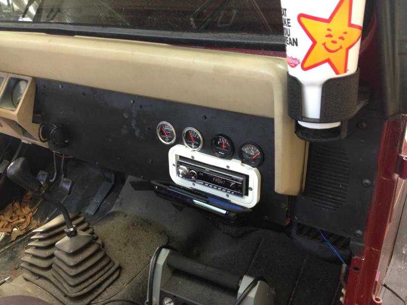

Finished dash and put splash cover on radio

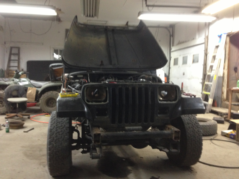

finally got around to straightening my front frame horns on my jeep. They were bent about an 1 1/2" to 2" to the drivers side. Its not totally straight, still about a half inch off but much better.. woo hoo

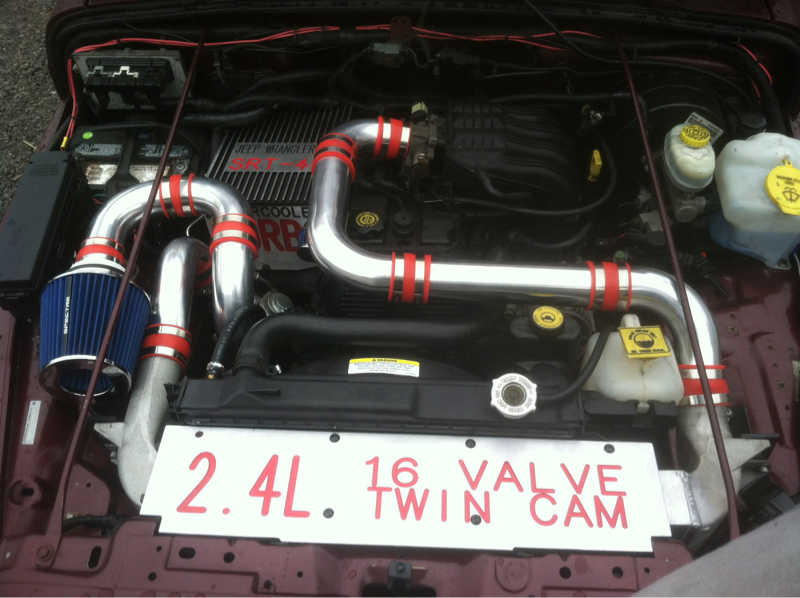

Cool! How about a picture of the engine/turbo?
It took a lot of work, I run a large CNC machine shop so I did all the machine work myself, traded an old wood burner I had for the turbo, manifold, waste gate and blowoff valve. All together I think I have under $250 in it, dynoed at 208 hp at 6 psi boost. Still running the stock injectors and 9.5:1 compression so my low end didn't change , starts pulling pretty good around 2200rpm and I'm getting around 23 mpg..
This was an earlier picture when I was in the test stage but you can at least see the the neon srt turbo

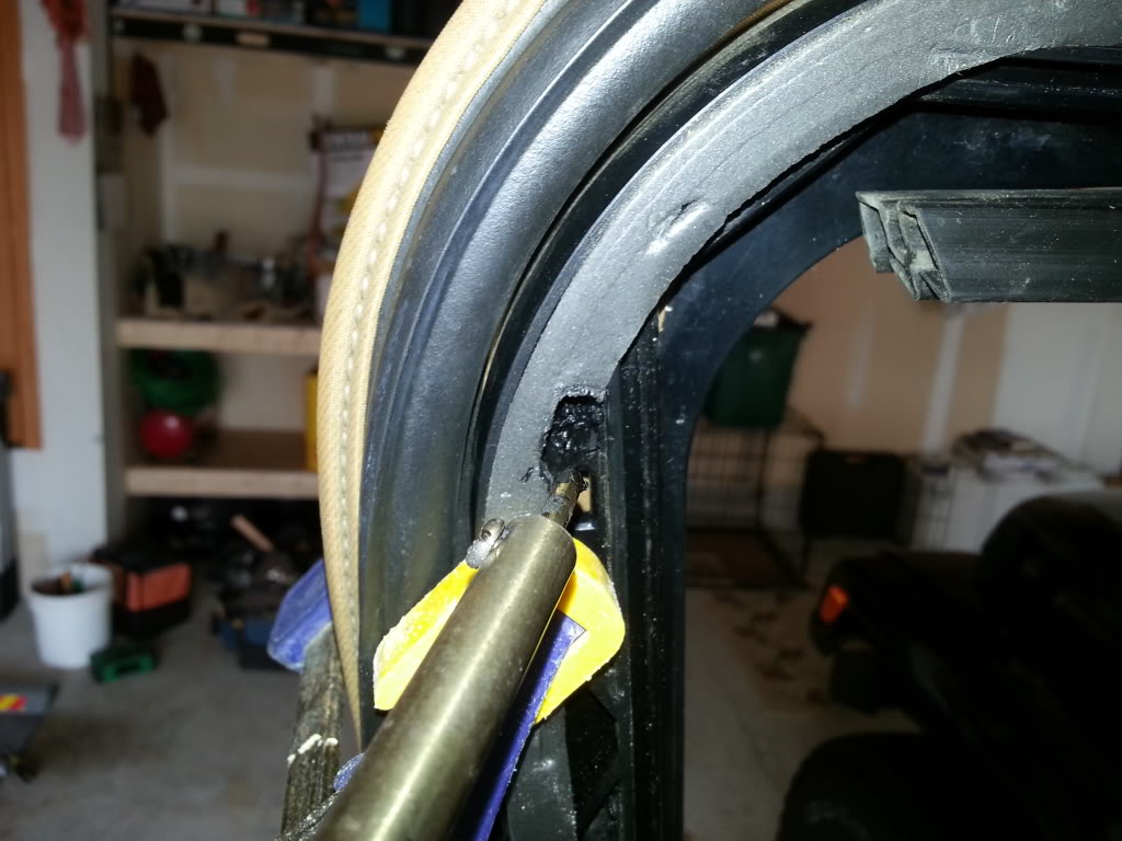

topless today then when I got home I decided to fix my upper slider window.
The outside trim piece had broken clips so it would flop in the wind...
I took a solder iron and melted it back together

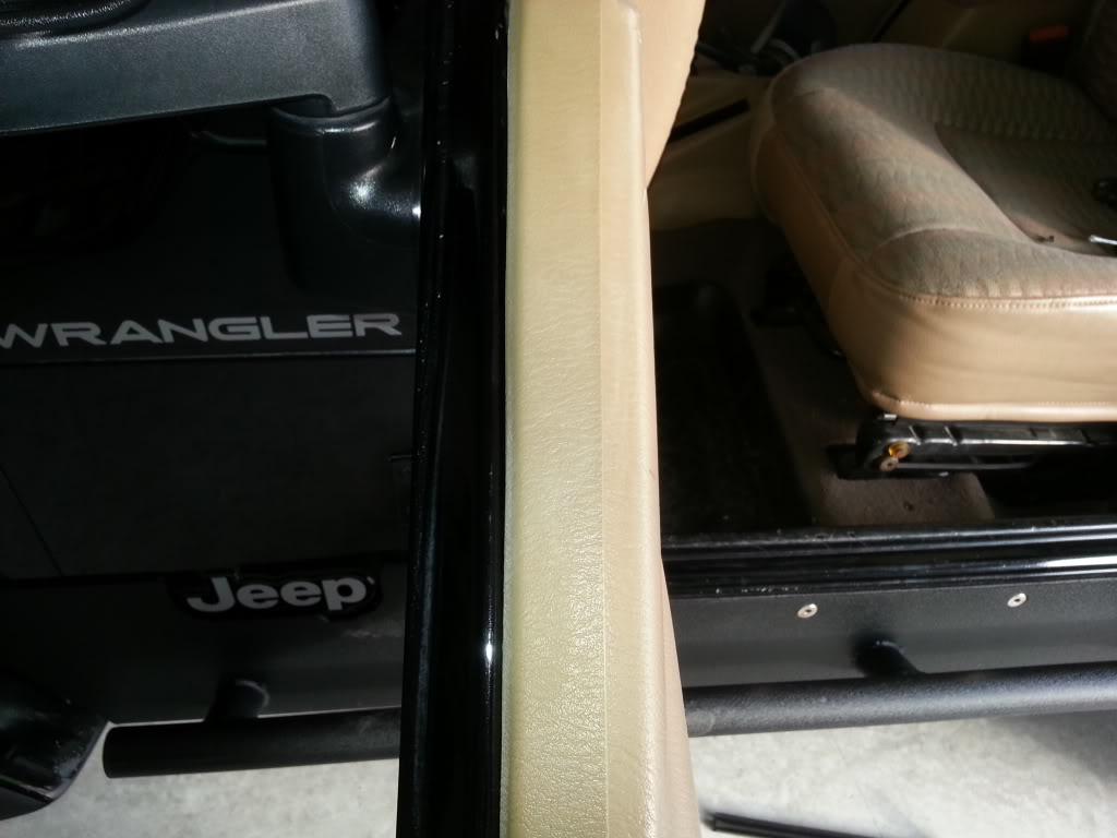

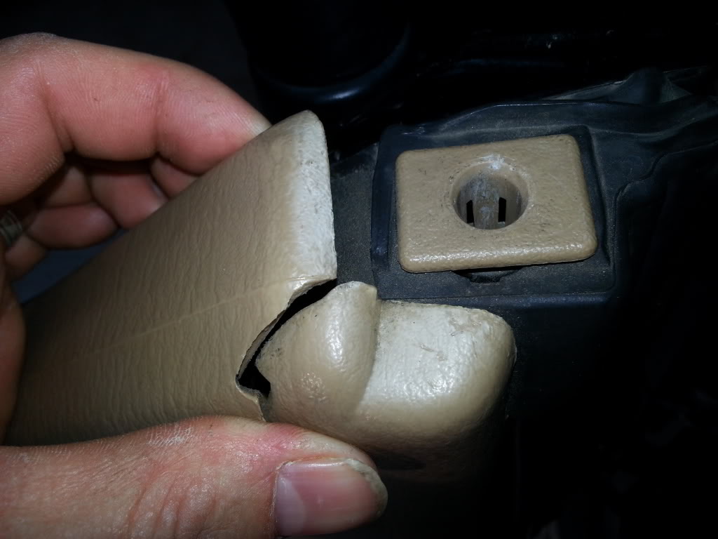

Then I took a heat gun to the top of my door panel, it was starting to turn white like the front edge here
After a few mins of heat.

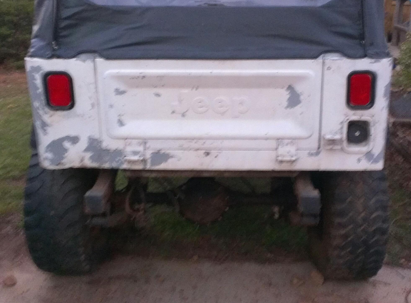

I installed new style tail lights. Next is finish my rear crossmember and replace my body bushings then get it painted.
