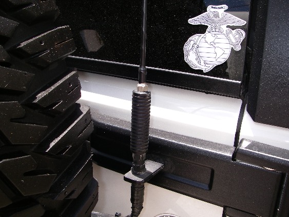

I'm very happy with this mount:
http://www.jeepz.com/forum/product-reviews/24437-arizona-rocky-road-wrangler-cb-antenna-mount.html
I use a 3 foot hard antenna with it (and take it off when I'm not offroading). I've currently got a standard CB with a cigarette plug attached, but I plan on getting one with the radio integrated into the handset.
I tend to think that you don't need alot of range, just something that stays out of the way and doesn't beat against your top.

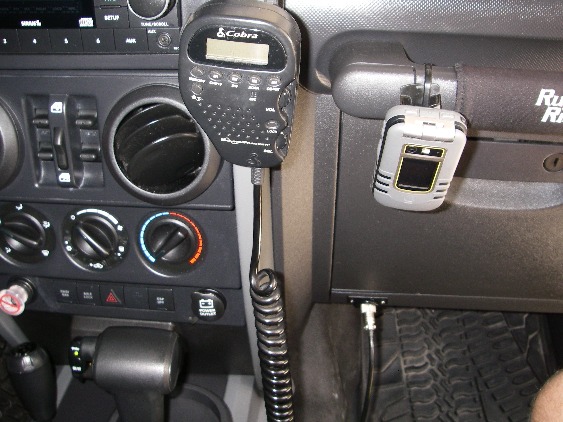

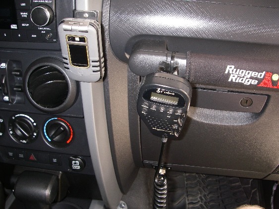

I have and love the Cobra 75 WX ST and Liberty Antenna with Custom Mount.
