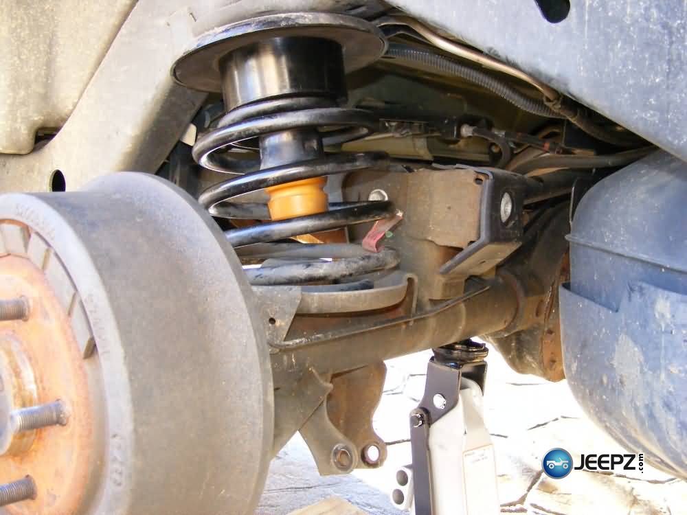

Does your lift look like this:

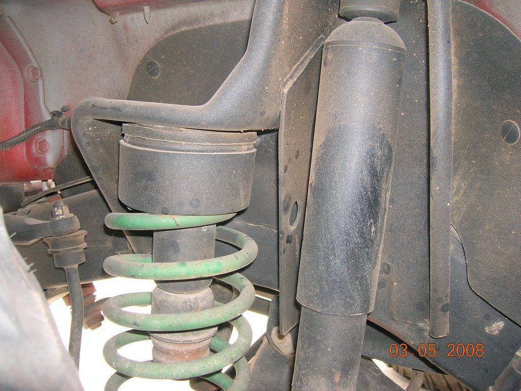

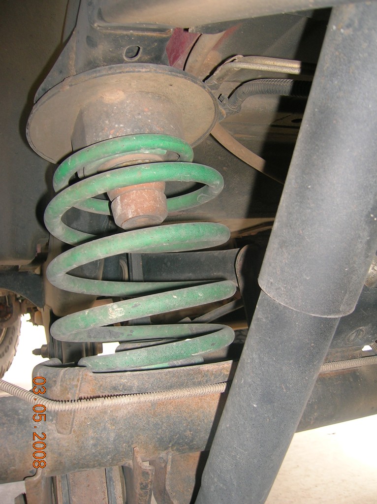

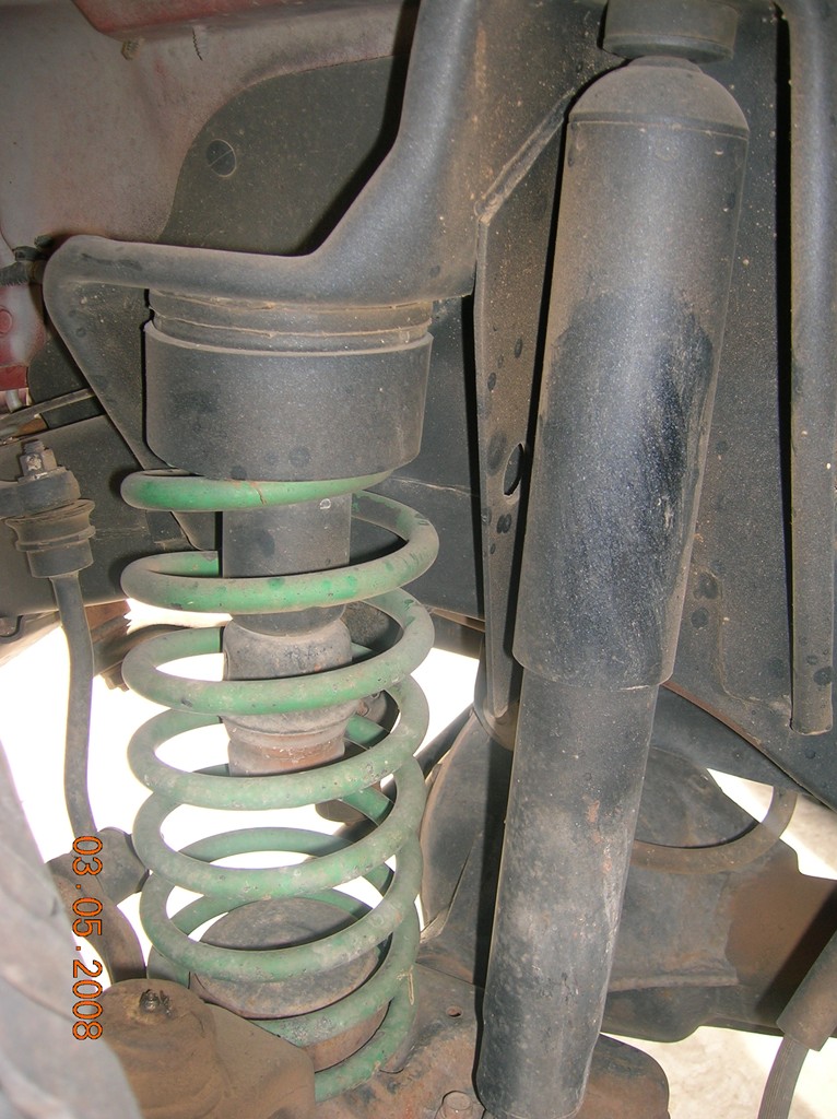

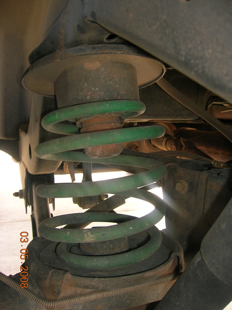

Here's what my lift looks like
And I'm not real sure about the green shocks, i think someone told me once they've never even heard of green shocks. Yeah, with the lift i've got it just feels like the tires are too big, but I would like to be able to run them on trails and such, eventually cause i sure can't now.

I'll defer to other people, but that looks like a 2" spacer with stock length shocks to me. My kit came with the spacers (black pucks at the top of each spring) as well as shocks that are 2" longer than the original ones.

I'll agree, looks like you have the 2" budget boost lift with stock shocks.
